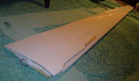

Found 1 photo in my archives...
Well, this is the result !
The failure come from the Wing Joiner tube not glued properly on some machines.
Seringe, epoxy and that will fix the problem !

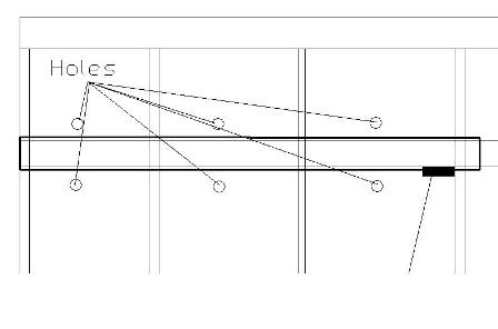

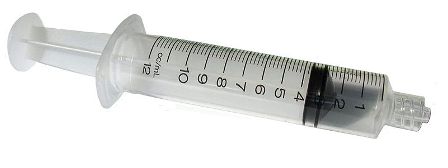

« Reply #4 on: January 21, 2008, 14:23:23 PM »
Hi Chris,
Well, just use the medical ones, they are perfect.
Take one with the nozzle big enough for the epoxy to flow quiet easily (2 to 3mm diameter...  )
Drill holes where the spar is, on the lower surface of the syringe nozzle diameter.
Prepare your epoxy in at least a 20 degrees environment (epoxy will flow better with the heat)
Put the epoxy in the syringe, and apply on each holes.
Just make sure to have enough epoxy to do everything in 1 go.
Same thing can be done from the upper surface, but if the wing are already covered, need to patch them after that.
But once again, this issue is only for some of the old version of the S2G gliders. Might not been needed in this case, but we never know !
Pouring epoxy like this, will fix or secure the wing joiner very easily and neatly  :D

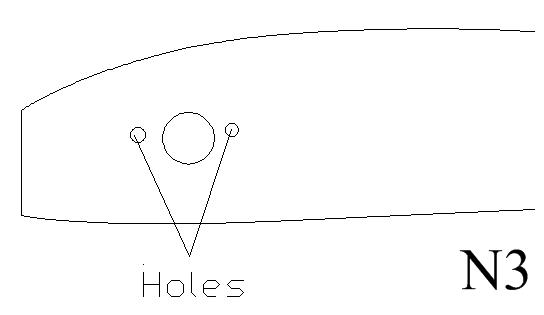

Hi Doogie,
The wing tube was not glued, or poorly, to the foam.
You can drill holes, the size of the syringe noozle on the uper or lower surface, or both.
You can also, as you say, pour the epoxy from the wing root.
Instead of epoxy, you can also use expanding foam after you humidify the foam core...
But once again, drill 1 hole, pour the epoxy as a test. Not all the S2G kits, even the old ones, needed to be fixed. Your kit might not be in the lot !
But if at the first hole, you pour a lot of resin inside the hole (well, relatively  :wink: ) that's a bad sign ! And you can go ahead by drilling more holes to put more epoxy or foam.
