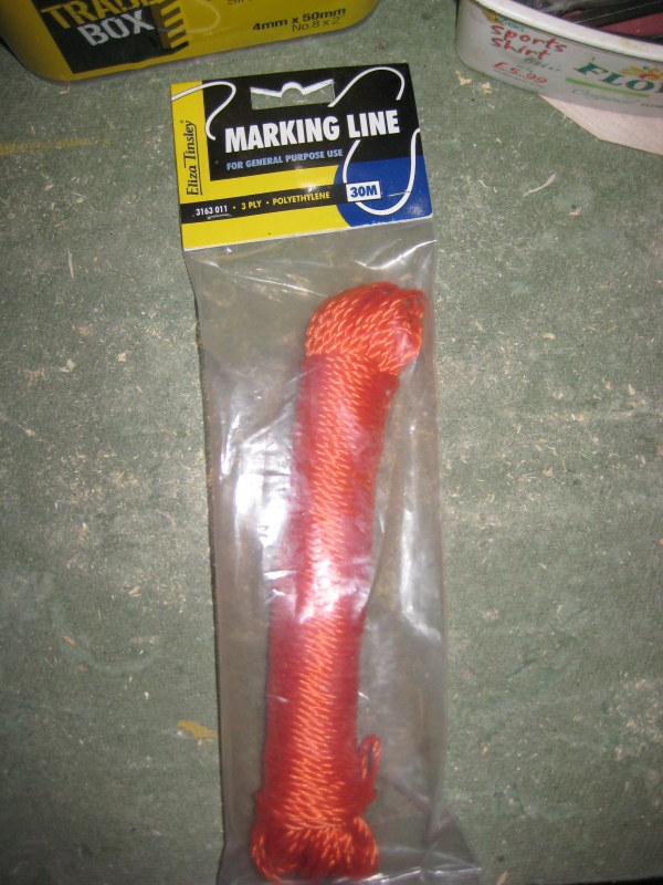

« Reply #2 on: August 05, 2012, 19:42:54 PM »
Adrian this is the line i use i had to buy two as 30m is about 90 feet
hope this helps
all the best  :D
