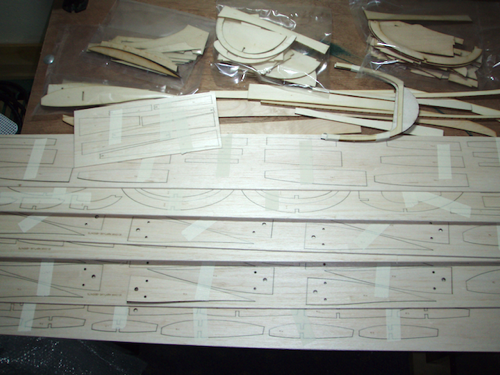

Not sure this is the right place for this subject, but as I'm just starting on a Slingsby Skylark 4, and have a kit of the major parts from Belair, perhaps it will do.
Here's the kit...

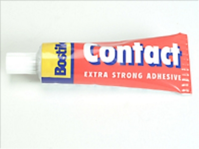

Well, I don't really know.. This is the basic one you will find in Homebase or B&Q.
Red tube with a big "contact" on it  :wink:
Hope this help !
Or if you are coming at the Mt Leinster Glide-in, I can bring a tube...

Ah thanks Fred.
A picture is worth a thousand words, etc, etc.
Nothing like the ones I have, but I'm sure I'll find it in Bantry this morning.
