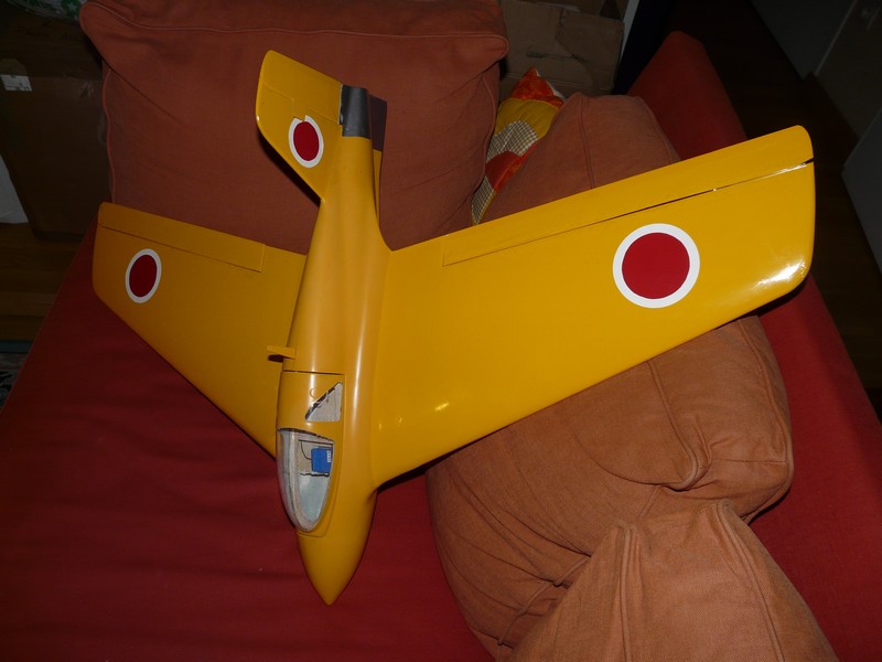

Model is covered, it weights 730g (not balanced, without pushrods for elevons):
A+
Mat

« Reply #21 on: November 04, 2012, 16:00:02 PM »
Quote from: "erwan"
Ca fait quelle charge alaire??
Wing loading is approx. 46g/sqdm... not so bad!
But I still need to balance, she will take a few more grams to the end.
A+
Mat

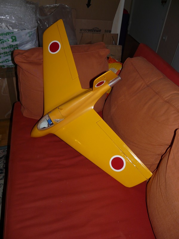

« Reply #22 on: February 15, 2014, 22:19:23 PM »
Hi there!
Long time without connecting to the forum.
The Shusui is now ready for the maiden flight.
Weight is about 760 grams, with pushrods & balancing (I had to add 15grams of lead).
This leads to a wing loading of 48.8 g/sqdm, I targeted 50 g/sqdm: Yeeeah!
Tomorrow I hope I'll be able to make the maiden flight (y'a qui qui vient à la pente???).
See you soon!
Mat

« Reply #24 on: February 16, 2014, 20:03:50 PM »
Good evening,
Coming back from the slope, everything went right: she flies! :D
I had to set the elevator trim up and I had to pull slightly on the stick during all the flight, I think that the balance is forward, I'll have to remove carefully some lead to analyse the impact on the glider's behaviour.
It flies fast but can slow down gently. The silhouette of this PSS is very realistic especially in lowpasses, just missing the walter exhaust sound!!!
Unfortunaterly we didn't enough time to take picture, the rain was becoming stronger and stronger  :(
A+
Mat
