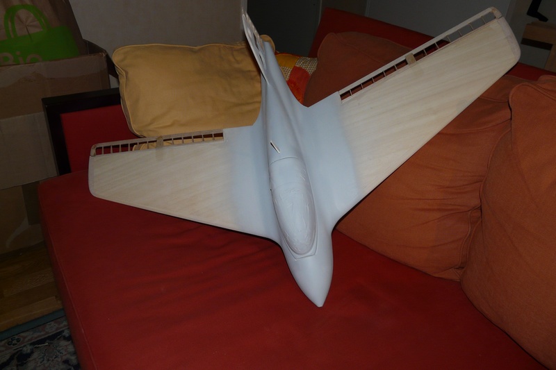

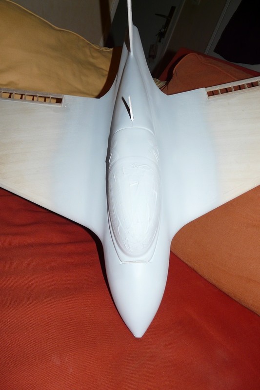

Here are pictures showing the structure elevons and the wing fairing, after a hard work of sanding/filling (difficulty came from the different hardnesses of composite, epoxy bond, obechi sheeting, polyester filler & gelcoat) and spraying of two primer layers:
The leading edge fairing is now OK:

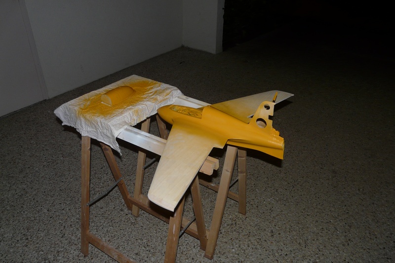

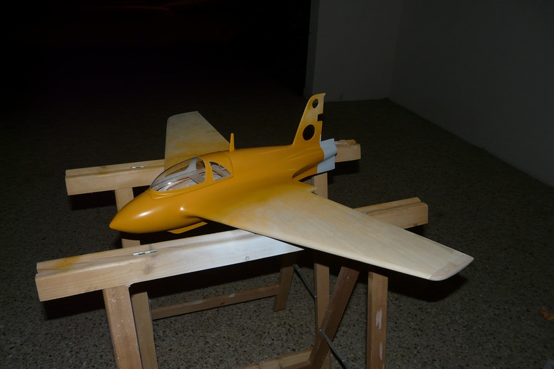

And yesterday evening I sprayed two layers of yellow paint:
And after removal of masking tape:
Good news: I managed to spray without making any paint drop! 8)
Sad news: paint is not as gloss as I wish, it looks satin, although the aspect is slick... I don't understand why!  :(

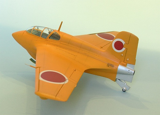

Uh, I just forgot to show you the paint sheme I choose:
(It is a semi-scale, that's why the canopy - from a Me163A - does not correspond to the model showed above... If I have a few time I'll try to mold a new one)

What marvellous work Mat, 8)  I admire your abilities! :clap:  (I wish I could build models like that. :!: )
The last picture is only here to show the scheme I wish to copy, but I didn't build this static scale model!

Great Job
You can use polish for have a gloss paint.

Hi Matt,
         Nice model. Lack of gloss is caused by painting in damp conditions. It's referred to as "Bloom". It can be improved with paint rubbing compound.
