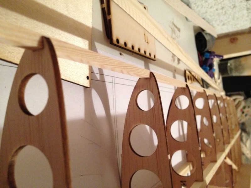

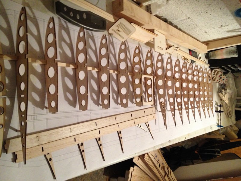

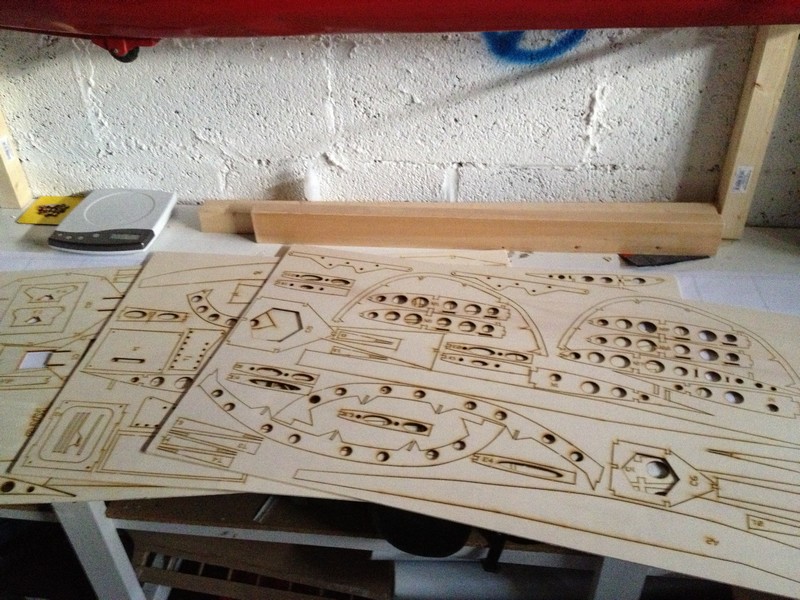

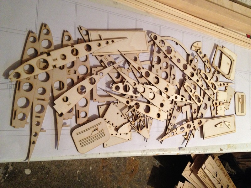

All the wood is cut :
And all the parts removed from their sheet:

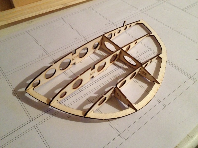

Dry fit test of the new wing tips  :D
And the build start :

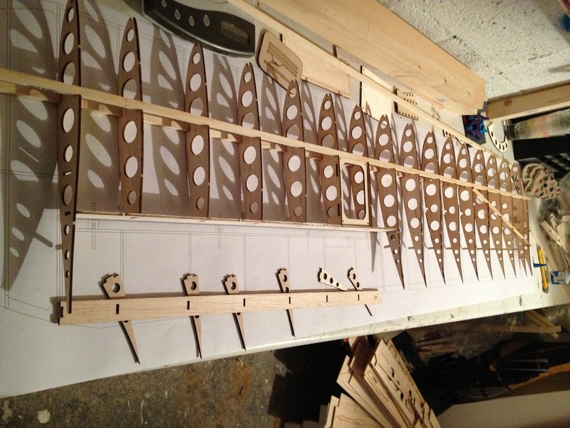

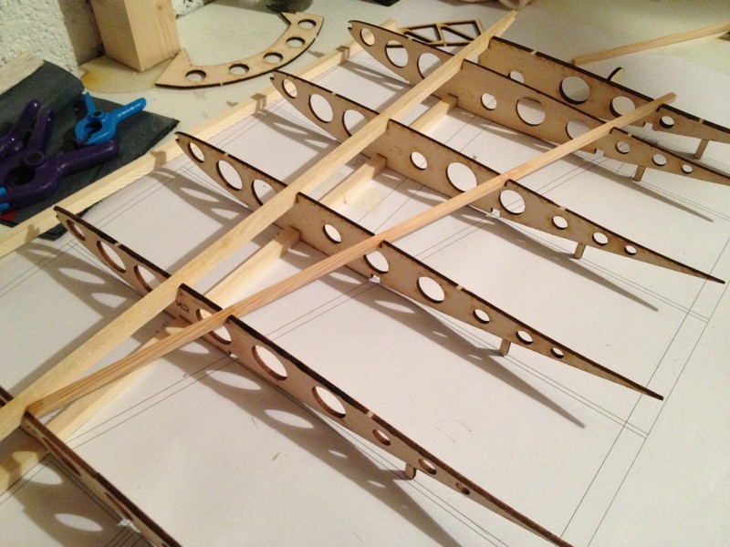

Spars are 8x8 in pine
2 degrees diedhral
Aileron's LE are closed:

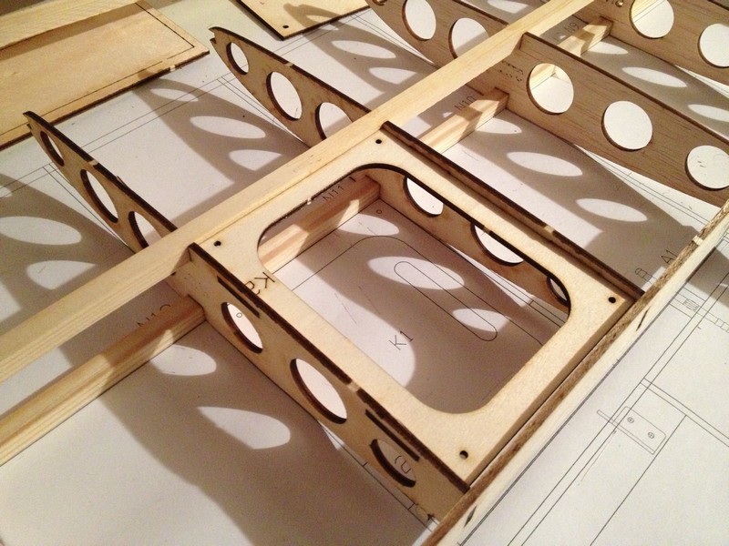

Servo frame:

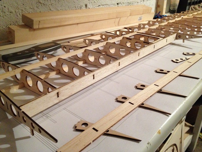

Sub spars(?) in 5x5 pine:
Root rib

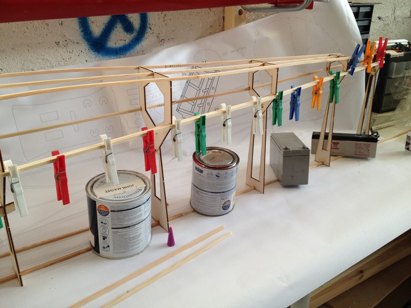

And the TE in 5x5 (plywood sheeting will then be rolled over as usual
And weights to set it down while evrything dry.
Tomorrow, next wing, and wing tips.. And it will be time to remove the wing from their jig to work on the other side.

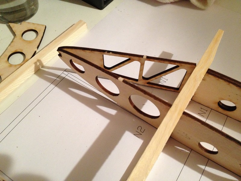

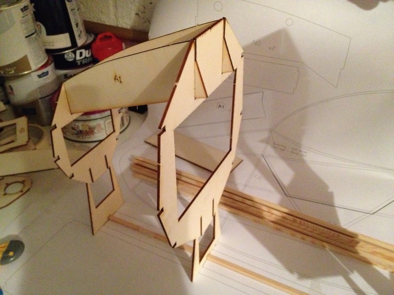

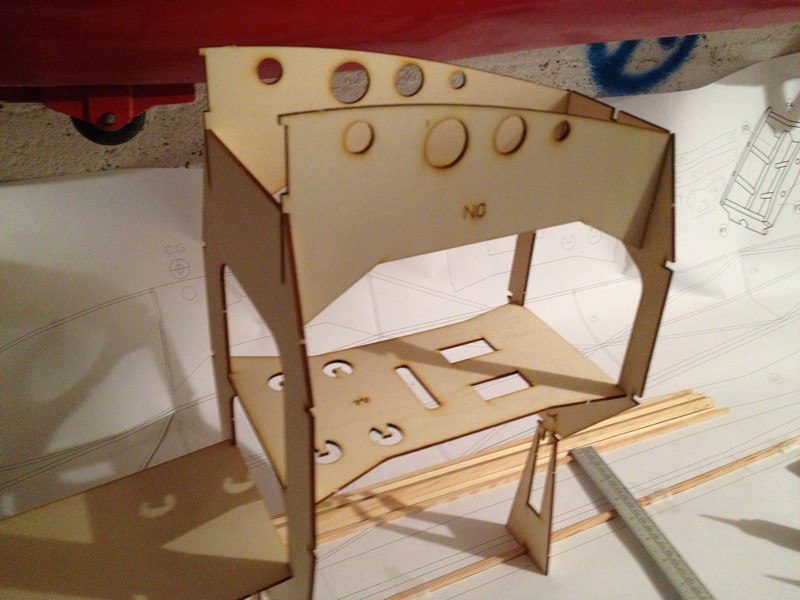

But yesterday evening was quiet, so with a few days behind, finally started the fuselage!

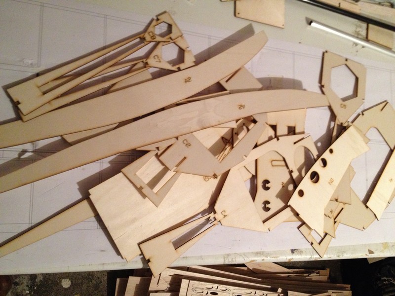

All the parts are cut from their support.

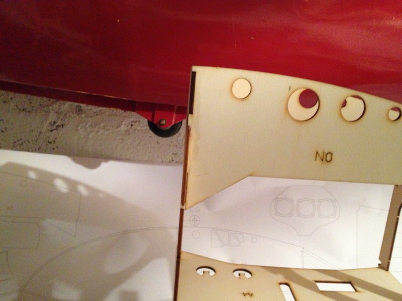

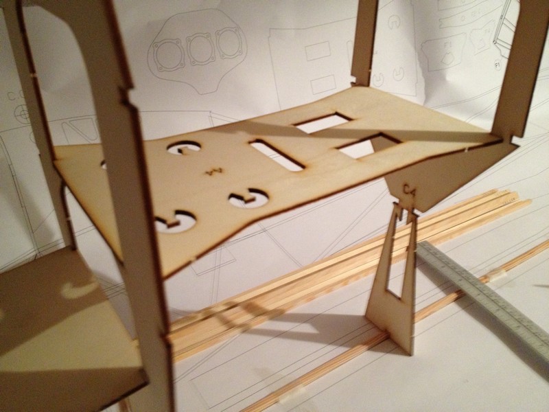

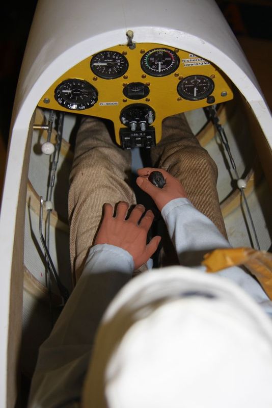

Oh and look at my new pilot deck  :D

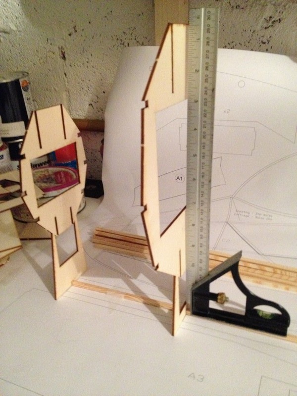

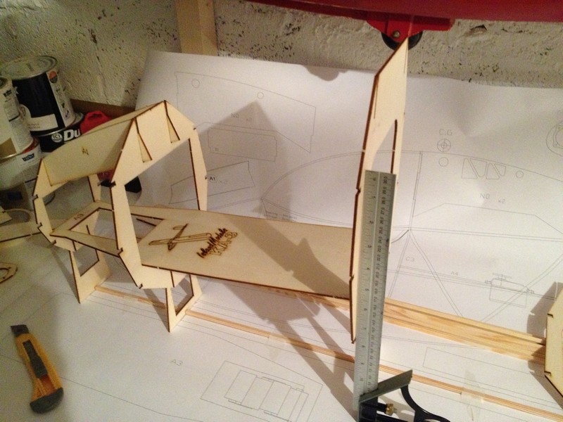

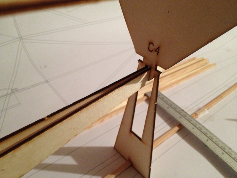

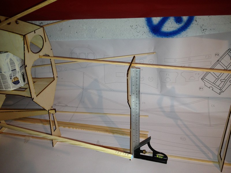

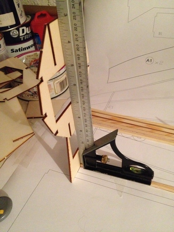

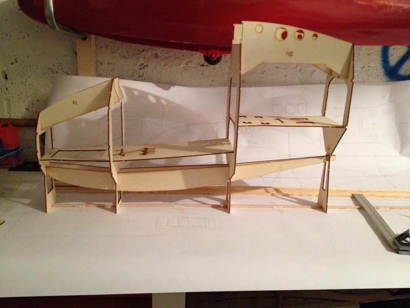

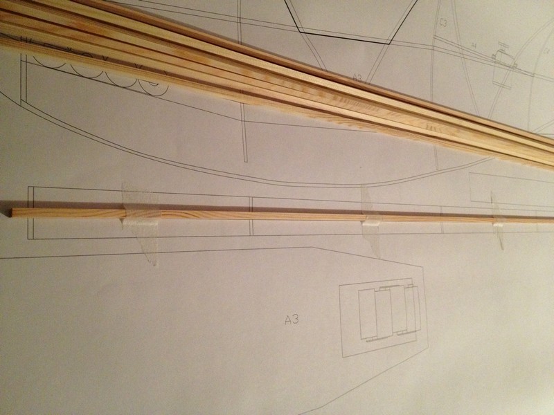

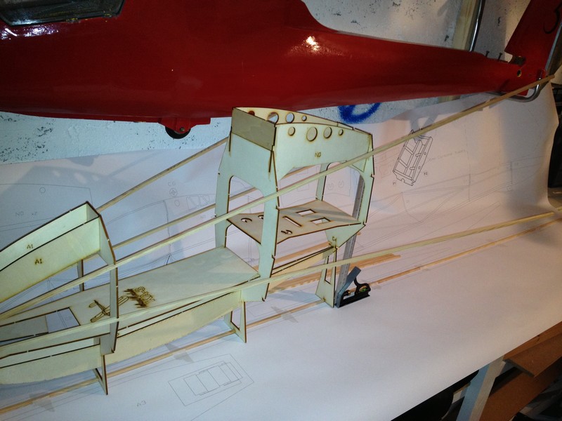

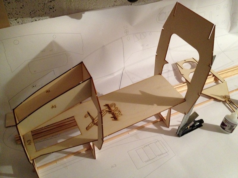

Starting with aligning the 5x5mm pine strip that will be used to align the fuselage, and keep it straight.

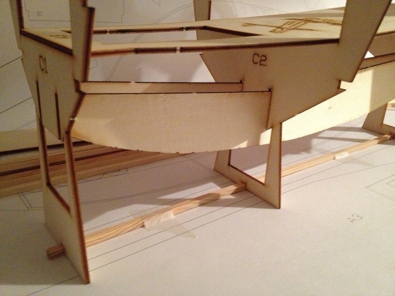

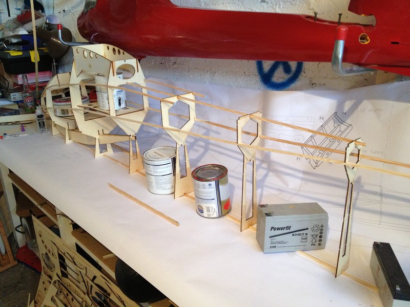

Then the fuselage is build, one section at the time, moving from front to back, making sure that eveything is straight at each steps.
And that's the first section. Followed by the next one
And so on...

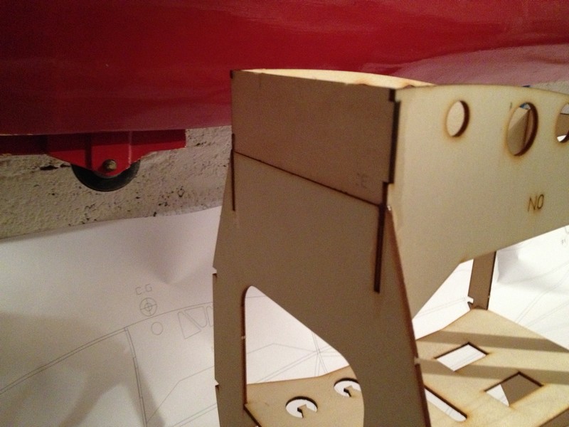

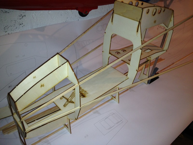

I changed the skid design aswell. Not glued yet, but put in place to check that everything was ligned correctly

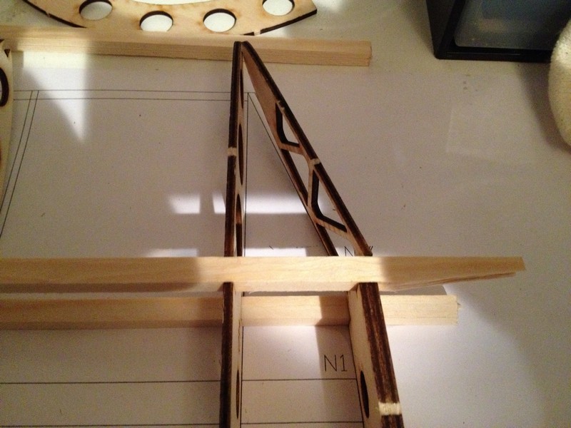

Front wing support closure.. Now flush with the former! (I know, I know... :oops: )

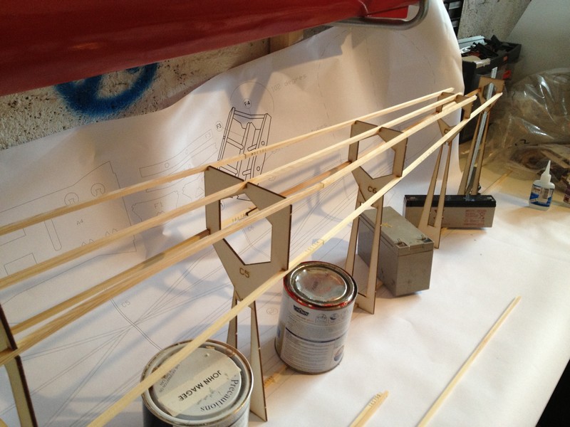

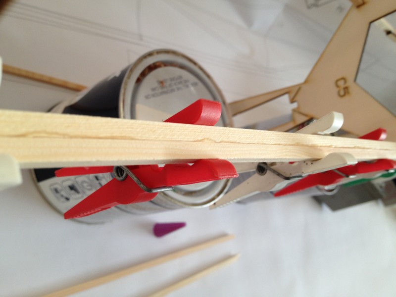

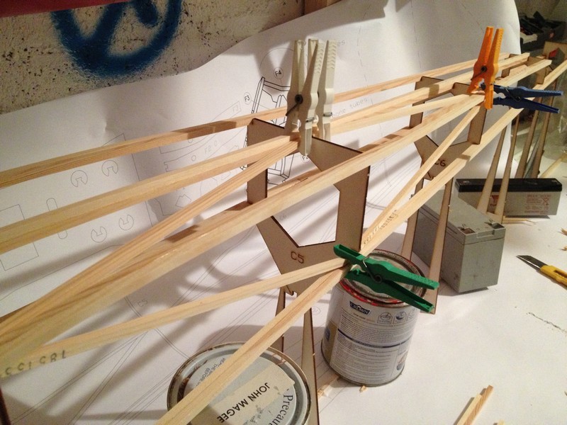

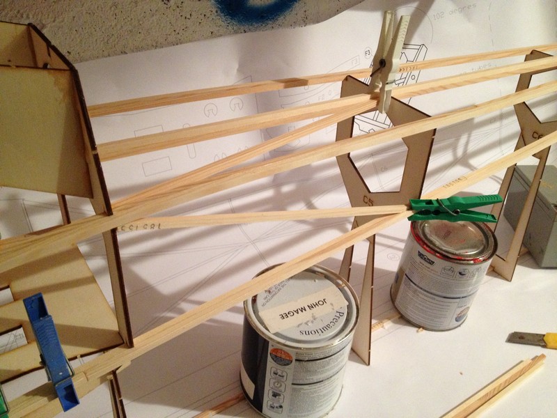

Before going forthur, it's time to put the first 5x5 pine stringers.
Like the formers, I start from front to back, formers by formers, and both sides at the same time to avoid going banana  :lol:

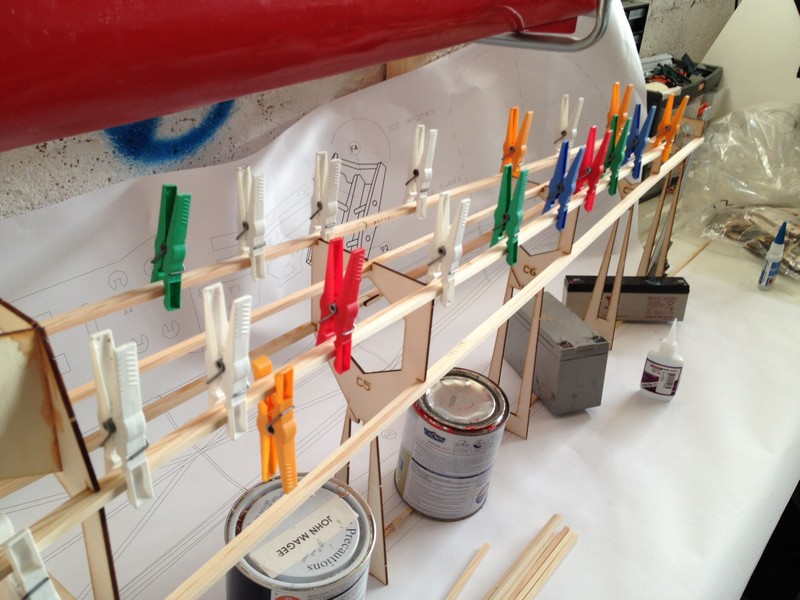

Then, time to glue the stringers to the formers at the back of the fuselage.
Then, the second stringers are glued on top of the first ones, this time, from back to front.
Finaly, the angled stringers (?) are added, working on both sides at the same time.
Not bad! Fuselage structure is almost completed. Tonight, I will finish the fuselage boom, then, it will be time to remove it from its support to do the underneath (easier to do of the jig, and with all the stringers in place, fuselage is already rock solid!).

Nice job Fred :D :D . Whats that red fuselage in the background  :?: .
1/3 Scale Ka3 - Another one! With a difference :)
« Reply #10 on: November 12, 2012, 17:41:07 PM »
LO100 :lol:
« Reply #11 on: November 12, 2012, 17:57:08 PM »
Nope  :P
Slingsby T43 Skylark.
The Lo100 is much higher on the rack  :mrgreen:
