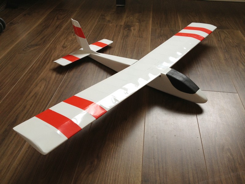

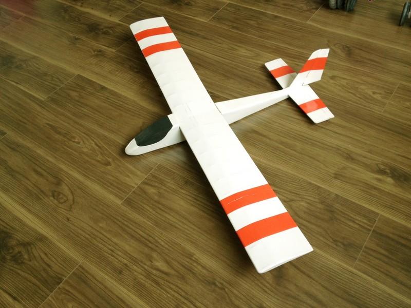

« Reply #11 on: April 08, 2013, 12:05:08 PM »
Forgot to put photos of the almost finished product!
Sorry, went boring on the colour scheme  :oops:
