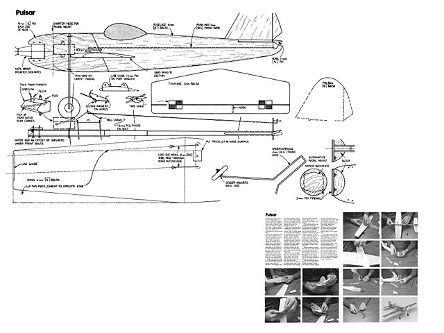

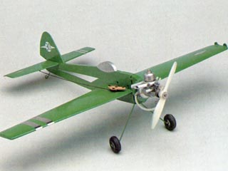

If that can help, you have buckets of CL plans on the Outerzone.
As for me, many moons ago, I started with this:
The Pulsar. Takes an hour to build and flew very nicely as far as I remember  :D

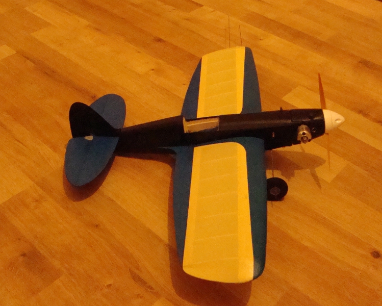

Hi Andrew,
             Great to see others trying control line. I went back for nostalgic reasons. Above is a pic of my latest build (not yet finished) of the model I had when I was thirteen. Its the KielKraft radian powered by a brodac .049 engine, plans downloaded from net.
What problems are you having as flying straight and level should not be a problem so long as the cg is correct and line tension maintained. Freds plan looks good but you will be quickly bored by it's lack of manouverability.
