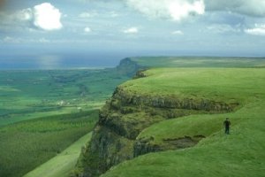

That is one Corker of a slope! :D  With lovely grass landing areas as well.
By the shadows I’d say it faces NW, am I right? How long does it take to get there from Moneymore?
(I think you N.I. guys are greedy. You hog all the best slopes and keep them to yourselves! :evil: )
« Reply #197 on: November 28, 2011, 12:08:24 PM »
Hi Keith, it takes about 40min from Moneymore, and yes it is North and west slopes with another south slope on the back.

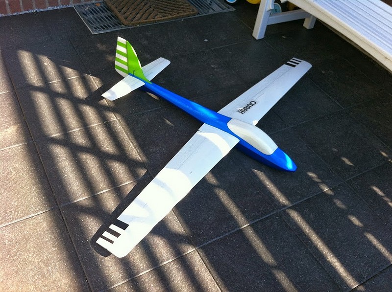

This one, built by Martin in Brittany, did its first flight yesterday.. And love it!  :D
It is built like John's one, in extruded foam, not EPP. And admire the colour scheme!  :D  :mrgreen:
Built straigh off the plan, the only modification was to create a box, in 5mm plywood around the wing joiner tube in the fuselage (I think John had the issue of the tube crushing the foam...)
Specs :
-- 4 servos Protronik 9g   6452MG
-- 1  5 cells battery 900 mah
-- 5ch Jeti receiver
AUW : 806grs
He is now testing fligt phases etc  :D
Another 3 are being build this week, with TP profile, and one with wing incidence. I will let you know how these ones are going.
Ok, I go back in the garage finishing the plug for the 3mtrs one!  :D

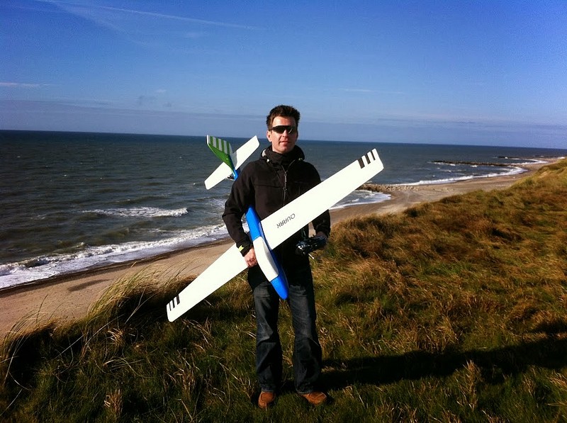

Looks like the Quark EPP still have aficionados, this time, from the North Sea borders, with Jens, who report some great flying with his Quark Mini EPP  :clap:  :clap:
And more photos of his Quark here : https://picasaweb.google.com/Jensbot/QuarkMiniEPP?authuser=0&authkey=Gv1sRgCPbX_vn-sJjJkQE&feat=directlink#
Nice one Jens!  :clap:  :clap:  :D
