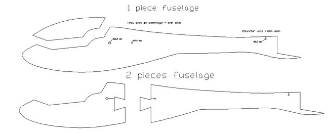

Ok, so, here you go, 2 screenshots of what I did 2 years ago :
The size of the design was for a 1.8m glider, all foam, with a nice spar system for the wings and elevator (everything can be removed for transport, and take no space at all).
Fuselage is 1.3m long.
Did the same, but 2.5m WS. The fuselage was massive!
I have the files for the cnc cutting machine, but that can be resized to any size anyway, but big like that, is kind of cool!  :D  And that was to change from the smaller vtpr style foam machines out there.
Profile was choice of a TP, or the good old SB96/VS, or anything you want (flat sides where the wings seats).
I've also made the same one with wingeron, and also a 4 servo wings... Everything is do-able.
If some of you are interrested, I can print the plan or give you the files (I think some cnc foam machine are under used  :P  :P ). Can be a nice group project  :D

Sorry no, the 2 piece fuselage was for the cutting company. They are then glued together (was to fit in a standard EPP block).
