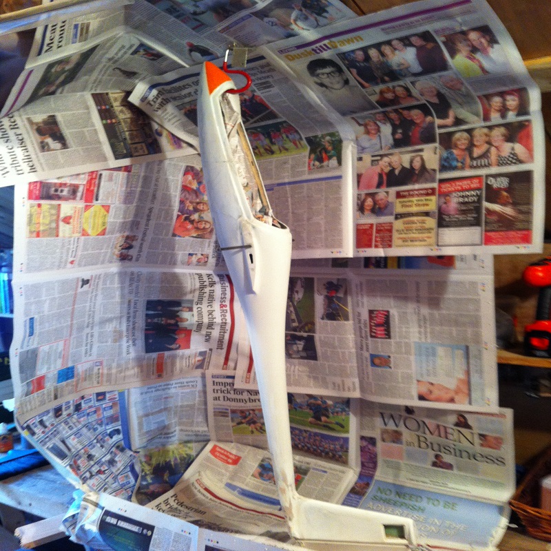

With all the sanding done I sprayed the body with enamel paint and it came up very nicely.  :lol: yes I could do it better a second time round but as a first attempt at this... it's alright now.....

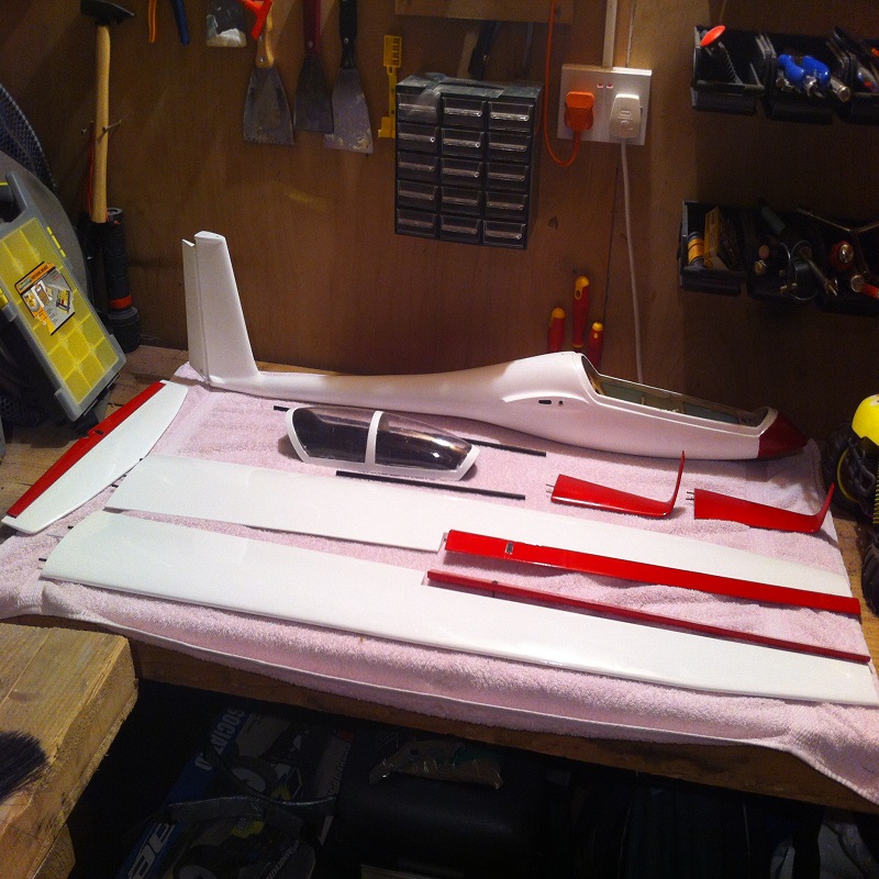

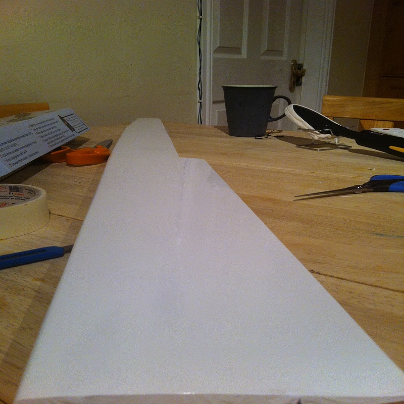

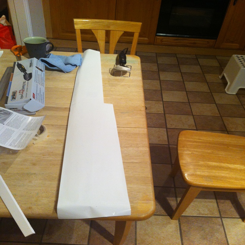

So with all of this done now it was then onto covering the wings and moving parts. The original DG, I think, must have been an ARTF becasue there was a plastic clear film over a painted surface.... I could be totally wrong but it just appeared that way. (This was my first time doing this kind of work)
So thanks to a few conversations with "Little Keith" (Mr. Happy Days) and google I went forth and got red and white solarfilm to cover the plane. The wings were stripped down and sanded to remove all the paint and the covering began......  :lol:
It took some getting used to but you tube was a great help.... thanks Happy Days  :clap:
The rudder, ailerons, wing tips in red  8)
So its ready for assembley now......
 more to follow in the coming weeks
