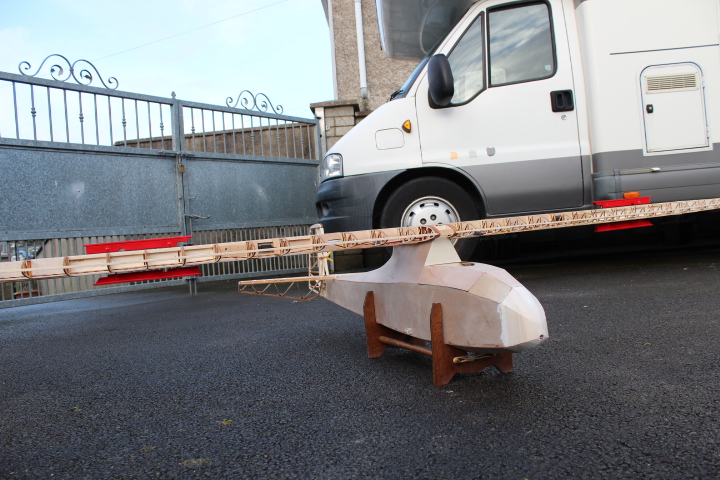

he and mario (ronan) have full build logs of the model with the original wing, so here's a few photos of mine with the new wing (spot the difference)........

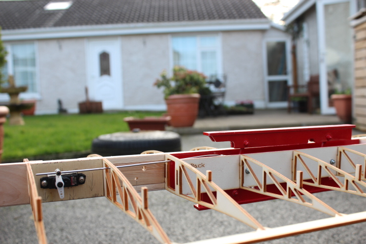

 this is where the airbrakes will go. i'm working on them separately until i'm happy with how they work.
 this is where the a/b servo will fit. i'm using a couple of hi-tec 82mg.

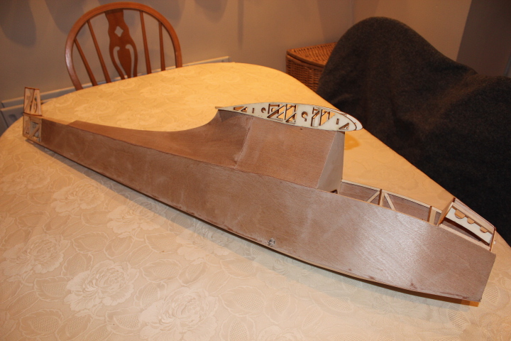

grunau is progressing nicely............

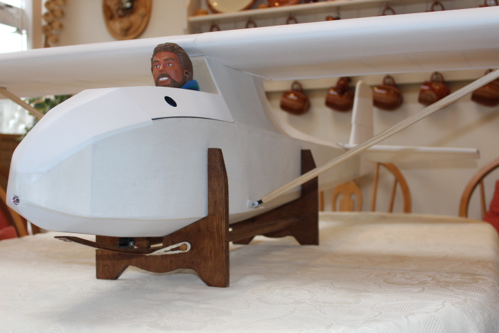

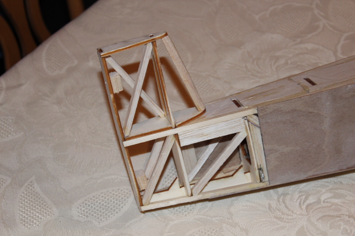

i left the rear end open until i've connected the elevator control horn...

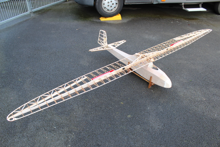

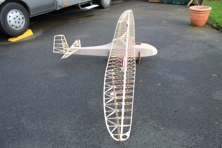

first proper look at all the bits assembled.....
airbrakes built, painted and installed.....

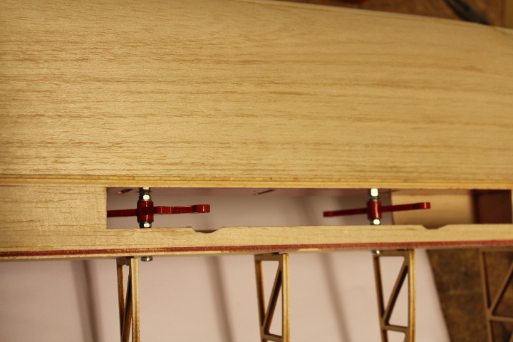

and up close...
that wing really does look nice 'in the bones'....!
next up, sheet the wings and make some struts

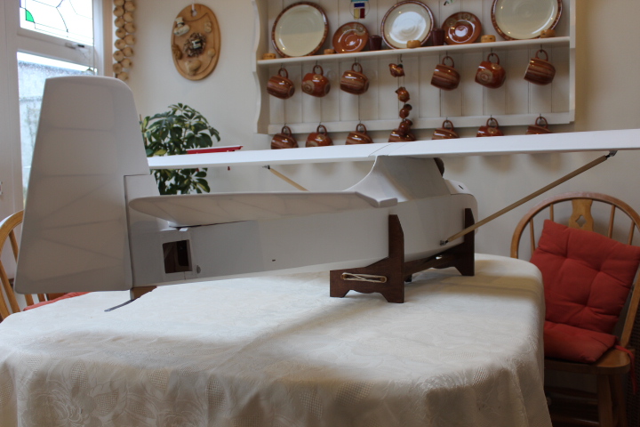

update on grunau baby.

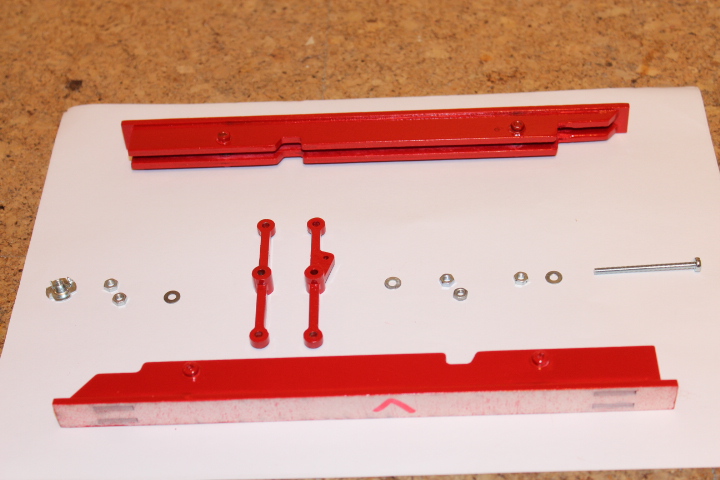

i ran into some bother last year while working on the air brakes. clumsy fingers and fairly delicate pivot arms don't go well together.  i had the a/b's working nicely, then i dropped a screwdriver into the  a/b well and while getting it out, i broke one of the pivot arms. 'oh dear' is a polite version of what i said!!!  i tried to make new ones from birch ply which were stronger, but they were never quite right.
so the whole build ground to a halt for months until a friend of mine made me a set of arms from aluminium exactly as per the originals. problem solved.
now i was back on track,  building was resumed and in the space of a few weeks the model was finished and covered.
at the moment i'm putting on the primer coat of paint, so should be gloss coating soon.  the colour scheme is basically white with some coloured trim.  my problem has always been paint creeping under the masking tape and causing all sorts of grief.  if anyone can suggest a better type of masking tape or technique, i would be delighted to hear from you.

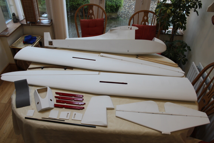

a few photos of the gb as it is parts of the a/b's
parts in place
parts ready for assembly
and ready for painting
