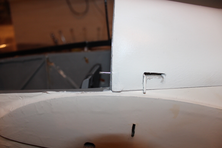

A quick question Gerry how did you attach the canopy to the fuselage did you hinge it or use another method

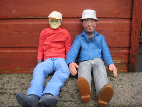

i've bought a couple of pilots over the year the first one i bought from AH-Designs in Wales he's the red one and the second one i got cheap on ebay  :D both are suppose to be 1/4 scale  :lol: :lol:

Andrew, I know what you mean. I have two pilots from AH Designs. A 1/4 and 1/5 scale one. Both of them have legs that appear to way longer than they should be. In fact I'm probably going to have to amputate the 1/5 scale pilots legs to get him to fit in my Skylark. I also have a 1/4 scale pilot from Premier Pilots and he seems to be about right. He's the one in my K8.

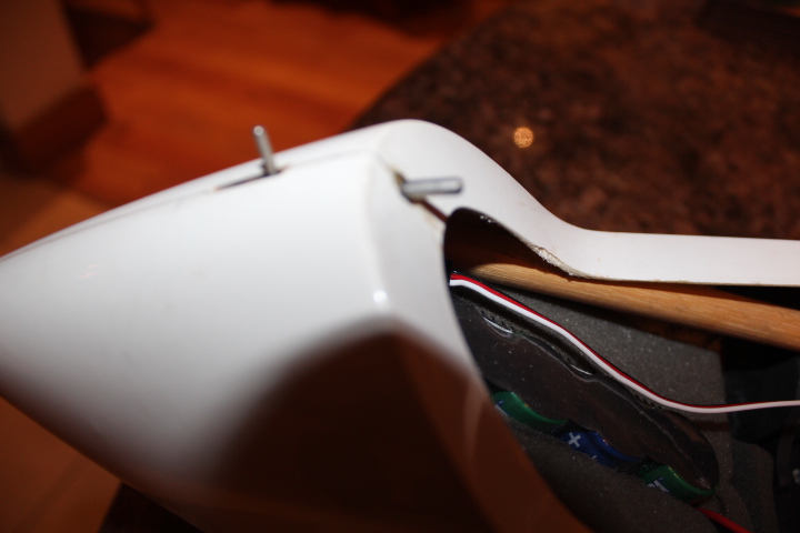

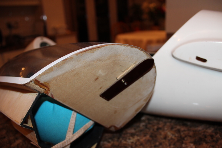

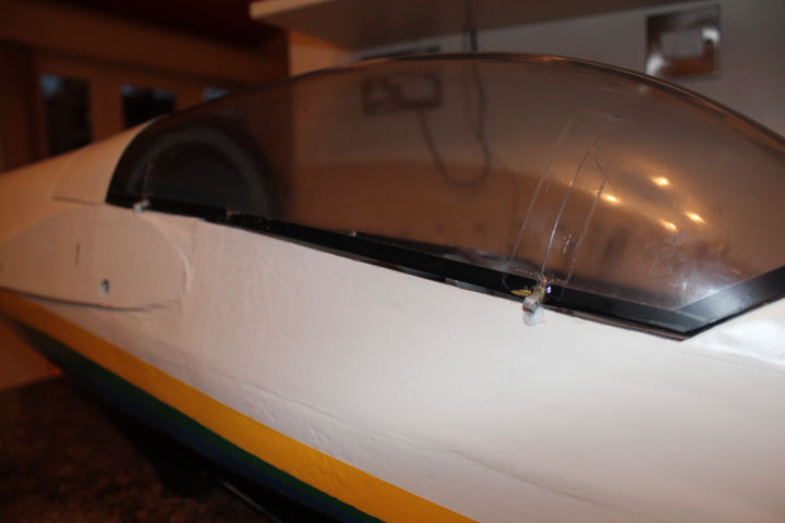

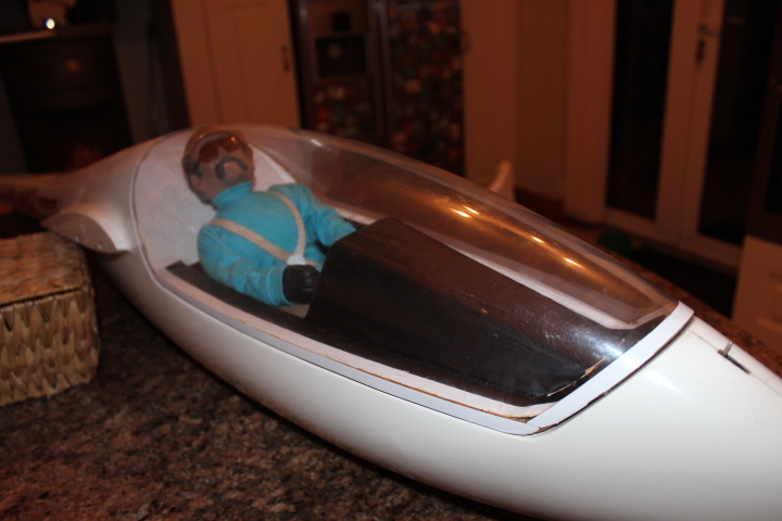

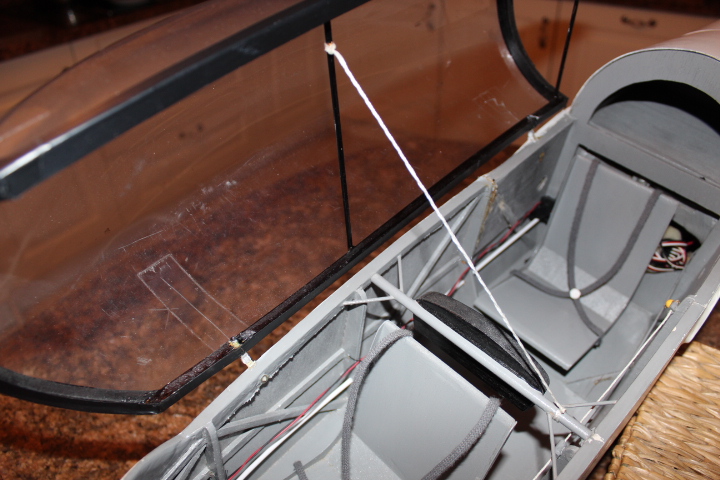

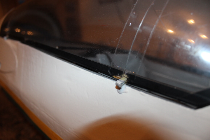

re hinges, i use the du-bro round barbed ones on the ask 13 and 18. they look quite realistic and work well.  my 13 is 21 years old this year and i had no problems with the canopy until i hit it with my boot and split the plastic right at the hinge points.
i use spring loaded hatch catches to keep the canopies closed.
the canopy on the asw 20 is held on by a tight fitting piece of fibre glass strip at the back which engages in the top of the fuse and again a spring loaded hatch catch at the front.
i used small strong magnets (neodymium i think they're called)on a hatch on my ka3 and they stay well stuck in place.

couple of photos andrew.....

:clap:  :clap:  :clap:  :clap:  :clap: good man Gerry and thanks for the photo's they've made life a lot easier  :D
