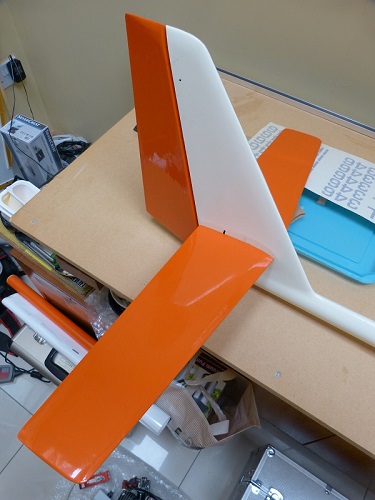

Hi all.
has anyone built and flown this model.
I am wondering how I will keep the Stap on the two metal rods.
Do I glue them in place ?.
Hope someone can answer this Q for me.
I am not sure but I think Keith told me that he had one a good while back....
Yours.
Adrian.

hi asw, (Anthony Sean William?)
i have had several models with all- moving tailplanes, including the alpino and 3 flamingos (all mpx models) which simply plugged onto the wire joiners.  provided the t/planes are a tight fit on the wires, that's all that's needed.
if they're a loose fit, i suggest you mix up a little epoxy, sand the wires to roughen them and then lightly smear the wires with the epoxy.  when the epoxy is fully dry, trial fit the t/planes and sand until you get a tight fit but can still get them on and off.

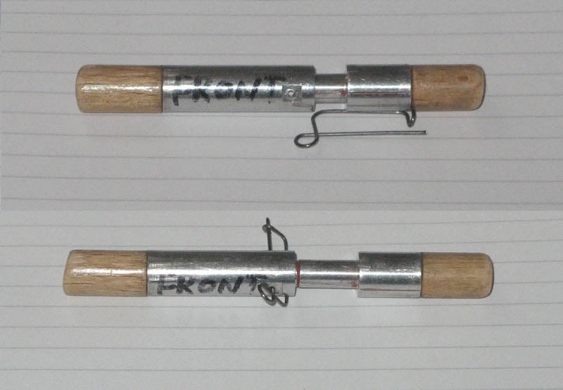

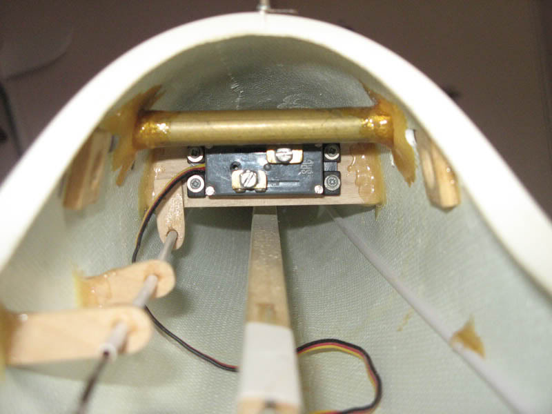

i'm wondering what the parts are in the 2nd photo and what's the purpose of the servo in the 3rd photo?

Thanks Gerry.
They do fit tightly and having no engine vibration they will more that likely stay in place. I would just hate to loose one in flight.

PS. These bits are for keeping the fuzz from crumbling if you have a hard landing or sudden stop, when the wings continue to move forward after the fuzz stops moving. They fit into the two holes inside the walls of the fuzz at the front of the wings. See photo.
It's late so good morning Gerry.
Adrian.

Gerry. Just remembered your servo Q.
The photos are not my model. I came across these photos on the net & I thought they where a good idea and was wondering if anyone new where I could get this type of brace.
The servo inside the fuzz in a slide movement servo. I'd say it is for the Ailerons.
Adrian.

Hi Adrian,
I don’t have the flight hours or experience of young Gerry, so he is probably ‘Your Man’. (Er,……did you see that Gerry? I actually paid you a back-handed complement,…calling you “young”  :roll: )
To the Alpina; The tail plane on mine is, what you might call, very loose! However they have never fallen off (so far) after 25 hours of what might be described “Energetic” flying. Apart from during rolls, there is virtually no lateral kinetic force being placed on them, so they should stay put.
What I have found is that by bending one of the rods ever-so-slightly, so that you have to push the rod to line up with the opposite tail plane, that extra friction helps to keep both parts of the tail plane together.
Like I said, Adrian, the tail plane is loose. My first flight with my Alpina was something of an act of faith.
