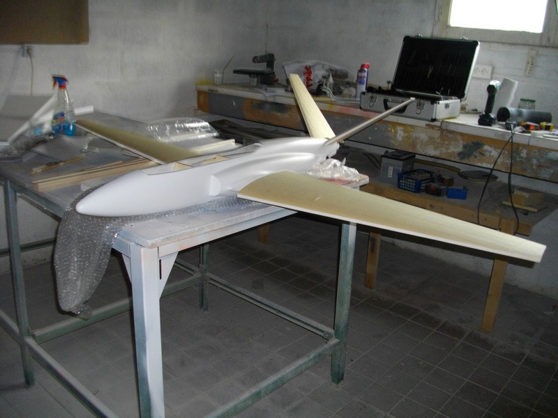

bon , ouverture de la boite , c est beau et leger, merci john :mrgreen:
au boulot 8)

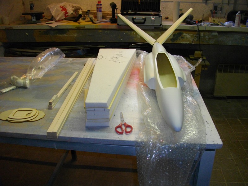

« Reply #1 on: September 25, 2014, 18:28:08 PM »
la suite

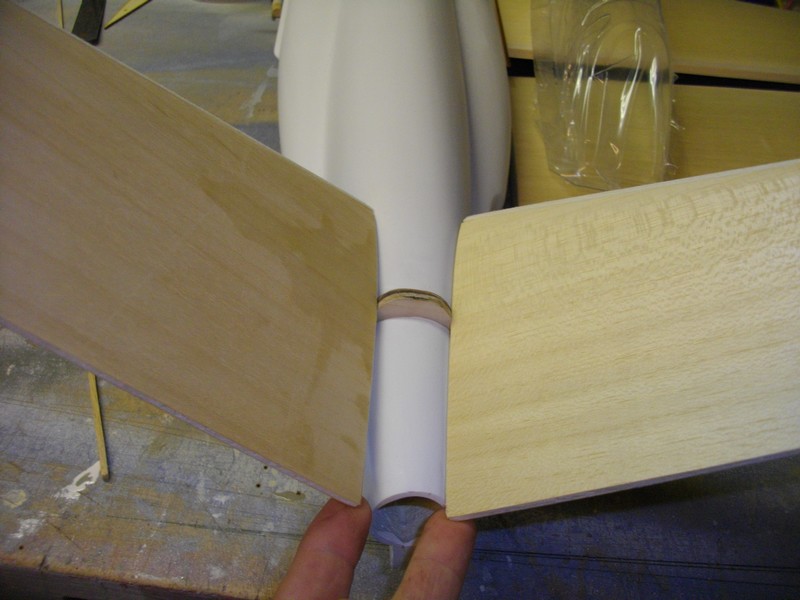

fouga
« Reply #4 on: October 07, 2014, 18:21:06 PM »

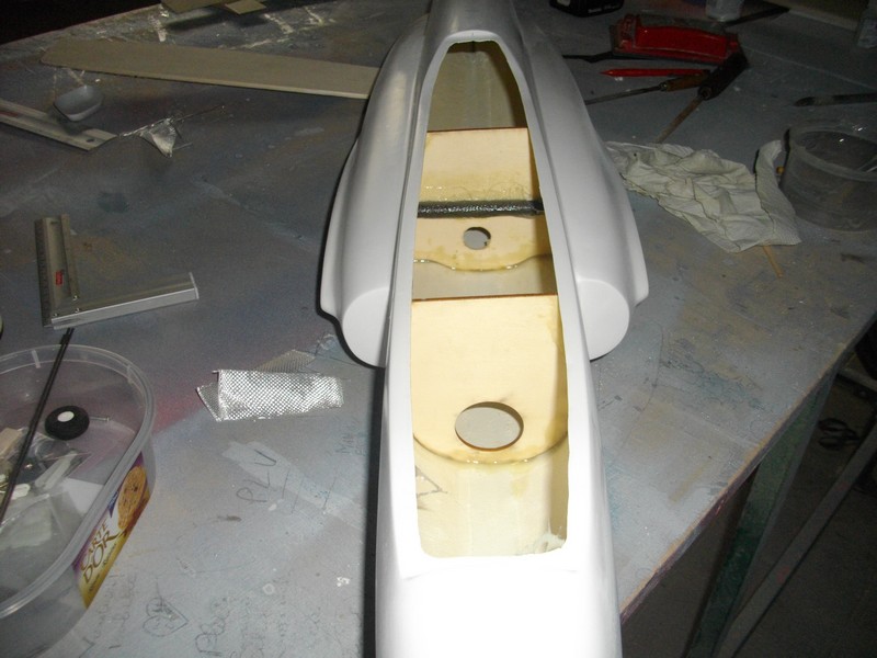

question pour john
c est comme ça ou il faut le rentrer plus

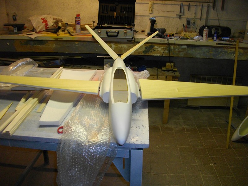

fouga
« Reply #5 on: October 08, 2014, 16:34:34 PM »
@ John: Ronan wants to know if it leave it like this, or that need to go deeper into the fuselage (the wooden support).
Photos of yours in this area?
fouga

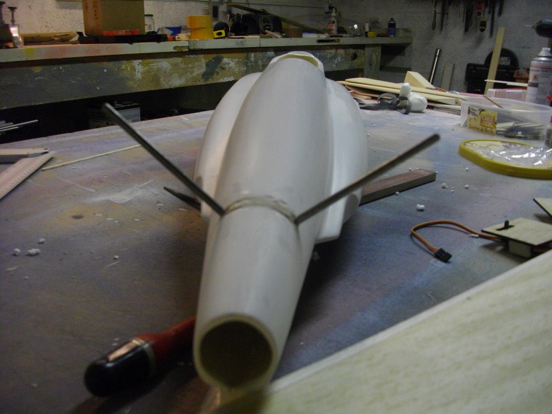

« Reply #6 on: October 08, 2014, 23:06:48 PM »
Hi Fred/Ronan
Complete and install the wings first, as they will act as a guage for the V-tail alinement.
As for the V-tail support, the bottom of the block sits on the bottom of the inside of the fuselage at the tail, any ply sticking up from the v-tail support slot, can be removed when the block is glued in place.
To get the correct v-tail alinement, place a strip of wood across the top of the two fins, and move the ply wire block, forward/back or side to side, to get this strip of wood level or horizontal with the wings looking down the nose of the fuselage see pic:
Fred can you translate for Ronan!
fouga

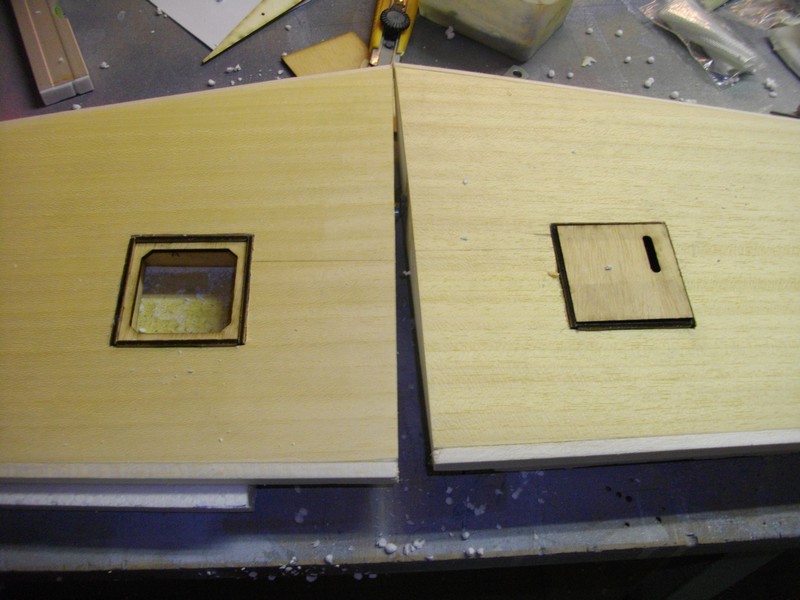

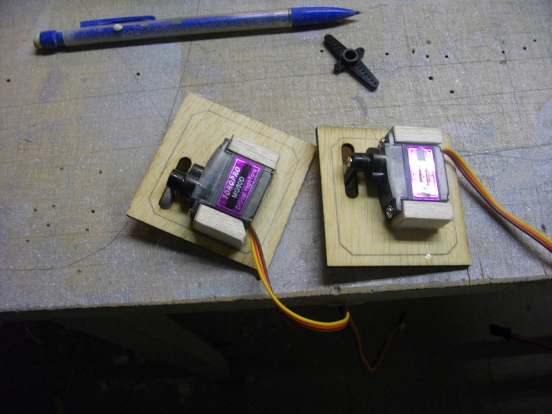

« Reply #7 on: October 13, 2014, 18:03:21 PM »
mise en place des boites a servos
fouga
« Reply #8 on: October 24, 2014, 18:08:01 PM »
le suport de stab est collé
et les servos d ailerons sont fixés :mrgreen:

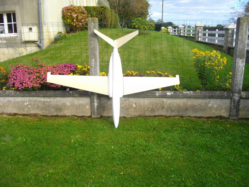

« Reply #12 on: October 26, 2014, 17:32:55 PM »
et hop sous le soleil normand :lol:

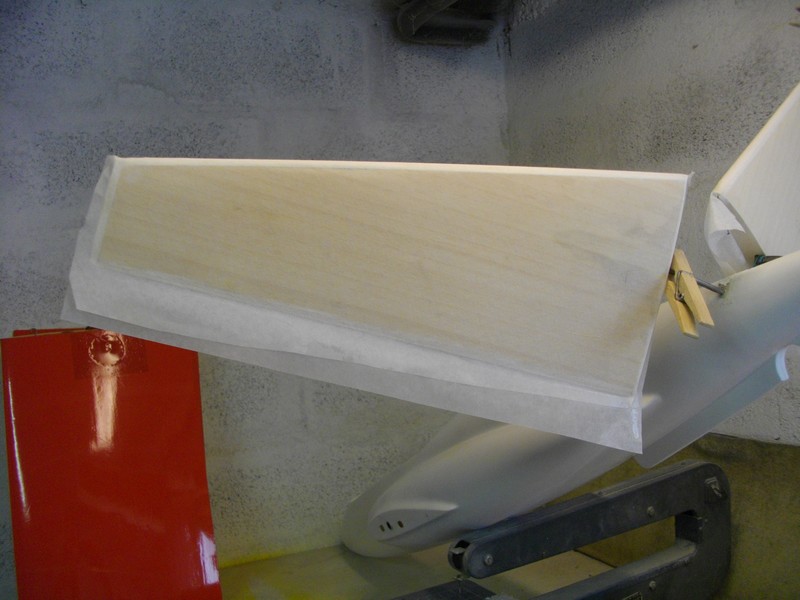

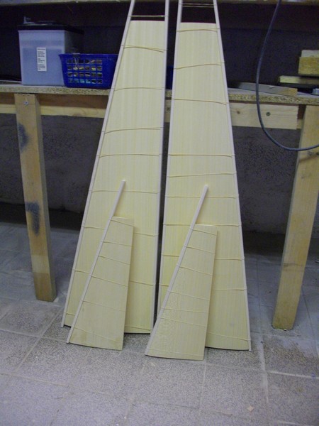

« Reply #14 on: November 16, 2014, 14:23:54 PM »
entoilage des stabs au papier japon
