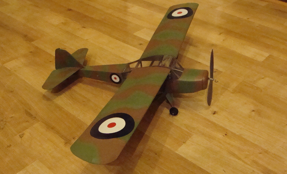

« Reply #21 on: November 04, 2014, 23:08:19 PM »
My latest build, adding finishing touches. It's a 25" span rubber powered Auster built from the skyleeda plan available for download from Outerzone.

« Reply #22 on: November 05, 2014, 20:36:43 PM »
Hi John,
Are you printing the tissue or painting?
Brush or air brush?
Chris

Hi Chris,
           It's covered in a lightweight iron on film and handpainted afterwards with acrilics. It adds a little weight but looks better in the air.
Thanks Fred, looking like a good flier.

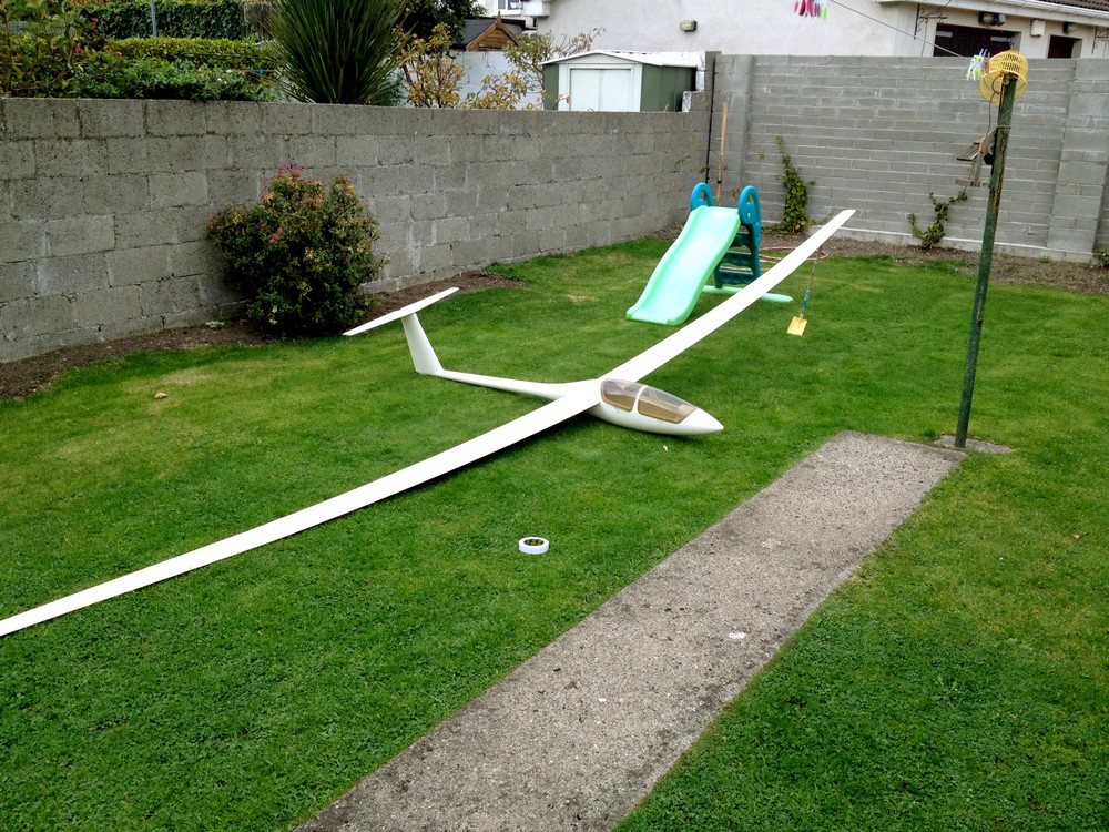

« Reply #25 on: November 07, 2014, 09:18:57 AM »
Did a bit more work on the ASH!
Wing tubes glued, and Incidence checked (quadruple check!)
Oh, and I know why I paid almost nothing for the fuselage! One of the wing socket in the fuselage is higher than the other  :!:  Measured it 200 times just to be sure, but it is. Not a biggie, there is a disgraceful step on both wings. I'll see later how to fix that.
Anyway, a few photos:
Who is building what for 2015?
« Reply #26 on: November 07, 2014, 17:51:49 PM »
:shock:  :shock:  :shock:  :shock:  :shock: Fred that looks a while thin wing for the size of the fuselage  :lol:
  • Posts: 163
« Reply #27 on: November 07, 2014, 21:36:25 PM »
What's the WS Fred? That's a beaut
« Reply #28 on: November 08, 2014, 09:41:29 AM »
Thank you both  :D
Yeah, very high aspect ratio on that one!
Very flexy wings, can't wait to see that in the air  :D
Stephen, WS is 6.5m (but root chord is 210mm on top of my head)
Fuselage is 2.2m long if I remember  :?:
Oh, and finally, after all these years and countless hours of flying, I am giving my ASW15 a bit of attention! New canopy and fresh paint job on the way  :D

Hi John, what covering did you use for the Auster and where did you get it?
I need some for a little rubber FF job.
