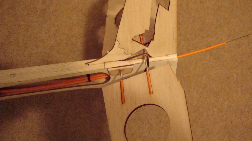

Glue the servos to the fuse sides or if using servo mounts assemble formers C3 and C4 and mount servos. I used snakes for the elevator and rudder controls and set up the bellcrank before joining the fuse halves (it's much easier this way). Glue a plywood shim to each side of the bellcrank alligning with a 3mm rod (a drill bit in my case), I bushed the bellcrank with a nylon tube to suit the snake wire (no play here is good), glued the servo to the fuse side, set it to neutral and made up the snake to give near neutral bellcrank as in the pic above(it's a little up but will trim out). Rudder snake is easy with a little filing of the fuse hole.
I then put the whole fuse together with the formers fitted but unglued, pin through bellcrank and taped everything into allignment and when happy ran cyano into each joint. I made a new front former slightly larger to suit the motor mount and fixed it approx 15mm rearward of the position of the C1 former. Getting started now on the motor cowling.

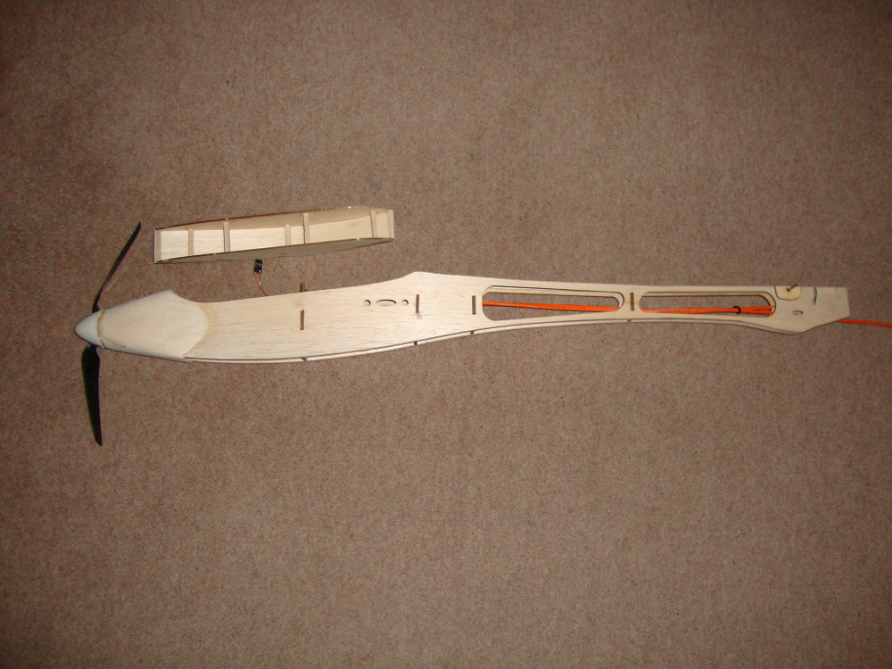

Finished the nose shape. I don't think it takes from the quarkeyness of the Quark and blends in well. Made up canopy using temporary glued in spacers to get the size right and added the plywood tailplane spacers to the back of the fuse.

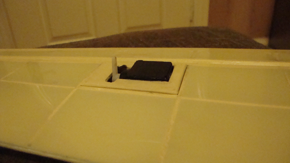

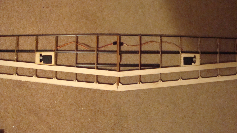

I have the wing building near complete having obtained suitable carbon (thanks to model heli services I received it within one day). The wing servos are too thick to fit fully inside inside the wing so I cut holes in the ply covers supplied to fit. The servos will protrude out the bottom by 2mm. I will hot glue them in. Fred incidence pin holes in ribs N2 and N3 would be nice, I filed them out to suit.

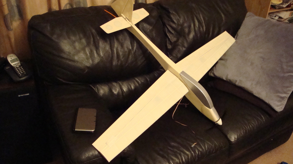

  Nearing the end of build now, covering in progress, cg looks good maybe 15mm forward of where indicated on plan. Weight with battery 570grm and 450grm without. I added a false spar above the carbon to support the covering a little better. Hoping to have it ready for weekend.
Servos at 12mm thick protrude slightly from lower wing, but look ok. The covering I used is more transparent than I wanted (problem with online buying is you don't get a proper look at the goods).

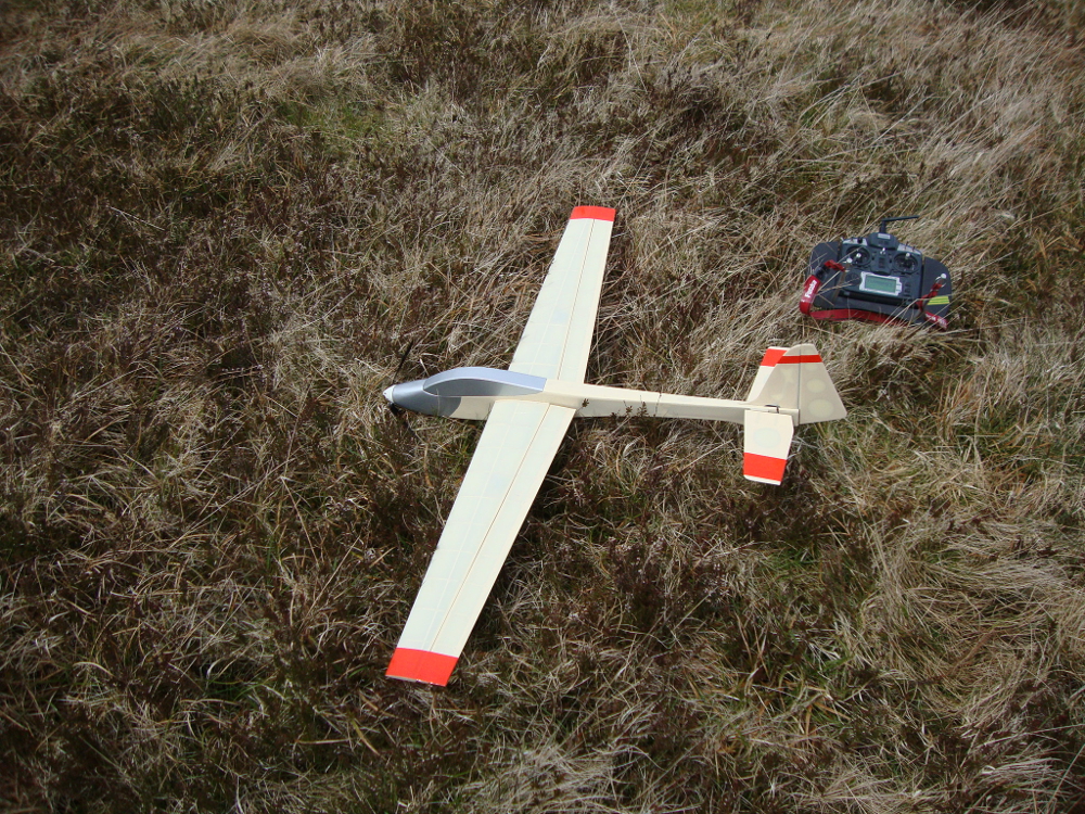

       So the electric micro quark had her maiden flight today on Killakee slope and was successful despite a few minor hiccups. Peter launched it for me into a sw wind with minimal lift and it performed very well as a glider however when I applied power the aileron and elevator controls became incredibly sensitive (due to the increased air passing over them) and the model became unflyable under power. I reduced the rates and what a difference, it was a different model.
 [youtube]https://www.youtube.com/v/MrpTcLCb1vg[/youtube]
I noticed some aileron flutter at the inboard ends under power and feel I will have to do some work to make the ailerons more rigid and prevent twisting.
Resting between flights.
Overall I think this model has the potential to make a superb electric glider for flying on slope or flat field. It climbs so fast near straight up that only a few seconds on power will have it near out of sight and ready for the glide down. It flies fast and stable as a glider and seems to stay up even in marginal lift.
Looking forward to flying it again.

« Reply #10 on: May 10, 2015, 17:22:16 PM »
If your radio will allow it John, you could set it up a mix, so that as you open the throttle the travel on the elevator & aileron reduces. Might make it more user friendly under power  :?:

       It would be nice but I don't think my radio can do that. However thinking back, I had loads of expo set up but forgot to turn the switches on to activate it so was flying on sensitive setup. I always get the basics wrong Doh.

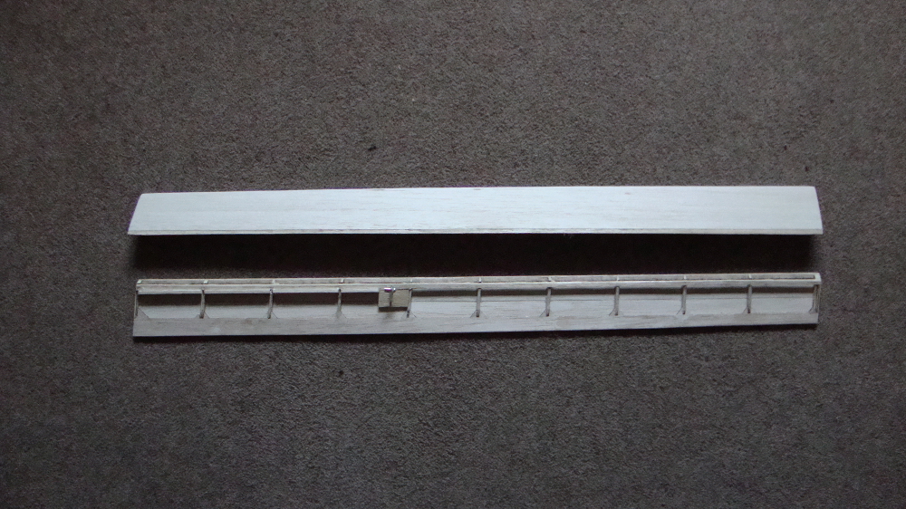

In the meantime I've beefed up the ailerons by carving back the rib tops and sheeting with 1/16. I also added  shear webbing. This combined with stronger hinge tape should solve the flutter problem. They're pretty rigid now.

          Yes cheetah would be quite apt. I do think this conversion would go down well and appeal to more than just slope fliers (it goes so well). If you get to try it before I break it you will want one. Going to try it again on wednesday evening on flat field and see how mods work out.

For the flutter, good move on the ailerons, as it was not originally designed to go like a mini hot-liner, but that thing looks like it is doing well in this area as well  :clap:
