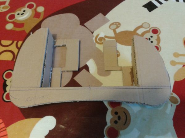

I'd already made an attempt at putting one together, but the 3D modelling was not a success, I couldn't reach the switches on the front of the transmitter with anything resembling comfort. Much hacking of cardboard later I gave up. I'd obviously not consumed enough thinking sauce before I started marking out my cardboard
Not pretty.

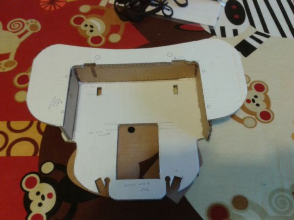

I printed out the Jivaro drawings and started 3D modelling (in cardboard again). Some cuts, nicks later I ended up with this, with plenty of scribbled adjustments to the original drawings:

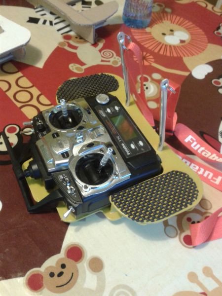

OK, I was never going to use perspex, so my target material was 3 mm ply. Fret saw and sander located, dust blown away, new set of marked up drawings stuck to my scraps of plywood and I was off. Adhesive was mitre bond, as per the last one (only this time it was thick, not medium...) and after 3 coats of sanding sealer, a light sanding and some primer and paint I ended up with this.
 8) Sits right and feels right.
I have misgivings about the neck strap, but for this tranny a flight never lasts much more than 7 minutes anyway, so not likely to be a problem.
Supports held in place with RC car body clips. Neat idea (not mine, sigh)

I can't recommend enough making a mockup out of cardboard before cutting timber (or whatever your preferred material is). This guarantees a good fit of the transmitter to the tray.
