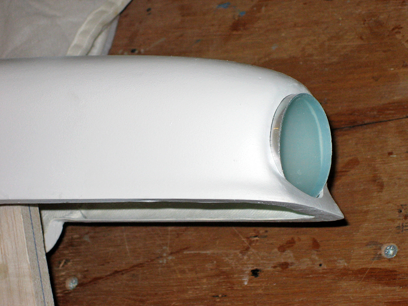

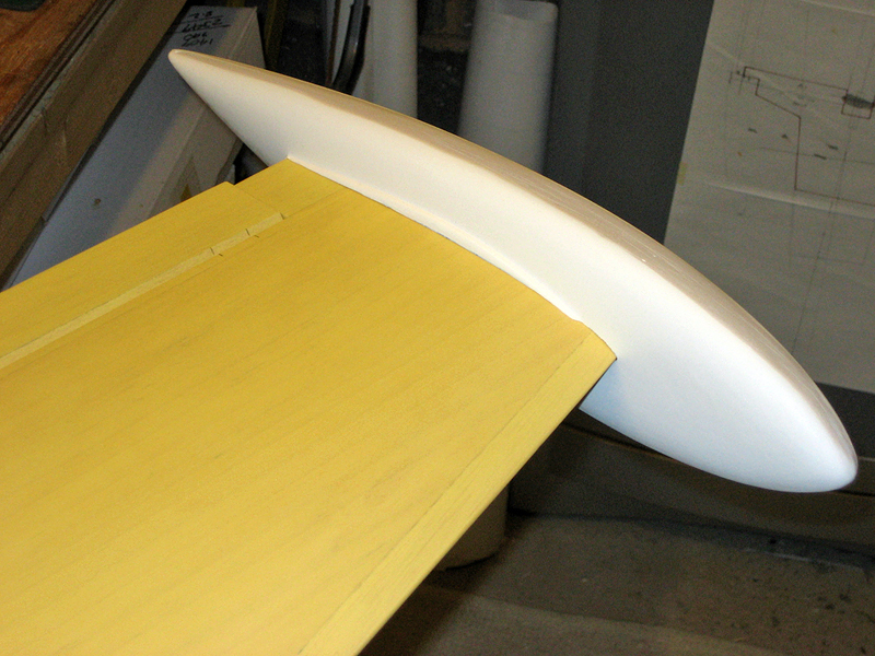

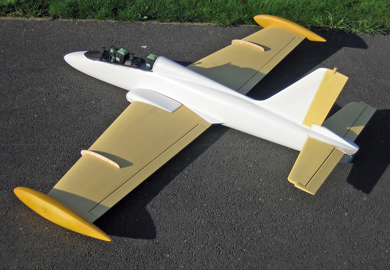

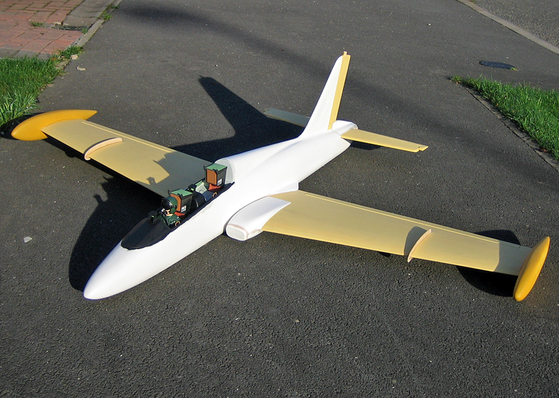

Just a few pics from my Island Models Aermacchi MB-339 build, which I'm hoping to have finished in time for the October PSSA Event on the Great Orme, Llandudno!
All the major construction work is complete, I've made a few minor mods to improve robustness and scale profile but basically it's a stock build from what is an excellent kit.

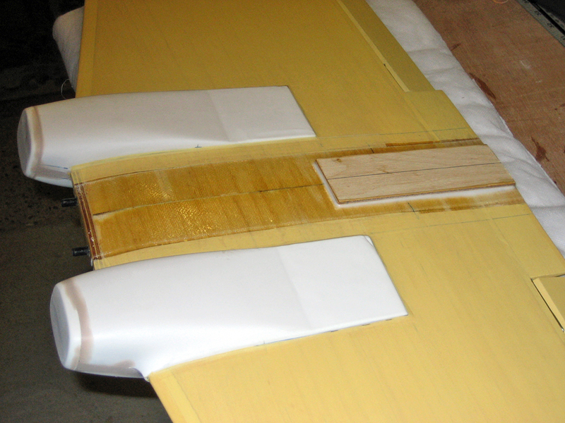

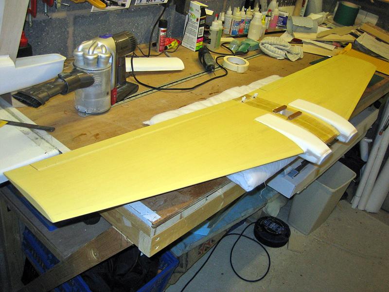

The veneered foam wing is effectively complete, here covered in antique Solartex ready for paint...

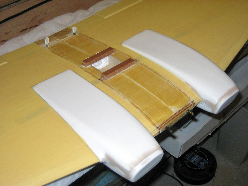

Wing root detail showing servo bays and vac formed air intake mouldings in place.
Underside of wing showing the large ply load spreader I've added for the wing bolt...
Wing tip pods are all complete, ready for paint - retained with little magnets on the tips and on a former inside the pods...

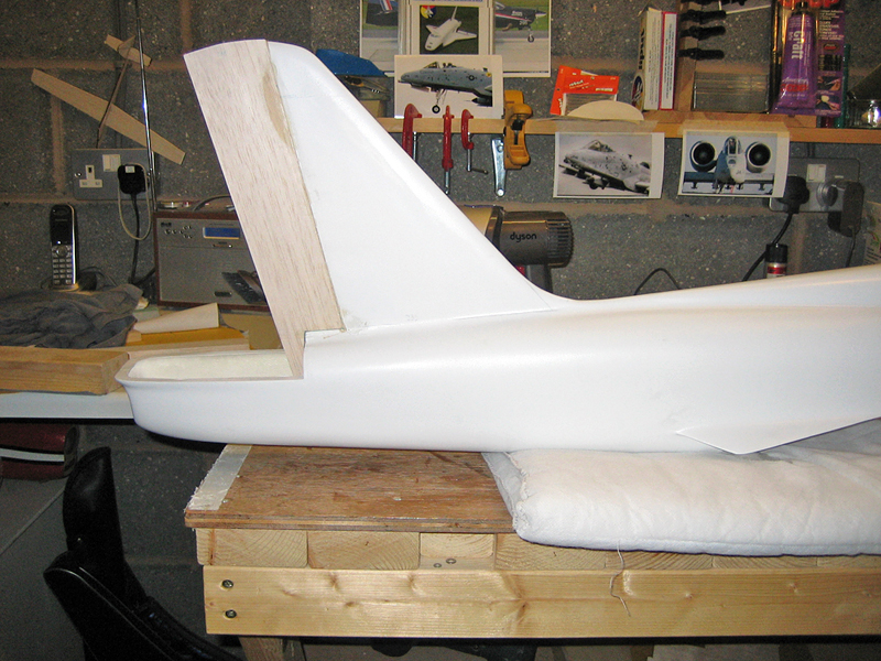

I've cut the moulded fin back a little on chord and added a (fixed) balsa rudder with a revised profile to obtain a more scale profile...
At the back I've added a scale jet pipe...

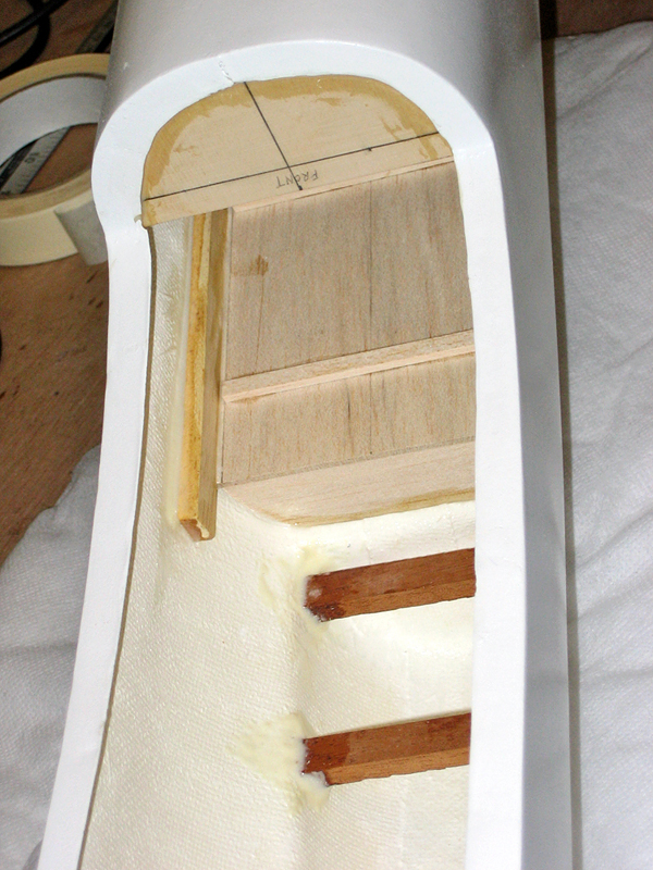

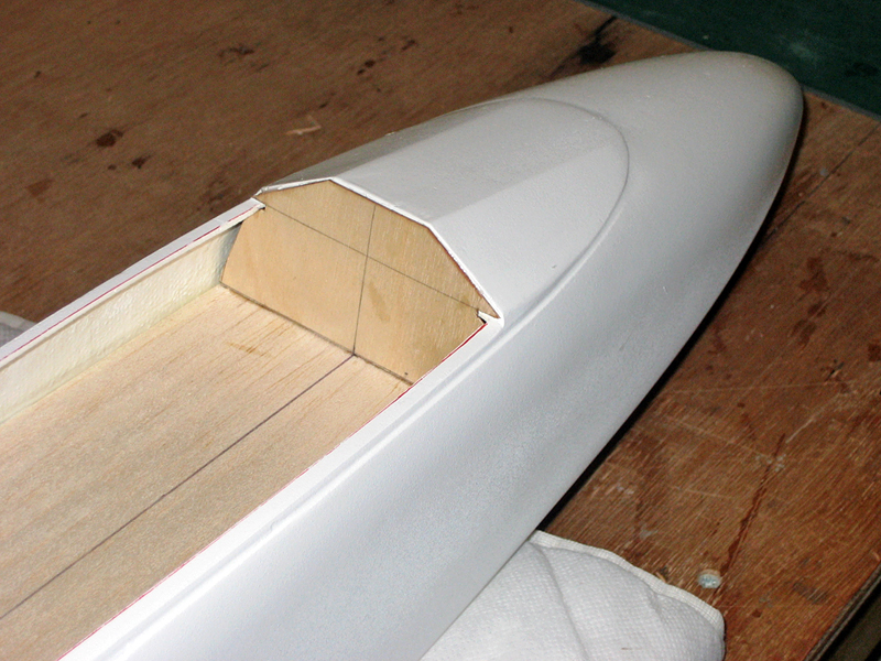

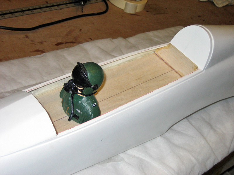

I've fitted a 1/2 depth cockpit bathtub, enabling a little more scale detail to be added soon...
This shows the underside of the cockpit floor, the forward wing mount former and the servo mounts for the elevator - fus is of excellent quality!
Pilot ready to go - just needs an office detailing now!!

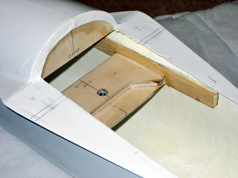

I've strengthened the wing bolt mount using 1/2" hardwood rails which extend along the inner fus walls fore and aft of the mount plate.

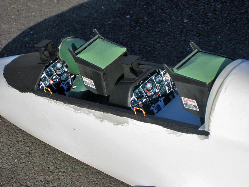

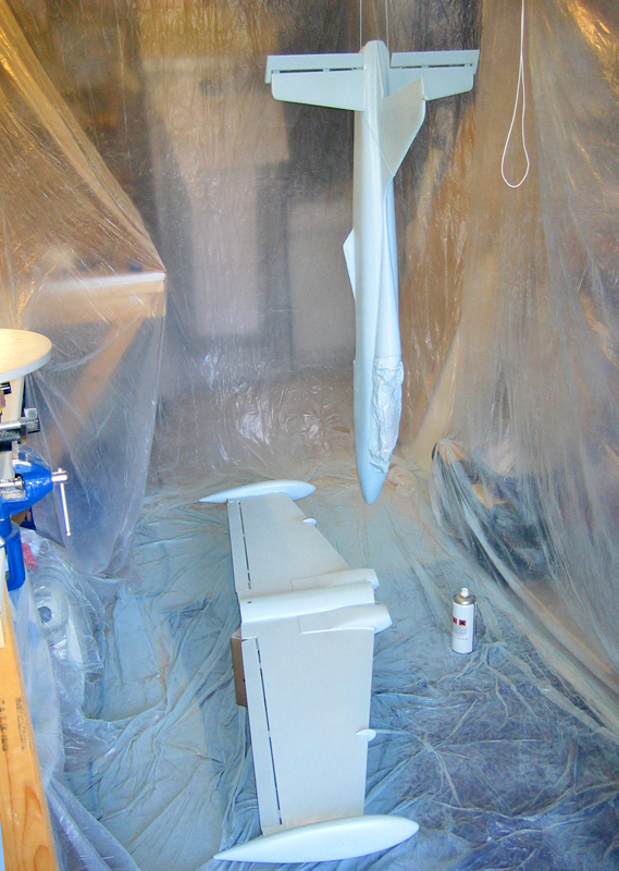

So with just a week to go until the final 2013 PSSA Event on the Orme its been all hands on deck regarding the Macchi completion, a lot of late nights after a full days work in the office has got the airframe to this stage - complete ready for paint this weekend during daylight.
Ive added a bit of detail to the office - I had intended to fit the canopy before spraying but my chosen canopy adhesive takes 24 hrs to set hard and I ran out of time... it was essential I sprayed the model this weekend in good light - so all this stuff needs careful masking now and Ill add the canopy and paint that by hand later in the week...
Ive spent some time clearing the garage of all other models and converted it into a little home spray booth with some polythene sheets... and then the fun begins!!!
This is the base coat for the Peruvian AF scheme, a darker blue will be added later today - Im just having a break from the fumes as I upload this post now... :-)
