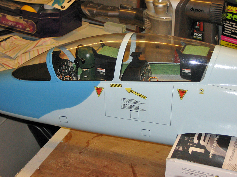

Thanks Fred, are you travelling to the Orme this weekend with John??  Look forward to meeting you there if you are!

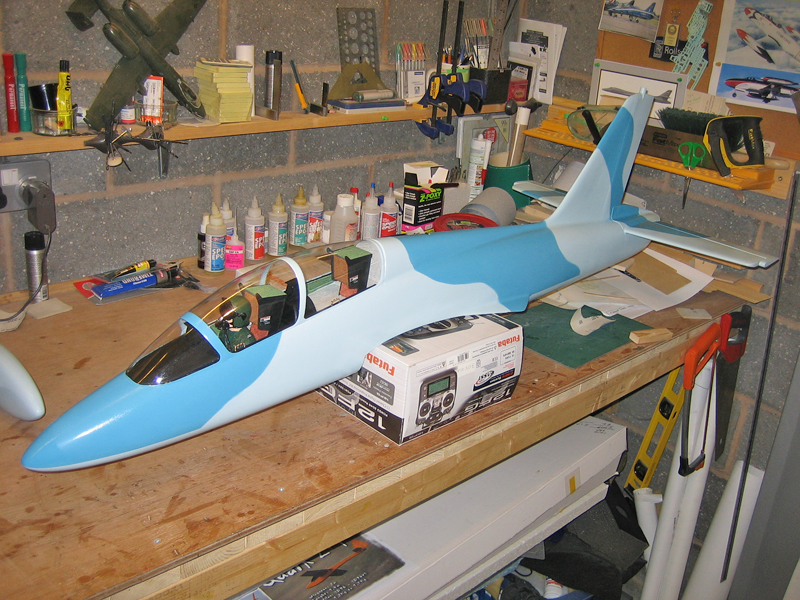

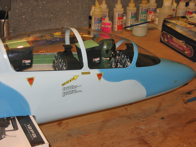

The consoles are a cheat really, Ive just stuck on a printed photo but they work well at this scale giving a 3D feel on a 2D surface - image attached in case anyone else finds it useful for future builds, or if John wants to add it to his kits - I just print them off onto gloss photo paper and trim them to size.
The seats are made from balsa and plasticard.  The canopy handles are bent from plastic covered paper clips.  Its only stand off scale but gives a decent feel for the full size.

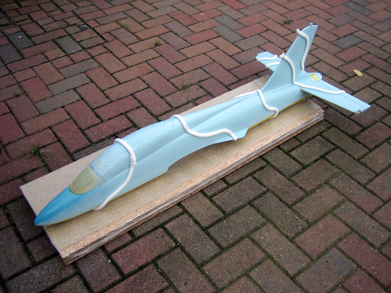

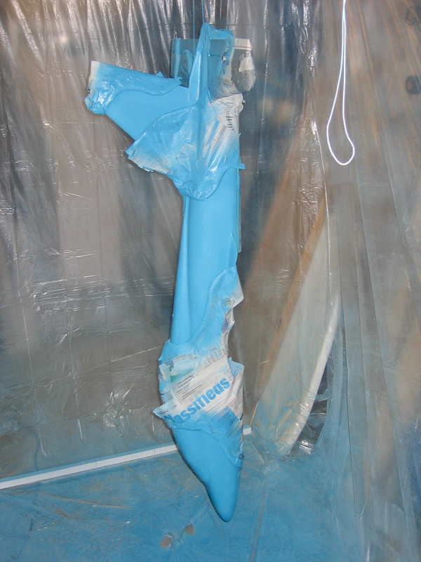

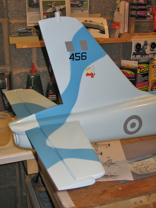

Had a bit of bother with the dark blue camo and I've had to rework it to the correct pattern as my initial attempts (straight from rattle cans by hand) led to massive overspray on the pale blue.
I treated myself to some self adhesive foam tape, 3M Soft Edge feathering tape, not cheap, but easy to use and Im glad to say its given me the camo finish I was after.
A lot of masking later and we are finally ready to paint.

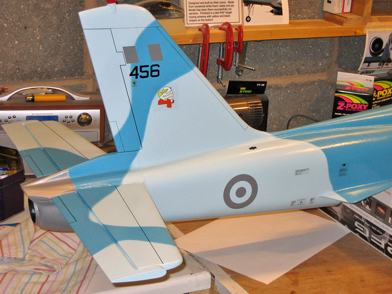

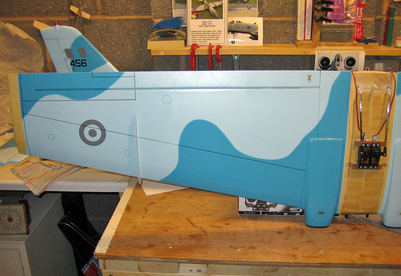

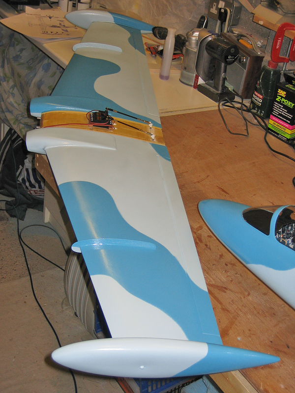

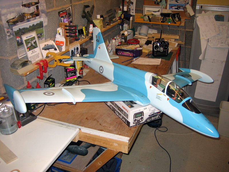

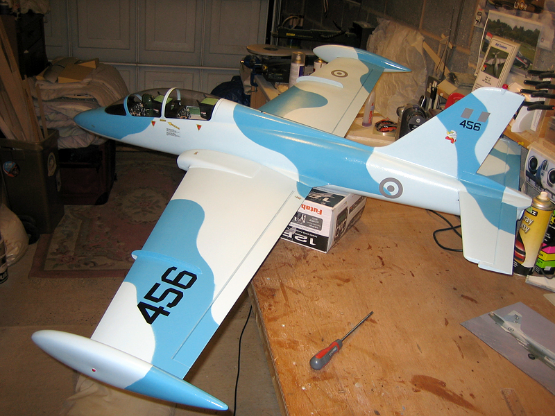

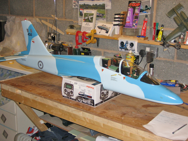

With the paint just dry I couldn't resist a few hours of decals and detailing tonight...
This is how she looked with all the masking off.
Ive applied all the vinyl cut decals and a few of the water slides... John the water slides are super, a great addition to the kits.
So this is how it looks at the end of play tonight... just a few bits of detail painting needed now, a few panel lines, and a clear lacquer over the water slides and she's s ready for the slope.  Ill add the fus strakes and some more detail after the maiden.

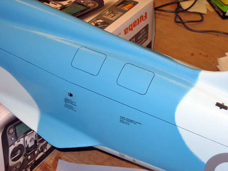

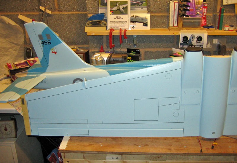

So since the maiden flight I've been working on finishing the Macchi with details like stencilling, key panel lines and a little weathering before it is all sealed with a clear lacquer.
This really helps break up the large areas of painted surface, and brings the model to life... its only 'stand-off' scale of course, the lines simply applied with a range of permanent marker pens.
Next stage is a little weathering, not too much but just enough to take the shine off the model in certain places that would naturally get mucky on the full size.  I'm still experimenting with weathering, so bare with me, I've just treated myself to a set of artists pastels, which I'm hoping will do the job!
