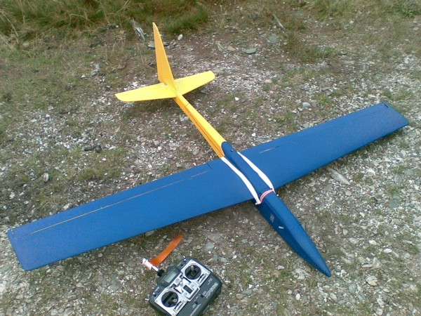

here`s my girl
phase 6 test flight
« Reply #6 on: October 12, 2008, 04:45:06 AM »
Corrrrrr! it looks similar to Joe's JART. :D  Can it break the sound barrier as well?

:lol:    yeah shes prettty slick alright, sorry bout the rubber bands  :oops: , just seemed a better option im still learning her little ways

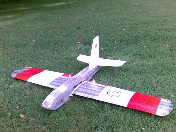

this is the ship it all started off on, shes my fly anywhere ship
the jperkins bullet
ugly but fun :lol:
phase 6 test flight
« Reply #8 on: October 12, 2008, 12:31:01 PM »
Nice!
Just love the smile on the wing! :)
Is that EPP covered with tape?

yep, its an E.P.P fuse and wing lightly sanded (for better adhesion of the tape) then covered with crossweave tape ,i put coloured packing tape on the wings just to make it a bit more visable. i also gave the packing tape a touch of a warm iron just to make it stick better, its still on  :D
but if your keen to fly something that can handle a prang or two, and your not too fussy bout the look, this or a flying wing is one way of getting started
