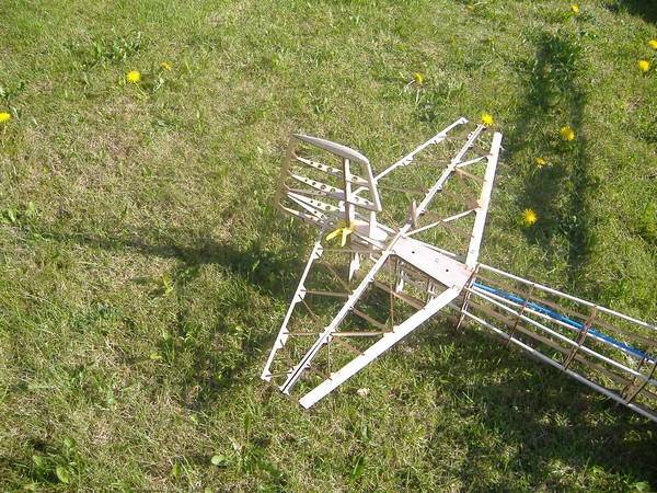

Still moving !  :D
Here is today's work, with the elevator.
All the parts :
Mostly 10mm Balsa and 2mm plywood.
As usual, everything is put on the plan. The elevator ribs are slided into each slots on the stab TE/LE, and glued... I have to admit that I used thin CA everywhere here... :oops:
Really easy...
A few adjustments are needed there and there for the ends of the ribs to fit tight...
And after... Well, not that long, you have a fix elevator !  :D
Now to the moving part !
Same as the fixed one, except this is not build on the plan, but "in the air". Same principle...
2 halves. They are then joined with a piece of 3mm plywood glued with epoxy.
Et voila !
A bit of sanding will then be required to smooth everything.
Happy, but the idea at the design process was to have a stab ready to be covered once glued and sanded... But because I want a all plywood finish, I will have to add 0.4mm on the elevator LE to apply the vanish on.
Can definitively be left as is if you go for a covered/painted finish.
So far, I roughly spend 5 hours on the project  :D
Tomorrow, back to the wings !

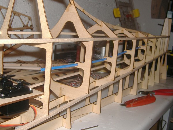

Work done on the fuselage, but this time, everything is glued !
Almost finished and ready for the servos to be installed before doing the sheeting in 0.8mm plywood.
All the formers are glued to the building template, just make sure that everything is square.
I started from the front to tail, gluing all the elements as I progressed (cockpit floor, servo tray...) to keep everything as straight as possible.
The strips are made of 5x5mm balsa.
This is the cabin template, made of 3mm plywood. Happy with that part, just the sheeting needed now !  :D
All straight !
The profile is the MS535.
Backbone is glued...
So as the bottom one (at this stage, I was able to move the fuselage around...)
Everything simply slot together  :D
And a few more photos...
Guides for the pushrod (5mm sullivan) are integrated to the formers for the elevator, rudder being a push/pull cable.

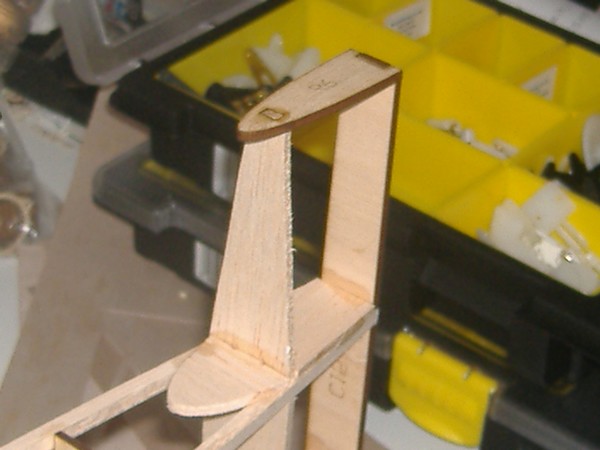

The fixed rudder squeleton is now in place.
The 0.4mm plywood will then be rolled on it to make the final shape.

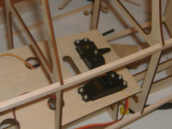

Servos and snake rod are in !  :D

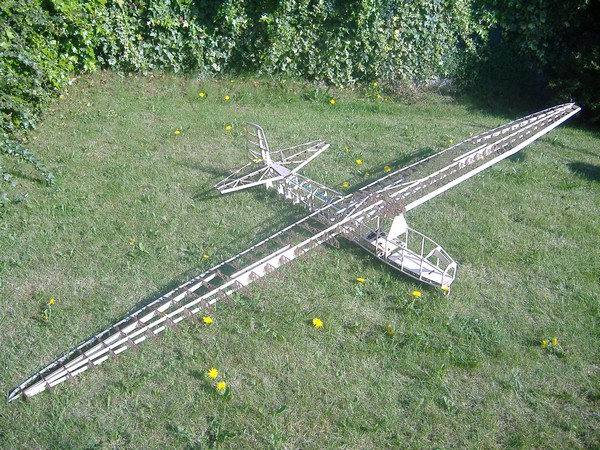

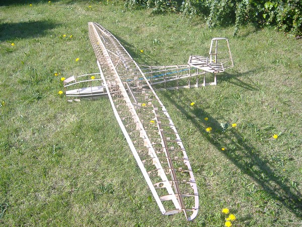

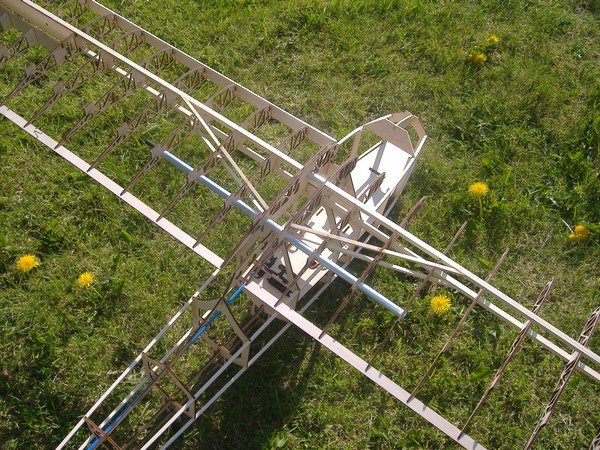

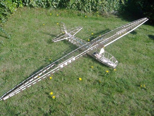

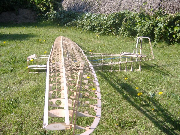

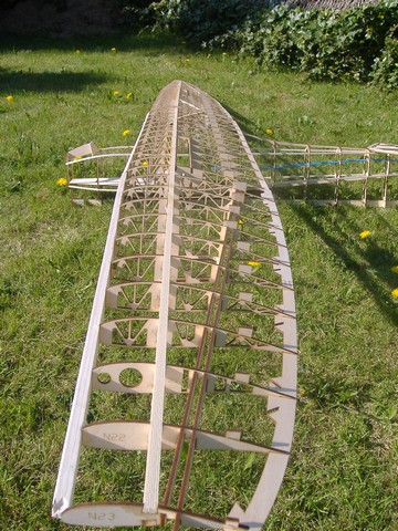

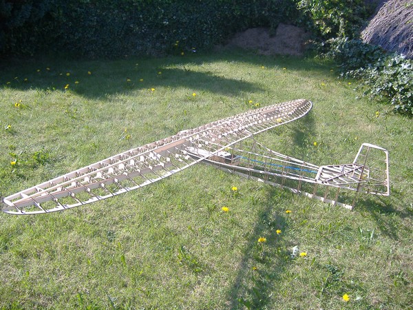

Did a bit of work this week end on the Grunau, and did the second wing...
And with the really good weather this week end, that was time for the first setup of the machine in the garden !  :D
 :D
Plan this week is to start the fuselage sheeting.. Should be relatively quick to do !
Not a huge amount of work left to be done now, a few bits and pieces...
