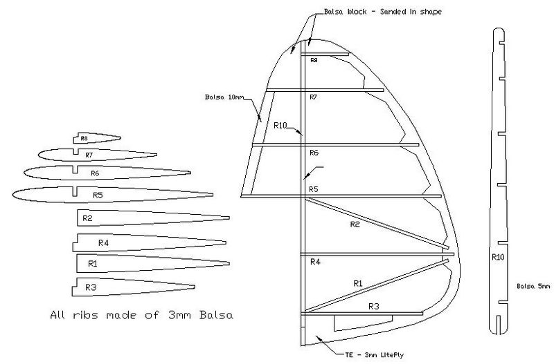

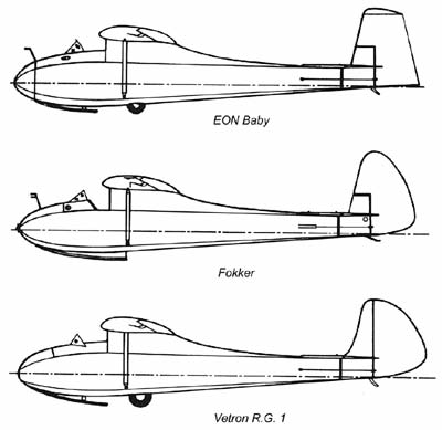

Plan for the GBII Fokker type rudder to be available soon!
If you have the Grunau Baby kit, and want to change it to a Fokker Baby, this is the plan you need.
Reference :
Plan, to replace kit's rudder :
Plans are in 2x A3 sheets, PDF format, to be available to download when I connect  :D

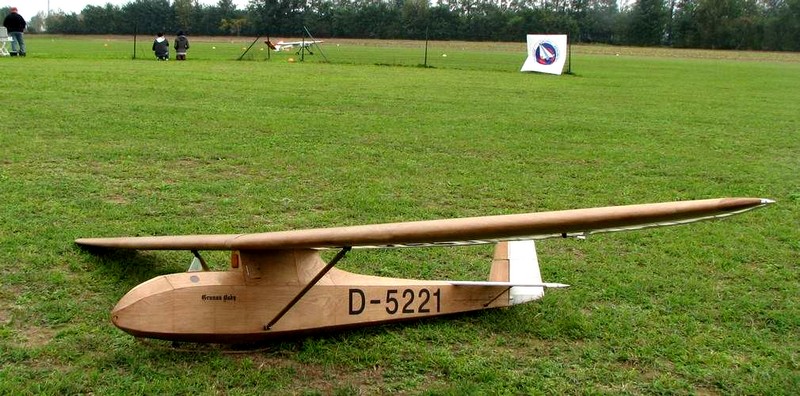

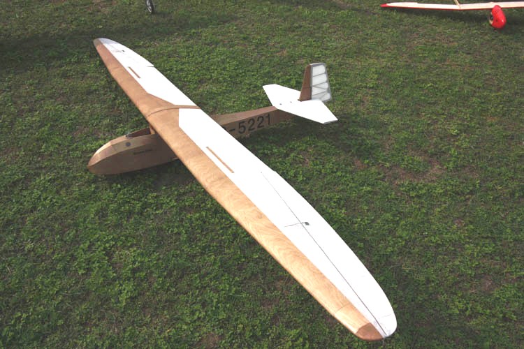

And talking about the Grunau, a few photos from Italy, of a very beautiful one  :clap:  :clap:

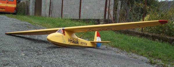

Hello !
My Fokker Baby is finish ! :D
Merci Fred, je me suis régalé à le construire et à faire quelques modifs pour faire une machine qui change de l'ordinaire.
Amicalement
Frédéric

« Reply #57 on: July 14, 2014, 19:46:42 PM »
sympa la deco
