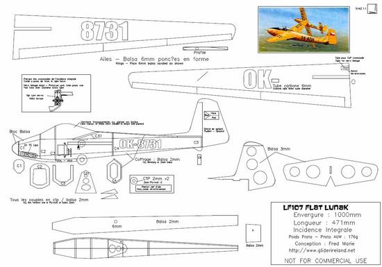

Quick build, so I'll go mini and went for a wingspan of 1mtr.
Went to the CAD program, and printed the 3 views... God, that's small!!  :shock:
Ah well, let's do it !!  :D
Quick and simple, all surfaces are scale, no cheating, but the fuselage have a bit more angles than the real one (entirely made of 2mm balsa). Rudder and elevator are in 3mm balsa, and the wings, to keep it simple, are plain 6mm balsa that will be sanded to shape.
For the controls, I went pitcheron (rudder and elevator are fixed, wing do elevator/ailerons control), but with the option to have a moving rudder for more aerobatic possibilities...
Anyway, after 2 hours on the computer, I had a plan, just have to start cutting balsa (and good for the forest... 1 sheet of 6mm, 1/2 of 2mm and 1/3 of 3mm!
Building time : 2 hours taking my time...

And to conclude this build, Here are the plans for you to download !  :D
Plan in A1 format - PDF
http://www.gliderireland.net/files/flat-lunak-A1.pdf
Plan in 15 A4 sheet to assemble - PDF
http://www.gliderireland.net/files/flat-lunak-A4.pdf
Have fun ! And if you are going for it, don't forget to post photos!  :D

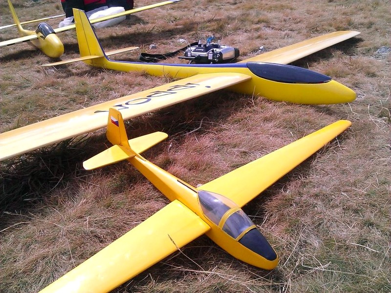

Ok, time to bring back this thread from beyond the grave!  :D
Received some news last week of a succesful flight of the mini Lunak from a flyer at the Menez-Hom  :clap:
No issues with the flying, and a great build! (much more scale than mine  :oops: )
Here are a few photos, and I hope the author will describe the flights a bit more with us  :D  :clap:
