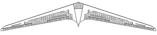

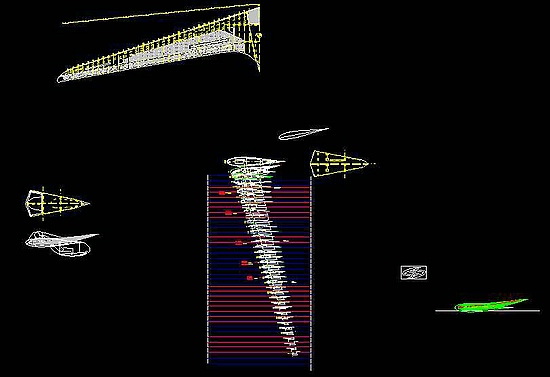

So here we are. First of all I made a drawing of the wing:
Afterwards I imported the profiles to CAD and made the drawings of the ribbs. Well, this is a longer story. Especially the unusual Center-section has it's geometric problems...
That's, how it looks on my computer:

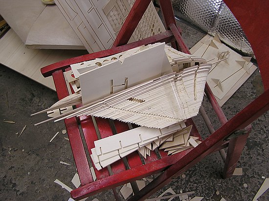

After some weeks of CAD, it's time for the milling maschine to get busy.
Here is the result:

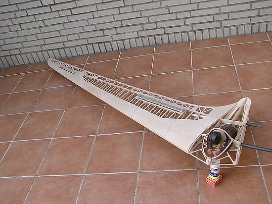

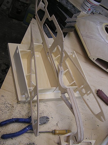

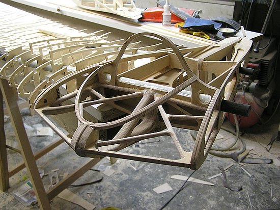

Hy friends,

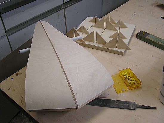

the last days I started building the center sections. There will be two of them. Of course one built as scale as possible for me, have a look here:
and, because I have no slope and don't want to depend on a tow, an "experimental center-section".
This one will get a motor with a pusher-prop. So I can learn to fly this plane in my area, somebody from Argentina called it "German Pampa" :wink:
Regards
Lothar

That looks great Lothar  :clap:  :clap:  :D . Did you use Compufoil or Profili for the wing ribs?
lothar4862
  • Posts: 60
  • navigare necesse est
Horten XIV building thread
« Reply #4 on: August 27, 2009, 14:16:55 PM »
No Alan,
none of them. We design the wings in "Nurflugel.exe" from Frank Ranis. This program is able to export the profiles to dxf-files. With those files I draw my ribbs. Every ribb is different from all the others bcause of the not linear washout and so on.
The whole thing is complicated for me to explain it in german, so please don't ask me for this in english :oops:
Regards
Lothar

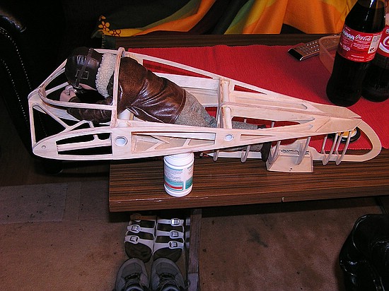

« Reply #6 on: August 28, 2009, 22:39:25 PM »
Hi there,
the last days I worked a bit on the Scale-center-section. My Pilot Guillermo made his first test how he will feel in the plane. The prone position is a bit new for him, but he feels ok:
I also glued the first ribbs on the building board and checked, if it compares good to the center-sections:

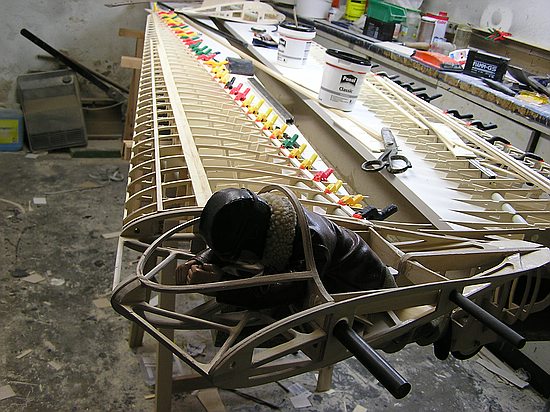

Here we are:
all ribbs are glued to the board. The spars of one wing are assembeld:
Regards
Lothar
and now back in airplanes ;-)

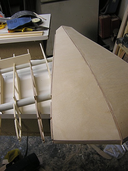

« Reply #10 on: September 02, 2009, 20:45:42 PM »
Well,
today the other wing is at the same point as the right one was on the last picture. So all spars are done. The worst job on every wing for me is to make boxes with the spars to get real strong beams.
So I decided to plank the upside of the right wing first.
Here is the result:

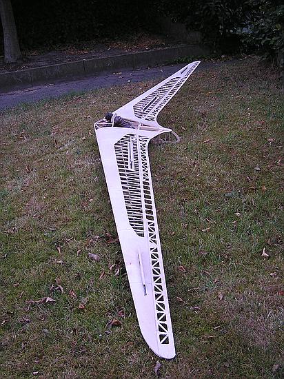

« Reply #12 on: September 08, 2009, 19:30:25 PM »

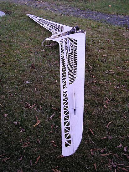

Here we are:
both wings are ready covered on the upper side. This allowes to put the whole plane together and make "beauty-pics":
Now I have to save some Euros for servos and other stuff, before I can clos the other side.
Regards
Lothar
