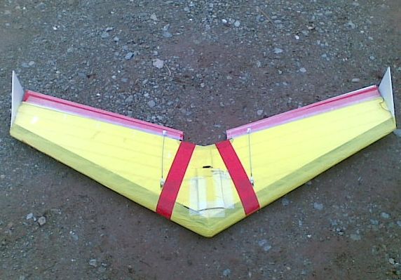

« Reply #9 on: March 06, 2010, 15:50:06 PM »
hey folks ,
                just back from test flying my zagi............ woooohooooo  :lol:
great fun , had to dial in a nice bit of expo on the ailerons and elevator but its grand. i had a buzzard and a hawk for company for a while (showing me how its REALLY done ) but they dissapeared (obviously unimpressed)
very stable when flown gently , but it has a tendancy to rock the wings if you get a bit rough on the turns........................ still though woooohoooo :lol:
heres a picture

« Reply #10 on: March 06, 2010, 17:10:33 PM »
Yea, they’re great fund aren’t they Luke. They can take a fair bit of punishment as well.
Personally I found using dual rates was very handy. Low rate for light conditions, High rate when there is “Loads o’ Lift!”
If I may, Luke, I’ll give you a suggestion…………..fit different control rods,………ones with a double bend in each one. (As you’ll see in the picture of my old one)
The reason for the bend is to act as a shock absorber. The idea is that if  (or should I say When) the model has a hard landing the bend in the control rods will help to stop the servos from being jarred and possibly stripping the gears.
Your's is a lovely model, I’ll look forward to knocking it out of the sky one of these days! :twisted:  (Or not,….as the case me be! :lol: )

« Reply #11 on: March 06, 2010, 20:05:31 PM »
thanks for the tip keith ..............  they are bit of a pain to launch though...............grab it by the nose twist your arm around and fling !!!! im found that kinda hard .................... yeah no bother kieth , looking forward to mixing it up with ye real soon  :twisted:
