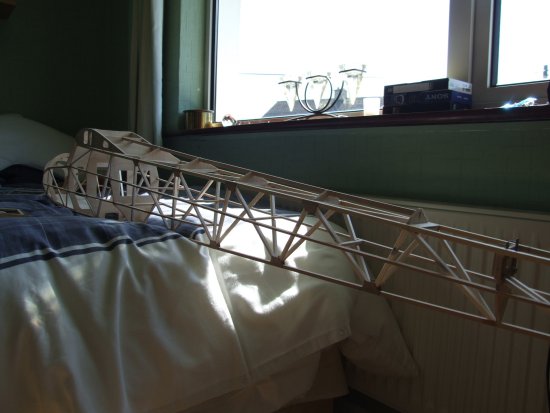

OK. I have not been sleeping the last two weeks. I have been working hard, and I have this to show for it  :D  :D .
Still have some work to do on it. Then I'll start the wings.

Good work Alan !
The building is moving pretty fast !
DGC Ka8b
« Reply #33 on: March 05, 2007, 13:08:59 PM »
Yep. Its going pritty fast all right. CA helps a lot, although I use white glue for gluing the stringers to the formers because its makes a stronger bond, I think.

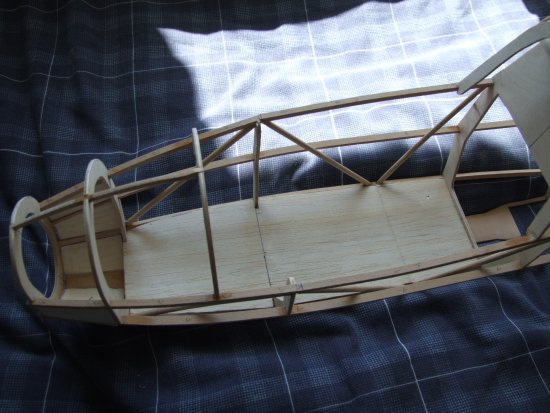

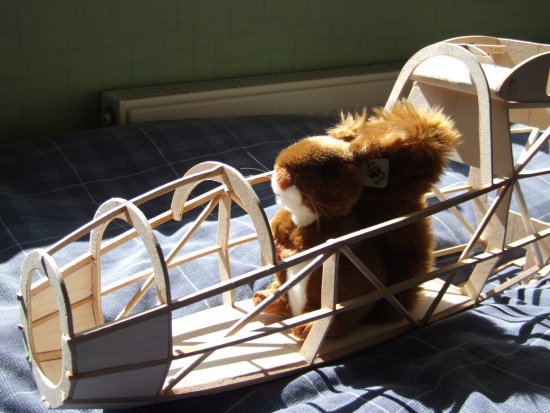

Hi. I thought I'd give Freds new image download funtion a go. I hope it works. I did a little bit more on the Fuselage. All the stringers are in and I have some of the balsa infill done on the nose of the K8. I also have the cockpit flooring in as well.
I ordered my Pilot in February but it has not arrived yet. I guess this guy will have to do  :P  :D

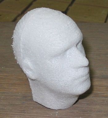

Talking about pilots, Wgy don't make your own ones   :D
Not a lot of work, and when you have molds, well, I have free pilots for life !  :D  (1/5, 1/4 and 1/3 scale)
Or, for the lucky ones (or lazy ones  :P ) with a cnc...  :
(thanks AndrĂ© !  :D )
For the cnc pilots, the full subject (in French) can be found on the Retroplane forum ! :
http://www.retroplane.net/forum/viewtopic.php?t=811
Some day, when I'll have a bit of time, I will create a page about the molding and cutting of pilots...

And really easy / quick to do !
For the clothes, well, you have to make template, cut the fabric and then glue it with neoprene glue, or by using a sewing machine if you are equiped (I try to find a small one...  :wink: )
