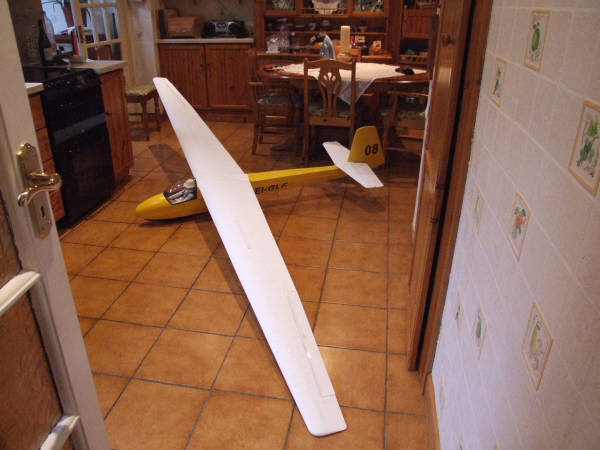

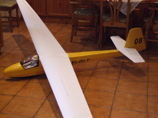

Hi Lads. It's almost finished now. I have 99% of the lead installed in the nose. Man it took a LOT of lead to balance it. The K8's weight is approximately 5kg. Is that too heavy for a 1/4 scale glider with a 3.75m wingspan, Fred? All I have left to do is balance the wings and fix the sticking airbreaks. Here are some pics of what it looks like now.
Man it looks big

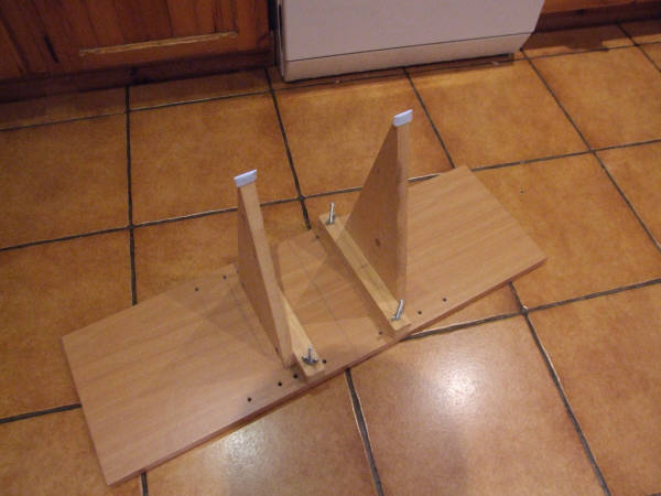

Here's a picture of my balancing devise
new glider

Hi Alan, now that's what I call a glider, great job she looks fantastic. I look forward to seeing this lady, take to the skies, soon I hope???

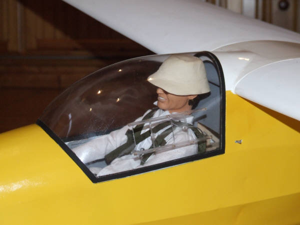

Great looking glider Alan - looks the business!  Well done.  I put a shed load of lead into the front of the B4 as well!  I guess these scale gliders are designd to have a person up front!
DGC Ka8b
« Reply #113 on: November 26, 2009, 19:55:09 PM »
Thanks Peter. Hmmm, maybe someone should make a scale pilot from Lead. That would save having to put most of the lead in the nose.  :?:  :?:

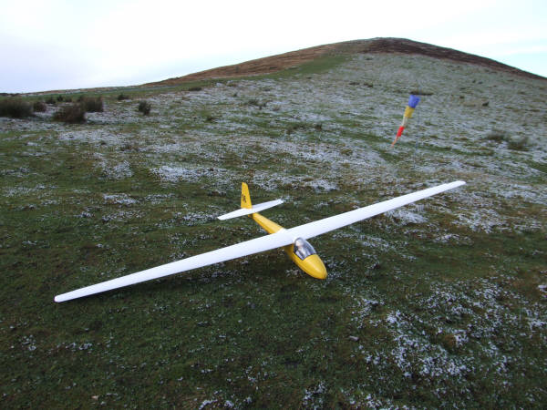

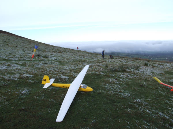

Hi All. Here are some pics of my K8 at Mt Leinster. As some of you already know the first flight did not go quite according to plan and I crashed it. But the damage was minor and has already been repaired. I think I know what caused the problem, a stupid mistake by me when setting up the glider before launch.

So, what was the issue at the end ?  :?:  Decalage ?  :?:

Do you remember before launch you told me to put in some down trim, to stop a stall just in case it was tail heavy. Well I accidental put in up trim  :oops:  :oops:  :oops:  :!:  :!:  :!:. But I'm going to check the decalage just in case as well, and recheck the CG.

Just an update. It flies  :D  :D  :D  :D, finally. I have a very short video. Its not the best quality but it will do. Thanks for the launch Peter.
[youtube]http://www.youtube.com/v/71Pfmx6Dd9M[/youtube]
I got two flights in that day. But I did a little damage to it attempting a third launch. But it will be easy to fix. It broke in exactly the same places as the last time.
