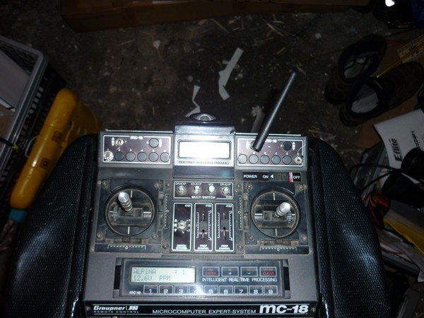

I finally moved my good old MC18 from 41Mhz to 2.4ghz using a Corona DIY module...
Install took 10 minutes, and so far, working great, but real test will be at the slope ! Weird not to have this huge antenna in front of me !  :D

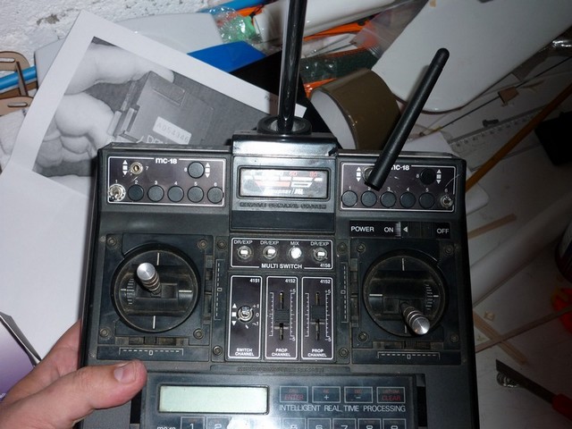

« Reply #7 on: April 30, 2010, 09:30:15 AM »
By the way...  :wink:

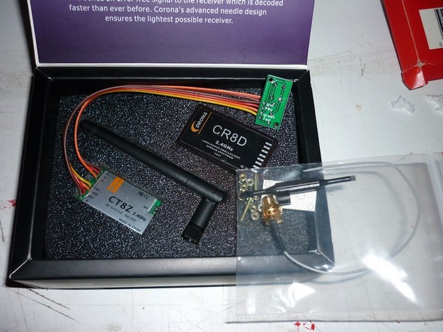

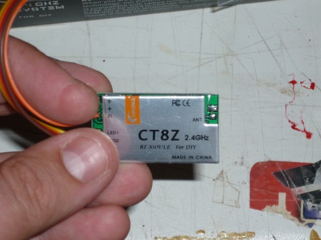

The box and content :
The 2.4ghz module... And where to solder the antenna  :!:  :!:

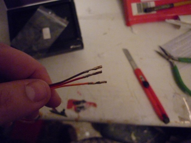

I used servo connectors at the other end.

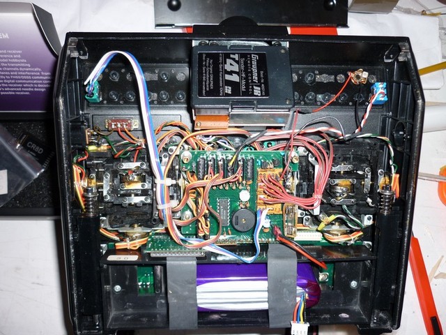

The radio opened.. The 41mhz module on top :

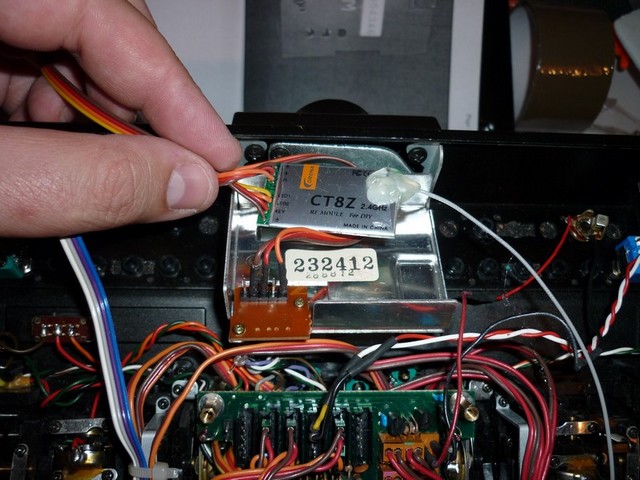

And removed. You can see the pins to use for the 2.4ghz module. At a later stage, I will certainly put a bipolar switch to allow me to switch between 2.4 and 41mhz... Or at least, I'll do it when I'll move to Jeti on the 3030...
Et voila !

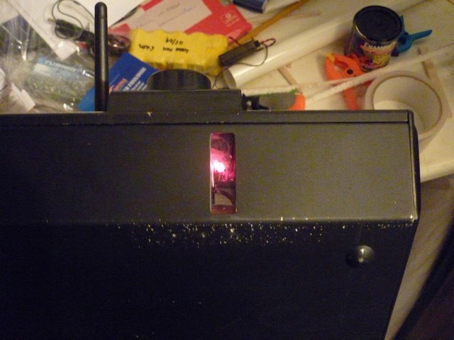

The binding switch etc  are inside the radio. I will make it on the front panel of the radio later, but that is still really easy to access, and a window allow me to see the operating light anyway.
Next stage, in flight !  :D
