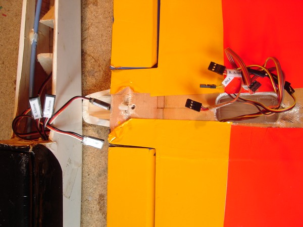

Not so much a problem as an annoyance, every time I take my Phase 6 to the slope and assemble the wings to the fus. I have to connect four separate servo cables. 2 for the ailerons and 2 for the flaps.
On more than one occasion I’ve fitted the wing only to find one (or more) of the servos has been connected up wrongly, EEERrrrrrrr. :evil:
Where can I get a single connector that would enable me to connect all the wing servos at once and be sure they are all connected correctly? :?
Hi Keith,
I am using these http://brchobbies.com/?page=shop&action=additem&item=1032
for my Spirit.
In theory you may fit four servos into one 6pin connector.
added:
found the picture
http://static.rcgroups.com/forums/attachments/2/3/6/5/5/a346038-46-wiring%20harness%204.gif?d=1101278566

Hi Keith,
You can also use DB9 plugs (for computers), easier to solder IMO, but much bigger!

Thanks Fred, I ‘take on board’ what you say about a larger connector being easier to work with.
The total space that the connector, (that is both halves of the connector joined) would have to sit in is 35mm x 40mm. Would a DB9 if in that little amount of space?

Quote from: "Happy Days"
http://www.maplin.co.uk/Module.aspx?ModuleNo=1113&OrderCode=RK60Q
Overall length:   31mm
