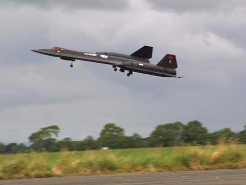

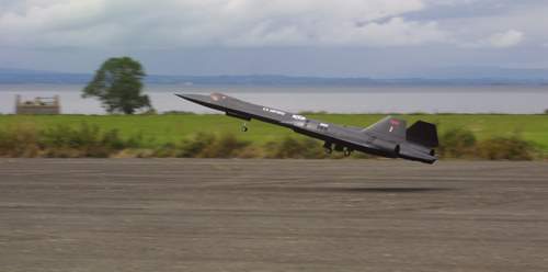

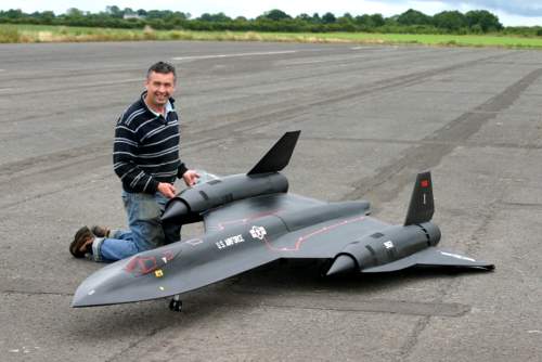

Hi all
Just back from the LMA show at Duxford held over the weekend. Ian robb rolled out his new SR71 Blackbird turbine jet and taxied the model along the runway in front of the large crowd. The model is not allowed to fly until the test flights are completed and a CAA cert approved, which hopefully will be within the next few weeks. Ian and the team were kept very busy answering questions on the model and even met two US Air force staff who worked on the real SR71 which the model was based on.
Here are a few photos from the weekend :

« Reply #9 on: August 01, 2010, 19:25:45 PM »
Hi Guys
Quick post today, the SR71 completed it's first test flight, all went well with the model and it flew great.
Well done Ian Robb

« Reply #12 on: August 02, 2010, 05:29:27 AM »
Well, I listened very intently but I couldn’t hear any sonic boom, :lol:
Excellent looking model, must have been great relief to get it safely back down on the ground. Well done Ian :clap:  :clap:
SR71 Blackbird first public show Duxford 2010
« Reply #13 on: August 02, 2010, 09:40:17 AM »
Fantastic video Mr. Pearson !!!!!
Well done Ian, having seen the first formers cut for the Black Bird it really is amazing the skills that Ian has as both a builder and pilot.
What a project to take on and complete in a few months.
Again well done and hope she gives you plenty of hours of flying.
