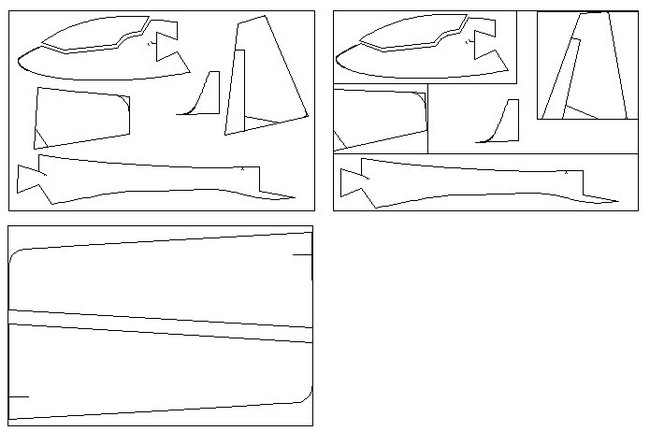

Ok, so checked with an EPP block size 900x590x150. Lots of room, and enough for 1 model, that include rudder and elevator in EPP too (my original plan used rudder and elevator in Correx).
A few cuts need to be made for the block (cutted in half, and then in small blocks for the various parts).

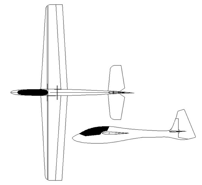

Here you go :
And a 2 views of the glider :
Of course, you can maybe make 2 minitoons or Padawan in a block (at least !) etc...
I guess we just need to find a cheap ish EPP supplier now ! I'll do a simulation for several blocks (5 or 6) and come up with a pricing. That will give us a base until we find cheaper, if that's possible.

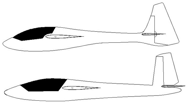

« Reply #22 on: September 03, 2010, 09:43:18 AM »
Or more scale to confuse things even further  :P
Everything possible  :D
Same fuselage surface etc, but shaped like a Swift. Just the elevator need a rework, but that's easy stuff.
Aidan

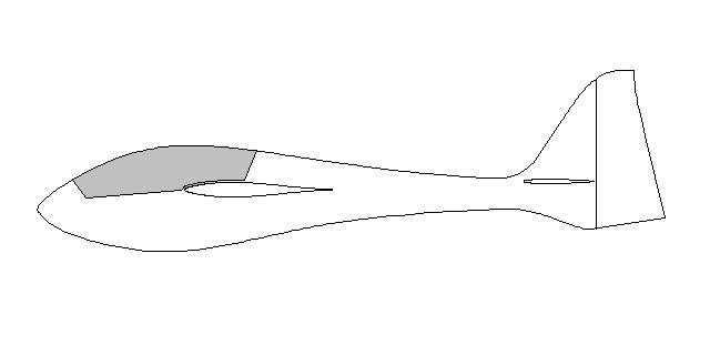

I much prefer the original fuselage.
I'll post a picture of the fuselage I had sketched in case you're interested. I hadn't done much work on wing and tail placement etc so it might need a little tweaking.
I wonder would we be better off with ailerons at a constant % of chord instead of a strip? Say 30% chord. That'll make the rigid part of the wing root narrower but should be more suitable for variable camber and snap flap. Are we going with the TP42 (root) and TP29 (tip) sections?

Here's my fuselage profile sketch. The aerofoils aren't correct.
I agree with you on the EPP weights. Fuselage should probably be 20kg. It might not be a bad idea using 30kg for the tailplane too It depends on the shape and how thick it'll be (and how it's being finished).
Would the fuselage benefit from a spar in the tail boom or do you reckon the EPP is enough on it's own? We don't want it wagging it's tail!
Aidan[/img]
