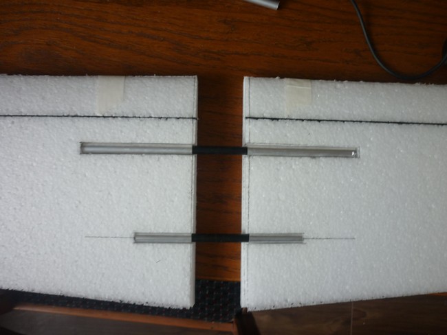

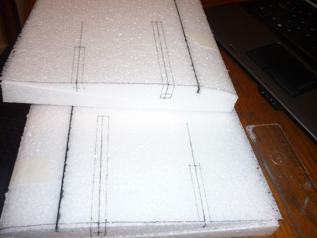

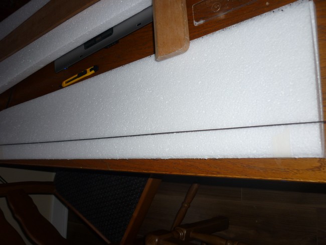

Alright, so yesterday, did a little bit of work on the Quark.

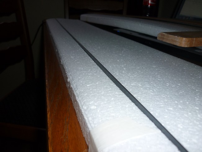

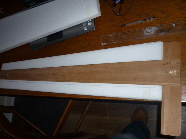

Firts, traced the line to insert the spar, on the bottom of the wing, using a big square to be perpendicular to the root.
Then, cutter, and insert the spar. Took roughly 2 minutes to do, and gives god strenght to the wing. I will add a second one on top as well.
It's inserted and then glued with thin CA.

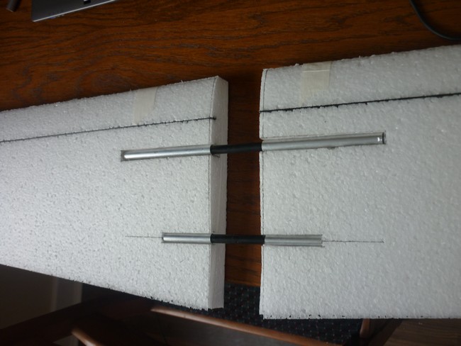

I then traced the location of the wing joiners, and cutted them.
Everything is then glued in place with the key inside the tube with epoxy and everything is checked / double checked for all these things to be level etc.

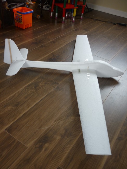

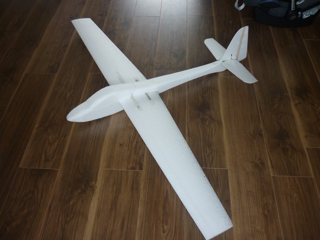

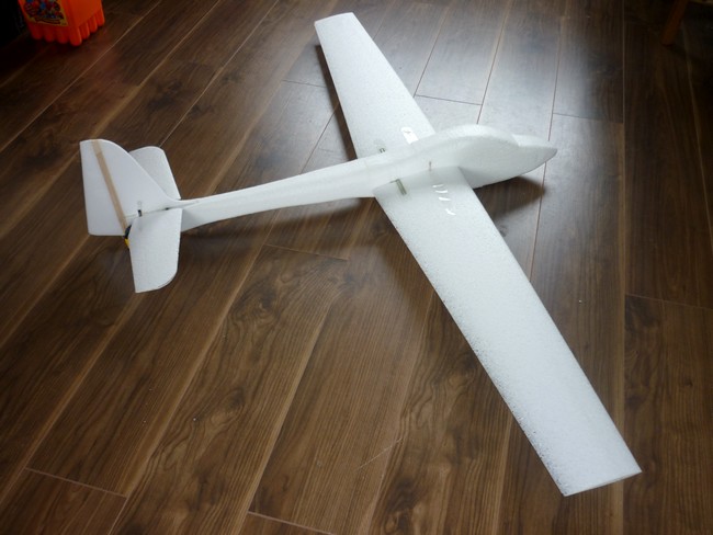

Once dried, the usual filling etc, and time to put everything on the fuselage for the firt time to have a look at the beast!  :D
Pretty pleased with the result!
This is also a very good size finally, not too big, but more important, not too small!
That glider would deserve to be bigger though... Anyone want to cut a 4m version out of styrofoam for the fun ?  :D

Fred, are you using a carbon rod for a wing joiner? If so, what dia is it? And why are you using, what look like, metal joiner sockets in the wing halves?
« Reply #92 on: February 24, 2011, 10:44:01 AM »
Hey Keith,
In the wings, they are 10mm OD (8mmID) aluminium tubes (from the local DIY shop).
Wing joiners are 8mm fibreglass rods (this is black epoxy, looks like carbone, but it's not. The bling, but cheap!  :P )
All that to add a bit of extra weight, as this is too light in my opinon. But can be replaced by a 8mm tube for extra light, and of course, carbone rods if you want to.
That just add 50 ~ 60 grs extra like that.
