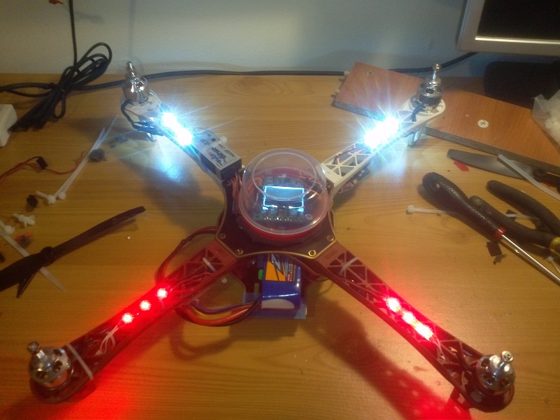

finnally I'll be installing some bright colored leds that will make it look something like this and allow to fly it at night. :)

That's my plan as well, if you check the last photos you'll see i attached a cheap gum cam to it to try.
I think it's pretty stable for such a cheap build.
The gyro sensors give some counter action to unexpected movements but not having extra sensors there is no position and altitude hold or auto level feature. But that may change in a near future. ;)
