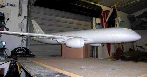

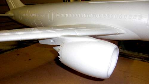

Hi Guys
Well, another PSS for next season, has just arrived today in the workshop, thanks to Richard. The model is the PSS version of the Windrider Boeing 787 Dreamliner, an all foam quick build airliner rc model.
Wing span: 1.65m
I will update this build along with the other b57 build soon! Here are a few pics after 10 mins out of the box!!
Johnp
787 Dreamliner PSS

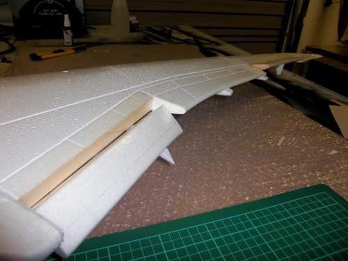

Well I started building the 787 today, with the wings. I have added flaps which are not shown on the plan, for slower landings. I may add a split flap system like on the full size aircraft :?: need to think adout it. I have also added carbon rods to the outer part of the wings and lined the control surfaces with balsa, this will make the wing stronger, yet will still allow the wing to flex like the full size 787 wing in flight.
Pic of the inner wing flap.
I will add more info soon!!

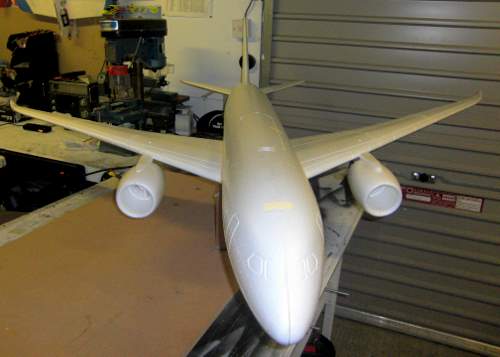

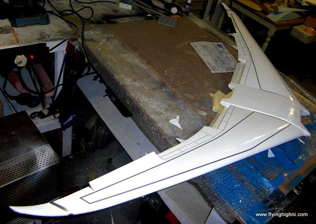

Hi all!
Well not to cold this weekend, and with no wind here in the north, I got back to some building on the 787. I finish the wings with solar film and glass tape and used trim line for the panel lines. I strenghten the wings slightly with ply spars in the middle, and strips of carbon rod along the leading edge.
Wings ready for the engines to be fitted.
Hopefully I will the model ready for the PSS at Big L :?:
