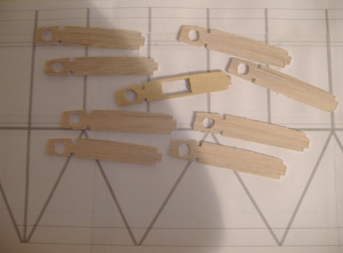

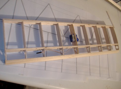

Hello there,
Back to the building, and this time with the elevator section.
Not a lot of pieces for the fixed part :
And we glue everything together ! The central rib id made in 3mm plywood and will received a mini servo for the elevator :
Then, the stab TE is closed with 1.5mm balsa, and the LE made as usual with 10mm balsa. A balsa block is cut for the stab ends, and will later receive the rudders. Et voila :
Tonight, rudder or elevator.. We'll see !  :rolleyes:

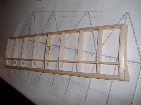

Hi there,
Here we go again, this time with the fixed rudders. First, cut the parts. The plywood is used for the aluminium tubes brackets (not sure of that word..) :
Then, nothing really difficult. Just a puzzle to assemble :
Just to have a look at the beast, and have an idea of what the finalize project is going to look like, I've setup the elevator/rudder on the booms. we can see a close up of the rudder / aluminium tube junction. Easy and simple ! :
And a general view :
Well, so far, I'm happy, and the machine is looking really good. I even start to like it !
The glider seems to be light so far, and that's good as not a lot is left to be done (sheeting, and all the moving things (rudder, elevator , ailerons..).
Almost there !
