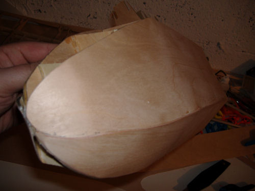

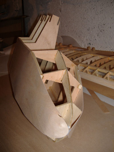

Hi there,
I finally received my plywood for the Opel !
0.8mm plywood for the fuselage, and 0.4mm for the wings.
I've started with the fuselage flanc, to finish (for the time being) with the bottom fuselage. That still give me access via the top section to the fuselage interior to install the pilot seat and so on before closing the fuselage definitively. Easy to do, but no mistakes allowed with the plywood, but by going slowly that do a perfect job !
For the struts, I've cut the space for them after I've glued the flancs. Easier that way, once again if you are carefull (using a small router) :
And that's it for now ! This week end, I'll finish the fuselage and start to cover / do the sheeting of the wings.

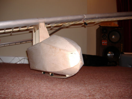

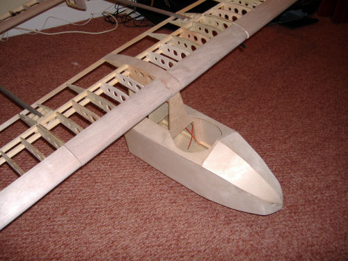

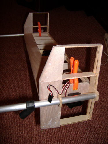

Here are some pictures :
Plywood, it's beautiful ! I think I've just fall in love with this material ! So much easier to work than the balsa !
I just have to finish the sheeting under the wings on the fuselage, but I leave it like that for now as I'm doing the servos wirering.. Just in case.. But nothing is glued yet.

More...
1 servo / rudder. you can also see the rubber, used in kites that has been modified to connect the 2 tail booms. Almost like the real one ! And simple !
This week, I just have to keep concentrated to all the moving parts (rudder, elevator and ailerons) and finish to install all the electrics cables and so on. After that, that's the finishing.
ARTF !

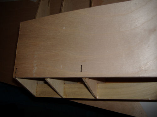

« Reply #42 on: February 12, 2007, 08:30:18 AM »
Hey Carl, welcome to the forum !  :D
Yep, scisor, with that thickness of plywood, it's hard to find a better tool !
I've found this trick playing with scisors (don't do that at home kids !  :P ) and some piece of woods... Then, I saw the light !
Very handy as I use lots of plywood for the Opel.

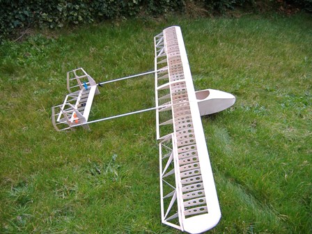

« Reply #43 on: February 20, 2007, 09:14:28 AM »

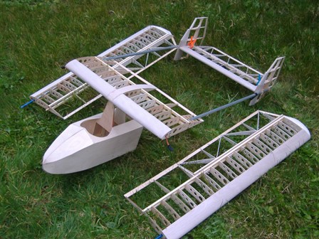

Well, after a lonnngg break on the Opel (almost 2 weeks without gluing wood... :(  ) back to work ! ARTF !
Just to give you an idea, here is the model, ready for transport... You need a bit of space, but no other solution at that size / scale.
So, this week, last week on the machine ! Just to do the electronics, covering and finishing... May be not fully ready to fly next week end, but that will be really close !
