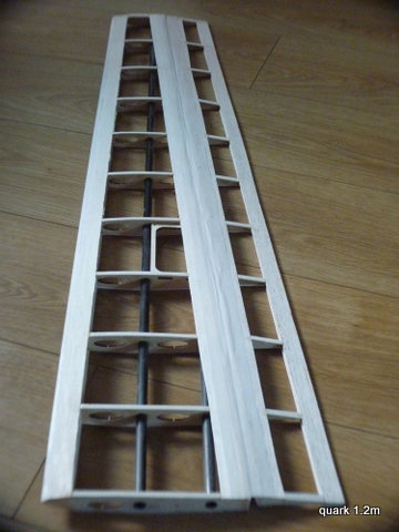

I have half a wing completed all but the aileron,
Tonite I am free and intend to do a little more work on my Quark.
We have big winds today and I wish I had of had my Quark ready to fly,
Good luck to the Brazil pilot  :clap:
« Reply #162 on: February 15, 2012, 11:46:21 AM »
Quark wing half almost complete, at last  :shock:

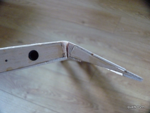

I have the lovely 45 throws for ailerons,

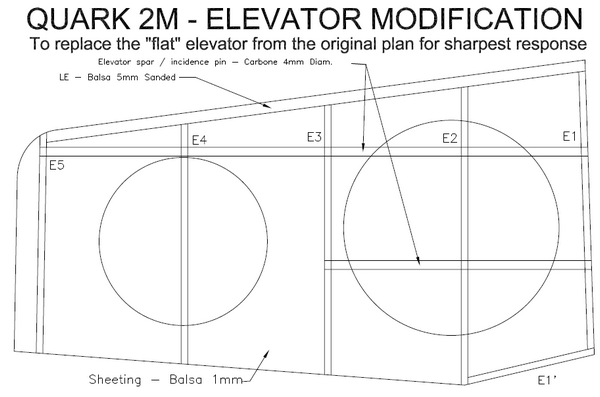

Alright, following last week end flights, I made a few changes on the Quark to make it even better! Well, that's the plan anyway!  :mrgreen:
First, and most important modification, is the elevator. As it is, it is working fine, but I found it not "sharp" enough, and compared to all the other controls, that felt a bit like a let down!
So now, the elevator have a "real" profile, and that should also shift a few grams at the back, and that's a lot at the front!
I'll start mine later, but here are the plans for the ones who wants to give it a go :
http://www.gliderireland.net/files/quark/Quark2Melevatormod-Plan.PDF
http://www.gliderireland.net/files/quark/Quark2Melevatormod-RIBS.PDF
It's a direct replacement of the one you already have, and should not take more than a few hours to make  :D
While I was at it, I have changed the way ailerons are built. No more sanding!  :D  And finally, I have added 5cm to the nose to help with the CG. All that should shift around 300grs off the glider.
