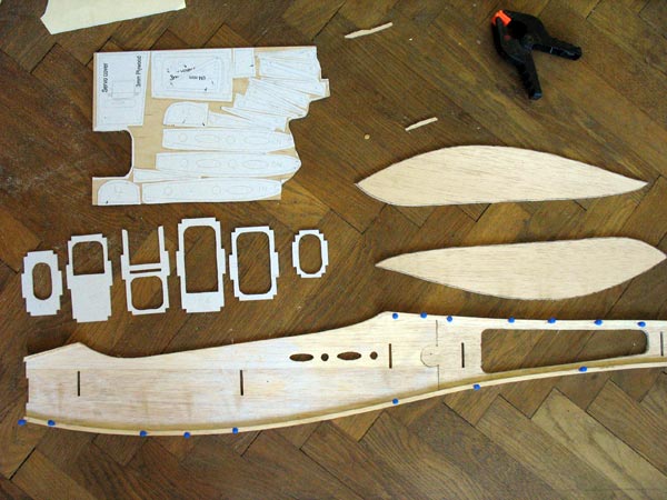

can somebody show me how rudder is connected with the servo?
and answer my questions on the picture below
thanks a lot
George
« Reply #187 on: May 01, 2012, 20:58:18 PM »
Hi George,
This is some good progress!  :clap:
Ok, for the rudder, mine use closed loop cables, but you can use Robart snakes if you prefer, but I would personaly use cables. They exit by the holes at the end of the fuselage.
For your drawing, 90 degrees on the right : Yes
Don't mind the cuts (lines) that are on the 2 long pieces named N1. They are for the Laser Cut kit!
Now, talking about these 2 parts, I just realized that I did not name them right and placed on the plan!  :oops:
If you look carefuly at the plan and the pieces, this is easy to find which one goes where : the notches on the ribs will match the correct piece if you see what I mean.
Material is : top one on the plan : 2mm plywood (that's the piece that is the ailerons LE)
Bottom one : 3mm plywood (that's the piece that go at the end of the ribs of the wings)
This bad drawing should shed some lights  :D
Let me know if there are still parts that are unclear.
GeorgeB

Thank you Fred, I understand,  but to be sure about the rudder,
can you make a detailed photo of your tail and servos please :wink:
George

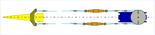

is something like this you meant about the rudder control?
« Reply #192 on: May 03, 2012, 16:34:31 PM »
Hi George,
This is exactly that. But no need to have all the stuff in the middle..
I'll take a photo of mine tonight (sorry, forgot yesterday  :oops: ).
Takes litterally 5 minutes to install

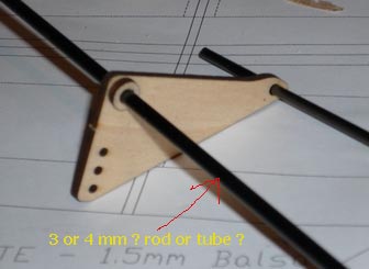

next questions Fred,
for what is this?
and this?
and I dont understand how elevators are fixed to fuselage?
They are plant into 3mm rods, and are they glued to them?
sorry for my maybe stupid questions  :oops:
