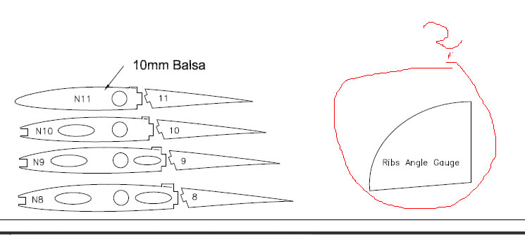

I dont undertand what does Ribs Angle Gauge mean?
Once again thanks for your answers and enjoy yours annual meeting
 :)  We have here (in Prague) rainy days and forecast isn't better for weekend  :cry:
Pictures of finished model and video from maiden flight I of course post here.
 :wink:
« Reply #175 on: April 12, 2012, 15:44:00 PM »
Hi George,
Very quickly (just heard that the plane with the Frenchies just landed!)
The gauge is to give the correct angle to the ribs and ailerons' ribs.
The Piece N1 on the plan, is put on a flat surface, then the ribs for the ailerons glued to it.
As you can see on the plan, the ribs are not at a 90 degrees angle at their leading edge!
So you use this template to have them glued correctly if you see what I mean  :?:

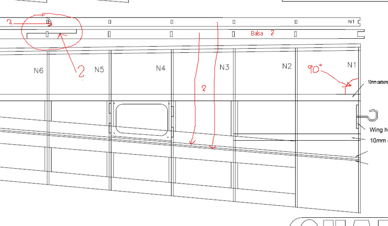

sorry Fred, I'm reading your words again and again, but still don't understand  :oops: maybe photo helps :)

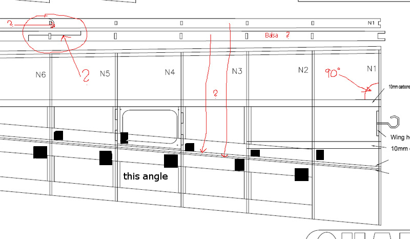

Can you specify anything else for me please :)
« Reply #178 on: April 12, 2012, 22:10:16 PM »
Hi George,
             I believe these are the angles Fred is referring to.
GeorgeB
  • Posts: 24
    • http://bionic-george.blogspot.com/
« Reply #179 on: April 12, 2012, 22:32:01 PM »
