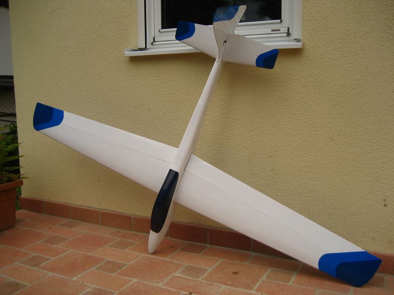

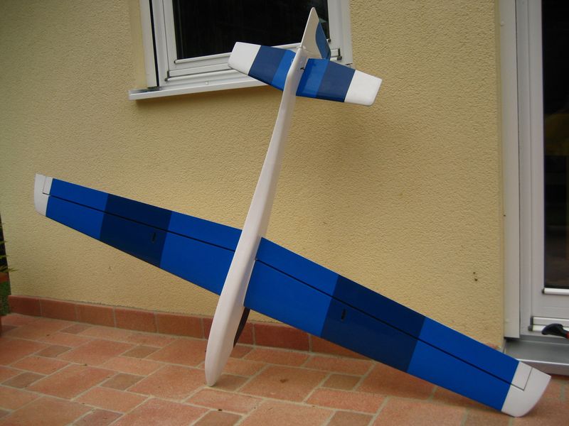

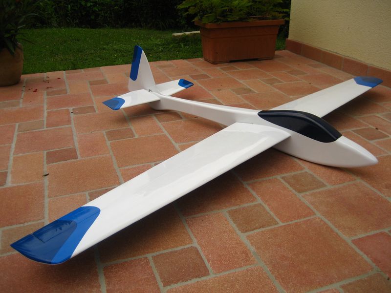

Another Quark is ready for maiden!
Although I didnt finish it before the weekend it was no problem - the weather was very british in Donovaly so absolutely no flying! Instead I took my time to get a good covering job and I am very pleased with the result (but it was three evenings work to get it all done - covering can be very time consuming... :?: ).
AUW is somewhere around 1,4kg, dont know where all the weight came from, but I also needed more lead than initially assumed... But for a fully sheeted wing and a sheeted stab it is OK, 1,2kg should be possible if desired. As I don't really like to fly in light wind I plan to add some kind of ballast to get it up to 1,8kg for the heavier days. And the stabs and wings/ailerons are really huge...!
Waiting for good wind and weather now...
Fred: please keep us informed about the flaps/ailerons version...
« Reply #243 on: June 12, 2012, 11:48:55 AM »
Now that's a nice one!  :clap:  :clap:
Very very nice Miki, great job on the finishing!
At 1.4Kgs, you are still way lighter than mine. Mine fly without any problem in light winds. The ballast option is a good idea, as I like an aerobatic glider to be not too light. More inertia on the vertical moves  :D
Fingers crossed with the maiden flight, and really hope you enjoy it!  :D

That model does indeed look beautiful. You have done an excellent job in the covering and building. Makes me impatient to start mine when the kit is available. What servos did you use in yours? Hope the maiden goes well.
Alistair

I've got HS85 MG on the ailerons and Spektrum A4000 for rudder and elevator.
Weather forecast for the weekend looks promising... :twisted:

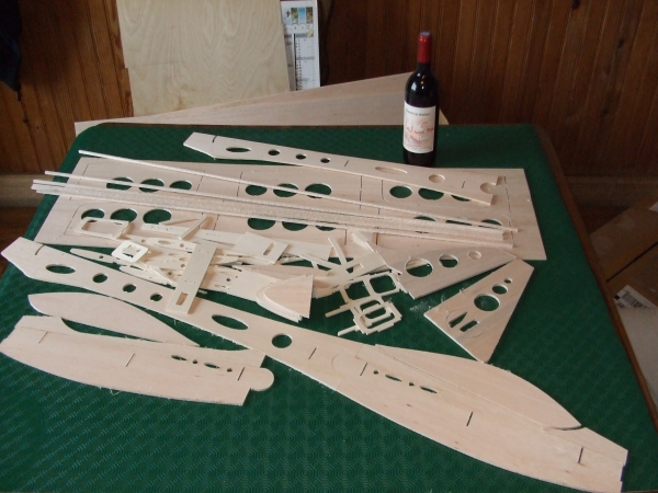

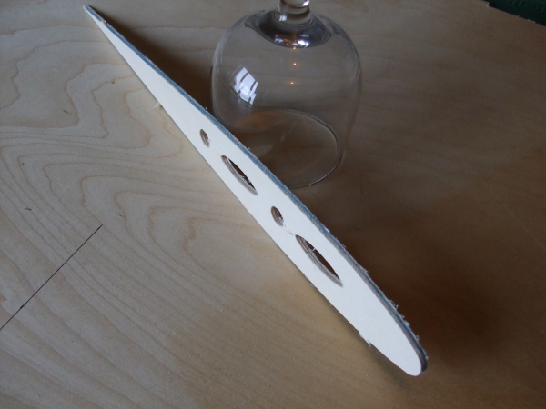

 I am pleased to present a glider directly inspired Quark2m but profoundly enhanced: The Quouèrk, by HollandModels (Correzian traditional factory). The Quouèrk (pronounced like the cry of a hen that crushed) kit is a fully cut by water jet.
 The kit:

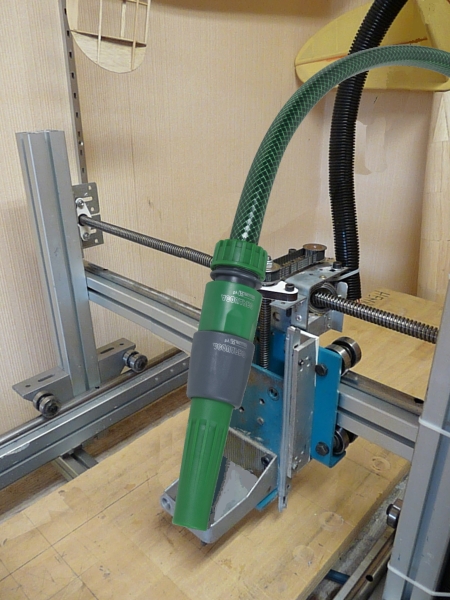

 CN with the system of the nozzle water jet cutting:
 As you can see from the picture, the water jet cutting leaves a blue mark on the wood  that fades after a few hours.
 We are doing tests CNC (Cat Natural Cutting) that appear to be very promising ... Then we would change the name of the glider: Quouirk ... (like a cat being crushed)
 Soon, the beginning of the construction.
 Note: You can not sell the kit for now, it is forbidden to send any material from the psychiatric hospital.
Big Kiss !
Frédéric
More water !

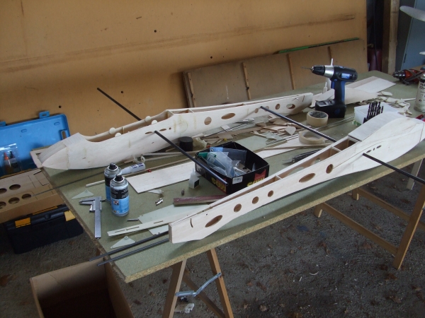

Hello boys and girls !
Today, we tried beer cutting, after water cutting at the flying club ... it does not work well, it foam too, but it makes the children laugh...
we start building our glider. In two days, our fuselages are almost complete
big kisses
Frédéric
More water !
