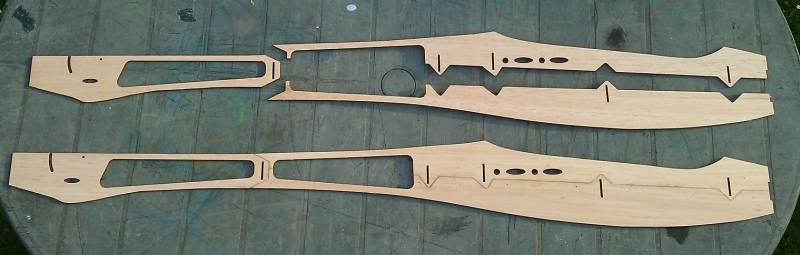

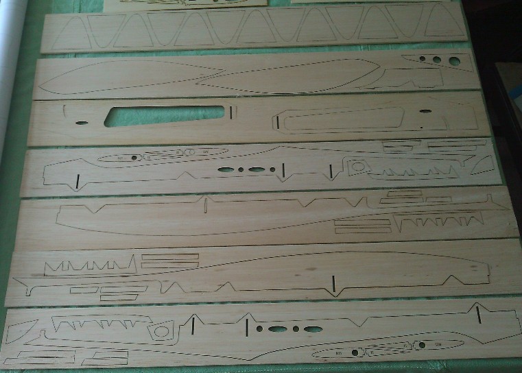

All I have seen on the Quark is good. Kit looks good. I have ordered the CF tubes and rods, the wing and fuz sheeting, the fuz longerons and the wing leadinding edge and the wing false leading edge. Hopefully should arrive soon. Hump battery also ordered as is two bottles of thin Cyno.
The Fuz is different to the website, it is 3 pieces, front top and bottom and then a rear section. The balsa sheets for the fuz are below.
Hope to make a start soon.
Alistair

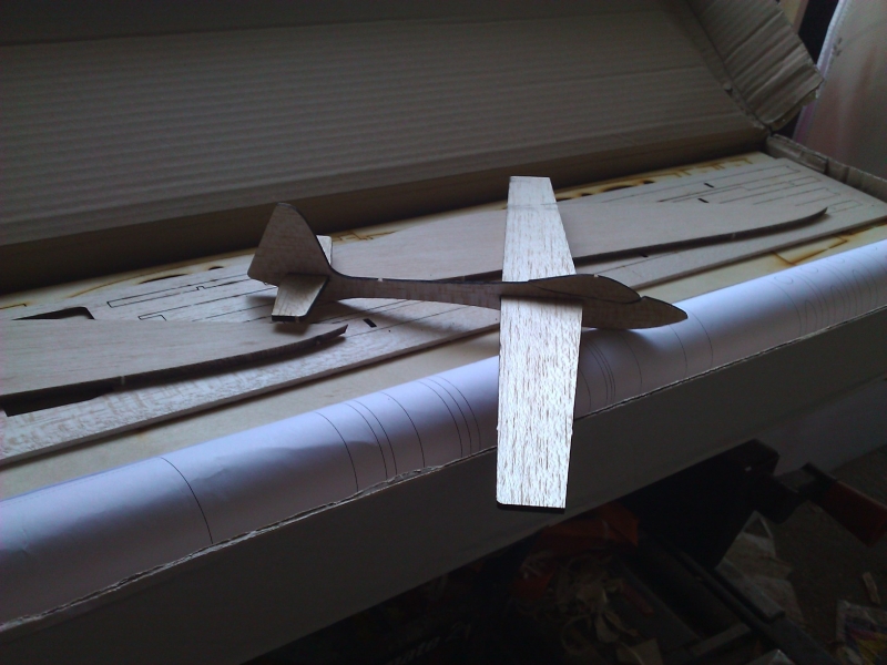

« Reply #265 on: June 25, 2012, 17:28:21 PM »
Nice  :D
That allow you to choose your colour scheme!  :D
And careful, your wing is the wrong way around  :D
Actually, never tried, but might fly (fast!) with a bit of lead on the nose  :?:
Anyway, something to bring with you in the office  :D

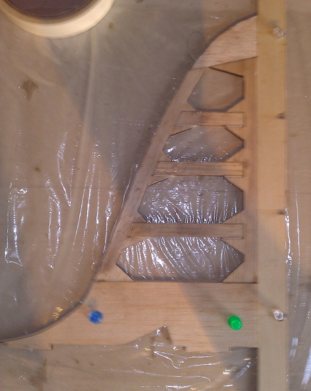

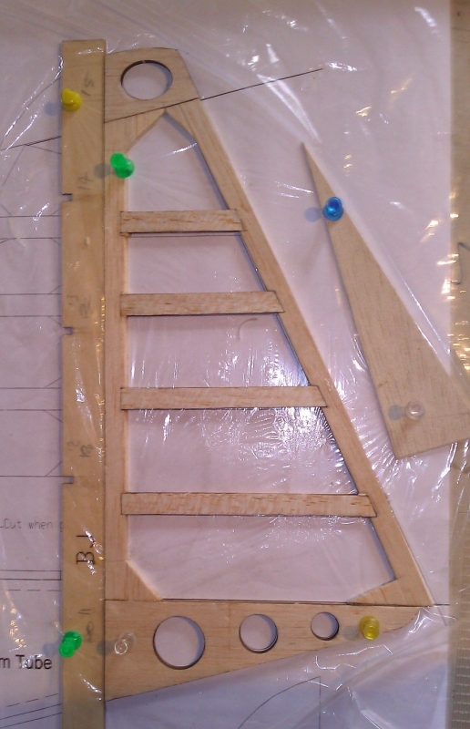

Wing is now right way round :)
Fin built, using jig from fuselage of Grunau Baby to ensure straight edge. Had to add some shims of 1mm balsa to get nice tight fit for the horizontal part of the fin.
Rudder also built though I had to make my own leading and trailing edges.
Also glued up the fuselage sides. Comes in 3 bits, fits together nicely.

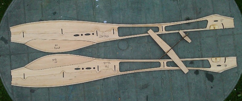

« Reply #269 on: June 26, 2012, 18:01:23 PM »
Richard,
Thank you for confirming my suspicions.
Added all the 5mm (3/16) stringers to the fuselage sides and the tail plane ply.
Marked them so to avoid building two sides the same, whcih I have done before.
Need to modify ST1 and ST2 for my servos and a switch as well.
