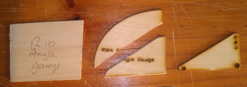

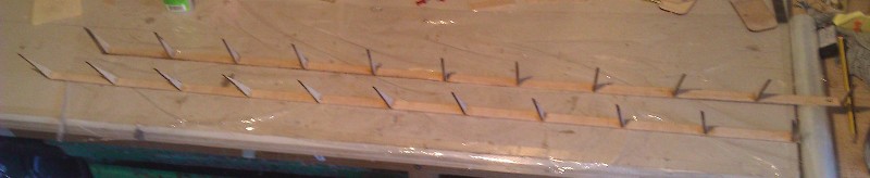

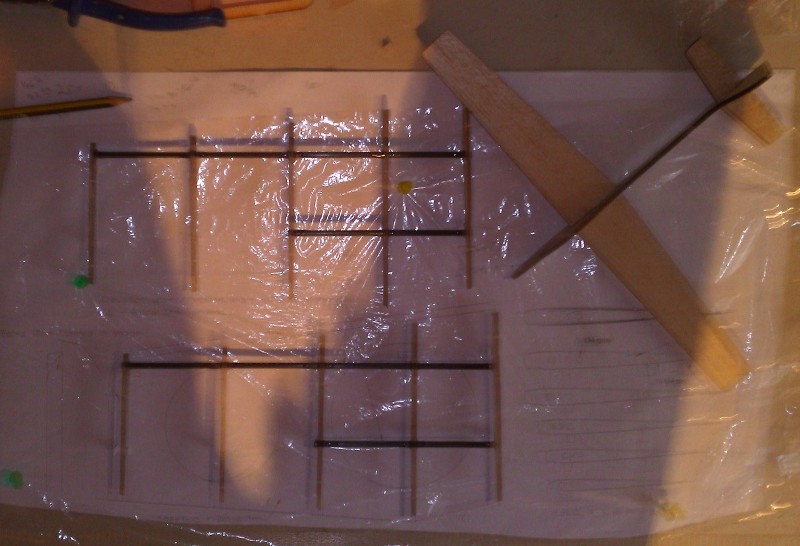

Having sanding the 3mm carbon rod to fit the tube I did the all moving tailplane AMT.
Here they are with the epoxy drying. Glad is a symetrical section as both can be built the same way. On second one chamfered the leading edge of the ribs to fit the leading edge when added.

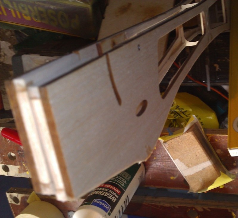

Also made the servo holes in ST1 and ST2 bigger for my servos. Added wood for screws to hold servos in and also a switch as well.
Need to add some holes for cable tie to secure the RX and another hole for the arial tube.

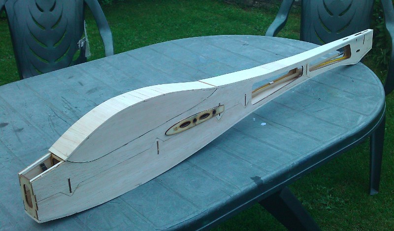

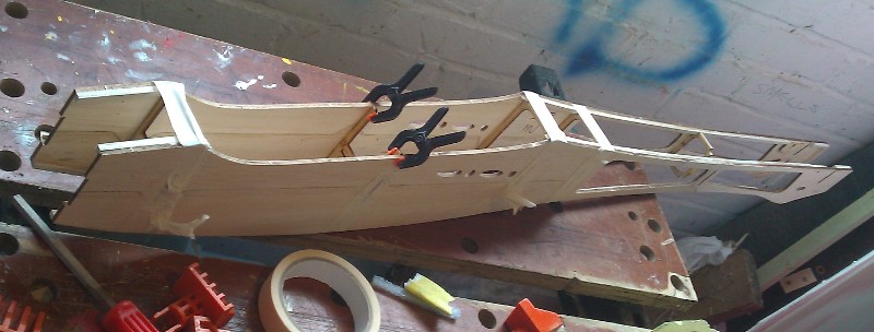

Glued up the fuselage, well formers 2,3,4 and 5.
As the nose is a little narrower I will add that former later and hopefully ensure both sides at the front bend equally for a nice symetrical fueslage. Same applies to the rear as well. I will pull it in to the last former hoping for a nice symetrical fuselage.
Because the Carbon tubes are not too accurate, the holes in the AMT horn are too large. So lets make another one. Got some of my 3mm ply and it is not as good as the ply in the kit. So only big enough piece of ply with the strength in the correct direction was the rib gauge. So made a new rib guage with my own ply, then cut the rib guage to make a new AMT horn. Hopefully means the holes will be a nice tight fit to minimise slop.

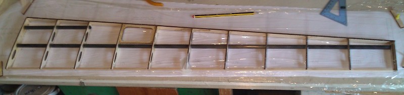

Started the first wing which was straight forward. Glue it all up and realised I had forgot the rear tube. It just slid in just fine.
Need to add the expoxy to ribs and carbon fibre.

Looked at rear of fuselage and all is not fine.
Things do not line up. It will line up with pressure, so I may line it up and then brush rear of fuz with water to hopefully remove the twist. Then glue it up. I always seem to have problems building straight fuselages.

Been cracking on. AMT is in elevator pushrod is done. Had a sticky moment when cycno stuck the AMT rod to the pivot. Fortunately managed to seperate them. All works fine. Question I assume that the longitudal declage is 0-0 for the wing and tailplane???
Note. The fuz can be twisted though it does require some force.
Added top and bottom sheeting and did the canopy. I will add nose later once I have a rough idea of how much lead I require to balance.
Joining the two halves of the aileron leading edge was tricky. Decided to use balsa dust to make a nice fit and wick in cyno. Seems to have worked fine. Add the ribs using the rib guage took a while.

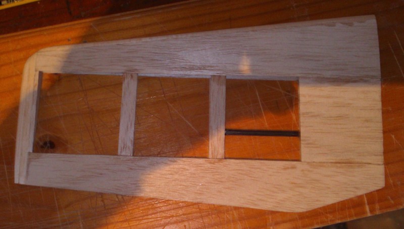

Sheeted one half of the tailplane. Took a while but I think worth the effort. WOuld have been quicker to completely sheet it.
Think it looks OK and weighs in at 19.5 grams.

It is an easy model to build, all the hard work of cutting accurate formers and ribs has been done. Everything just fits nicely. Nearly as simple as fit it together and drop in some cyno. For wing sheeting I use impact adhesive on the big bits, cyno on samller ones and PVA for leading edge. I do like hardword false leading edges, makes it very easy to sand the front of the wing nice and straight to get a good fit for the leading edge.
Decided to do wing as per plan rather than fully sheet, mainly because I can not join sheets together. Also even without any sheeting wing is very strong and does not twist.
Seems stock wood for sheeting is 3 inches as that is the size of the D sheeting. The sheeting at the rear is 3/4 inch, which is one sheet 3 inch cut in 4! Clever design Fred!
Here is the port wing.
