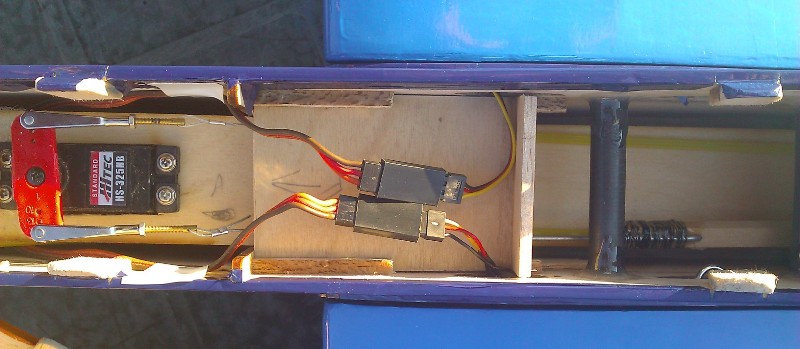

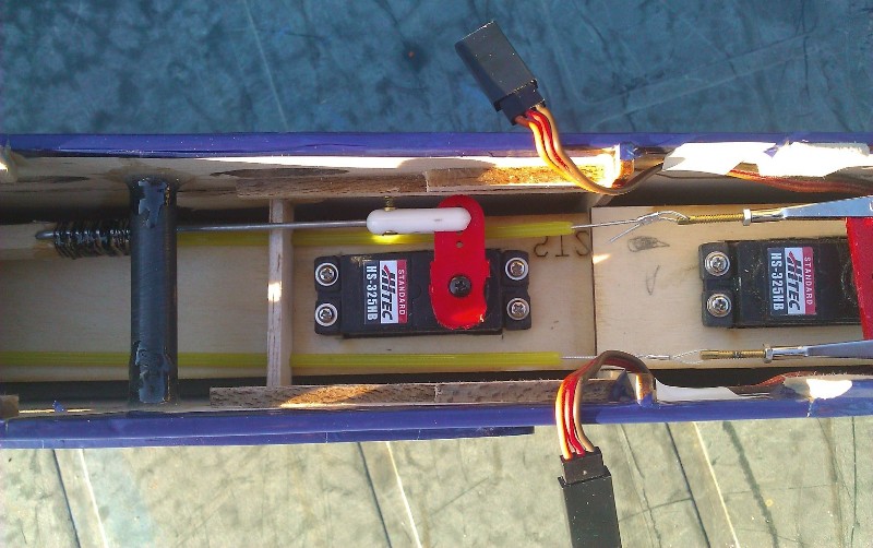

Here are the servos in the fuselage. I added old snake inners to ensure the rudder push pull cables do not interfere with the elevator push rod.
Also so as to ensure aileron servo leads do not foul the eleavtor servo added a shelf that goes aboe elevator servo.

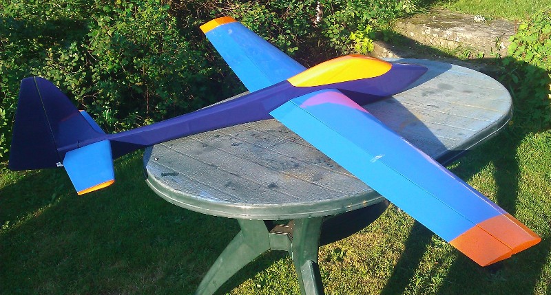

Here is the nearly finished model.
Camera not to good as the canopy is orange as the tips are as well. Mind you yellow looks quite nice!

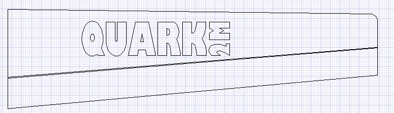

Good thinking on the logos!
Was working on some following your email, so here is a few ideas :
On the wing to have an idea of the size :
Of course, all open to suggestions / ideas  :D
I can provide PDF or even PS files for these ones

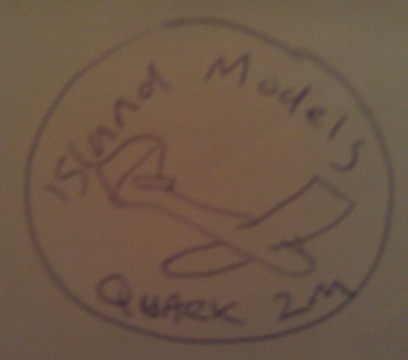

Also I do like the silhouette of the Quark. So how about a smaller circular logo for the fin/rudder. Perhaps the silhouette of the Quark with Islands Models text around it on the outside.
Here is one I drew (please don't laugh to much) drawing is not my skill.

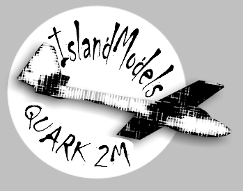

For stickers, work in progress!
For the rudder, took your idea and that gave me this :
Like it a lot actually!
There might need some tweaking but this is looking good  :D
I am preparing the files for you, they will be available soon! (working on it)
