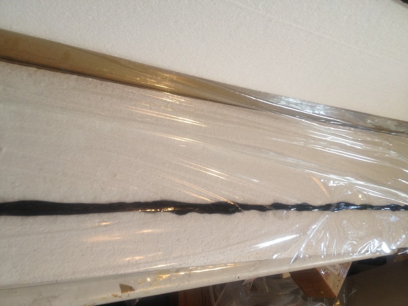

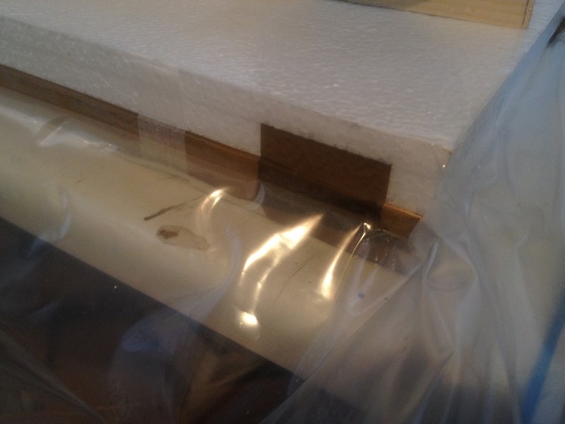

Ok, finally some decent temperatures in the garage last week!
Time to do some resin!

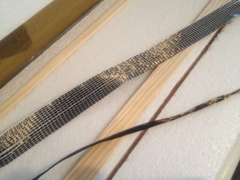

Finally my spars are done in the wings. 5mm vertical spar carbone tape wrapped, plus the gap filled with carbone tow the entire lenght of the wing.
I always put some cling film on top of the work, just in case  :roll:
And everything is bagged
Cook for 24 hours, and I now have a very strong set of wings!
They are the interior panels of the wings. Another 2.5m is missing to get the 6,5 metres  :D  I'll try to have the external panels done this week end.
So next : Wing joiner box to be glued at the root on the spar, wing joiner box at the tips, and time to do the sheeting. I will do eveything in one operation, just need the temperatures to go up again now!  :!:

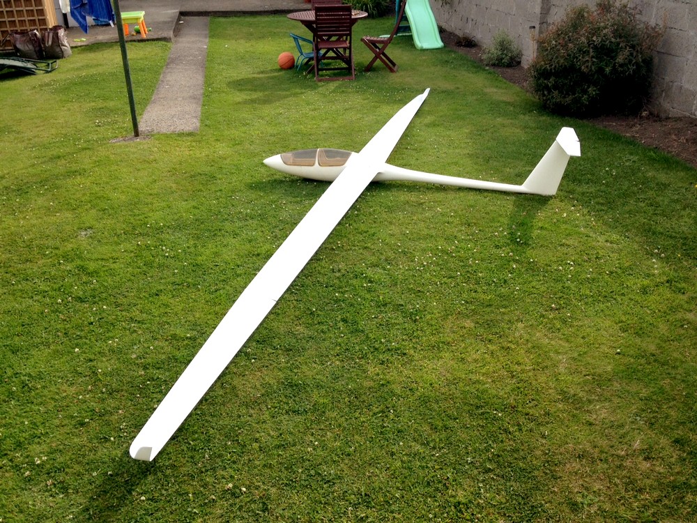

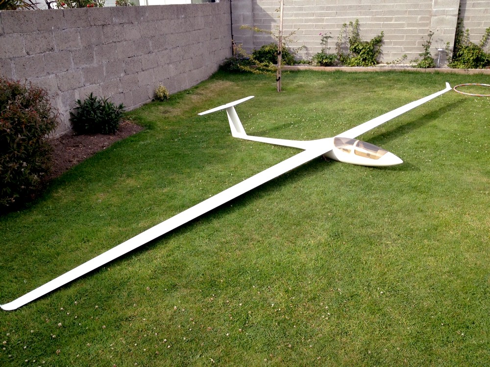

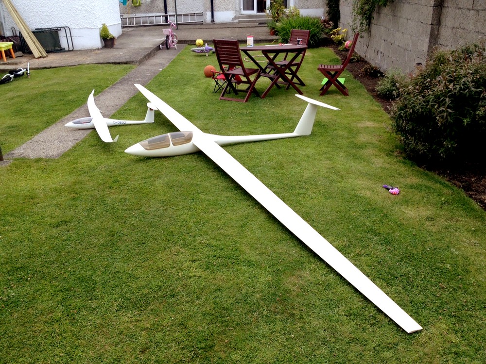

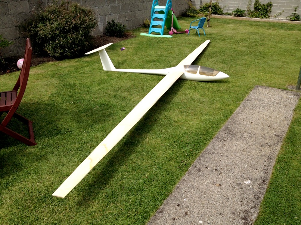

« Reply #25 on: August 10, 2015, 20:17:19 PM »
Moving on the ASH!
Getting there :)
Only modification so far to the original plan, is that I added Winglets. Prettier this way I think :)
They are modified ones from Topp-Rippin.
Anyway, if all goes well, should be ready to fly this week end.
Left to do: Rudder, tow hook, CofG
Keeping an eye on a good day for a first flight in Mount Leinster now. W or NE please! Need room for landing :)
