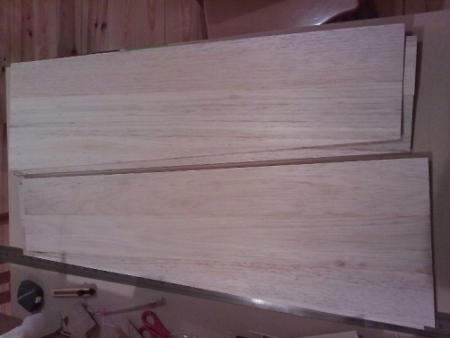

Off to the wings and a task I was dreading, described in the manual as "truing the edges" of all balsa sheeting parts. I got a nice hardened steel ruler from Homebase and gripped to the table on one end, held the other to shave all irregularities. I did something wrong or I simply have too idealistic views of the extent to which natural materials can be finished. But when gluing the sheeting together, I found there was a bit of warping. When the five pieces were glued along, the resulting skin was not flat, but raised above the worktop one or two mm here and there.
Gluing was also interesting. I used thin CA, with waxed paper underneath, but still had to pull stuck paper stretches a few times. No damage though.
Below are my finished wing skins, not exactly flat as you can see.

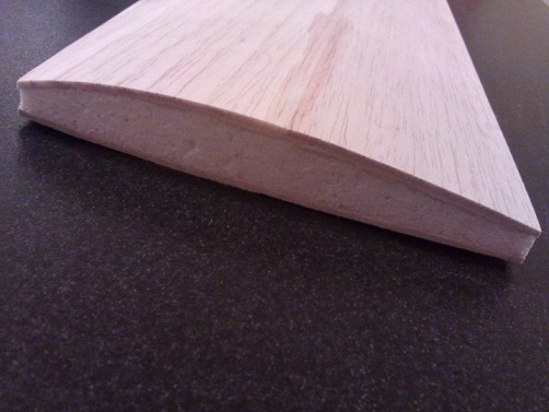

PU glue (I found Gorilla glue in Homebase), spread thin with a plastic card, bit of moisture in the air and to the press for 24 hours. Average humidity while gluing and curing was 65%.
With the exception of a couple of tiny spots where I spilled glue on the outside of the skin and had to sand a bit of mould foam, things went ok. Trimming the skins down to the core was scary (done by hand with blade, the planes I have seen look too heavy for the job) but it's done. Sanding was done handling the wing over worktop covered with 200 grit paper. Tricky - I wonder if there is a better way.

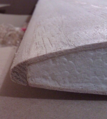

Yes, the pace is a bit slow. Having done my wings I think perhaps he was using too much glue. That thing expands and will find its way out through every possible opening! Gluing the leading and trailing edges I used PU too, and where it found its way out, shaping and sanding was not easy!
Here's my LE done:
Ninja
« Reply #22 on: December 17, 2012, 05:07:05 AM »
Yea, nice profile, looking very good. :clap:
