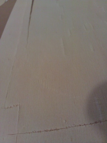

Here's the first one. Plywood parts came in two ways, laser cut and die cut (probably a sign of its age, it's an old kit indeed, Alan, although still available - got it new from SMC). So many of the die cut pieces didn't want to come out without a (damaging) fight. I turned problematic pieces around and kind of guessed where the cut would be, cut with the blade, and eventually managed to get everything out without splinters. But is there a better way? Other than buying laser cut kit  :)

Yea, die cut part can be a problem. :!:  I’m just finishing a SIG model myself Antonio, and I had exactly the same problems as you.
I used a model knife to cut through from both sides any of the parts that would not press out.

Very sharp blade and gradual scoring of the parts will see you through. As soon as you can see where the cut is, do it from the other side. Main point is to keep the blade sharp and go gently

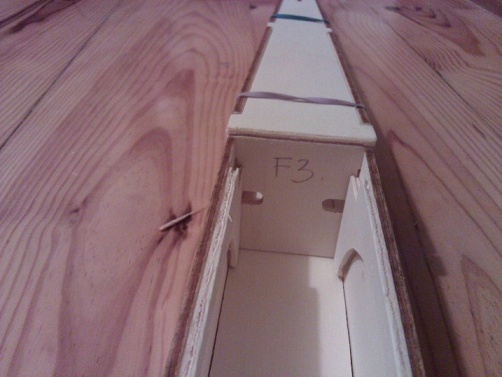

Started with the fuse. The laser cut parts with their nice straight edges made alignment quite easy. Everything held with rubber bands until perfectly (ha!  :o ) straight, then glued. Dilemma: thin or thick CA? I ended up using both in a bit of a random way. Any difference in strength?
F3 is the star of the pic and also of many Ninja comments out there: apparently the fuse's weak point is around F3. I'll reinforce later.

That would be the Riser, Keith? Yep, SIG don't like printing part numbers. With the Ninja, only the laser cut pieces (outer fuse pieces) were printed. Rest is guesswork.
OK, so I see there is no magic trick to handling partially cut ply. Straight lines were OK, but the blade doesn't like curves!

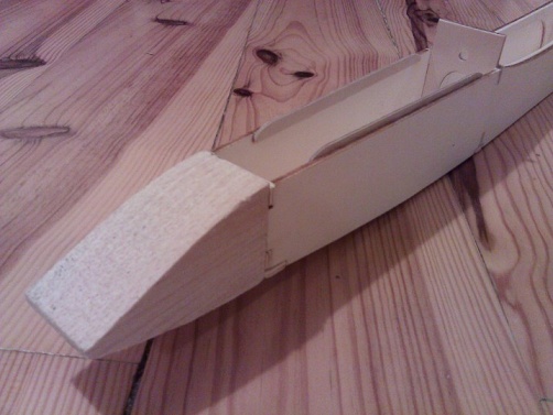

Here's the fuse with nose block and canopy guides glued.

Yes Antonio, it is the Riser I’m building. :)
 I found that the formers were slightly wider than the width of the top and bottom ply fuse sections. So to ensure a good fit I had to sand the sides of the formers down by about 1 - 1.5mm.
The construction of your Ninja looks just the same as my Riser except  I had to shape the nose block myself. Grrrrr. :evil:

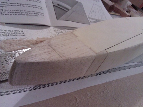

Speaking of sanding, the fuse taking shape. The nose block came a tiny bit short, maybe half a mm, so I glued it flush on the left, then glued a small balsa bit on the right and sanded over to shape. Perhaps a consequence of what you said earlier Keith about the formers coming a bit overgrown!
I have seen pictures of Ninjas where the nose was sanded down to an almost round shape, very pointy. I am thinking I should leave this one more square-looking, in line with the fuse. Any pros or cons about either approach?

« Reply #14 on: December 15, 2012, 12:14:00 PM »
If you look at most models the nose is rounded. I would go that route.
