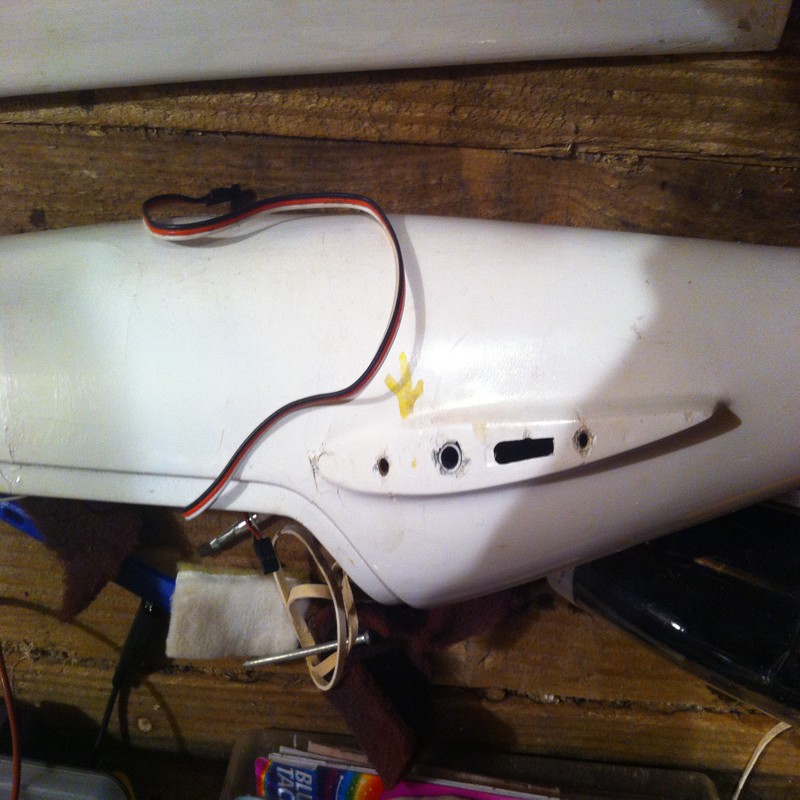

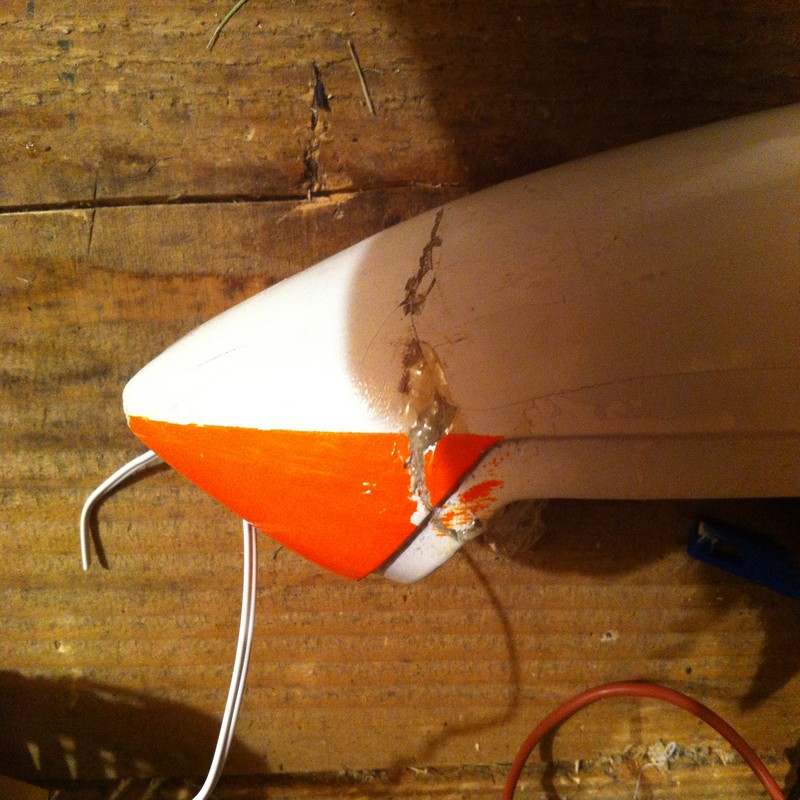

Hi All,
I'm looking for a some help with the repair of a DG1000, it's in need of some attention. So the main help I need is
 repair of the fuse
It's got some cracks and it needs a paint job, so firstly, so how does one go about filling, repairing and painting a glass fibre fuse?

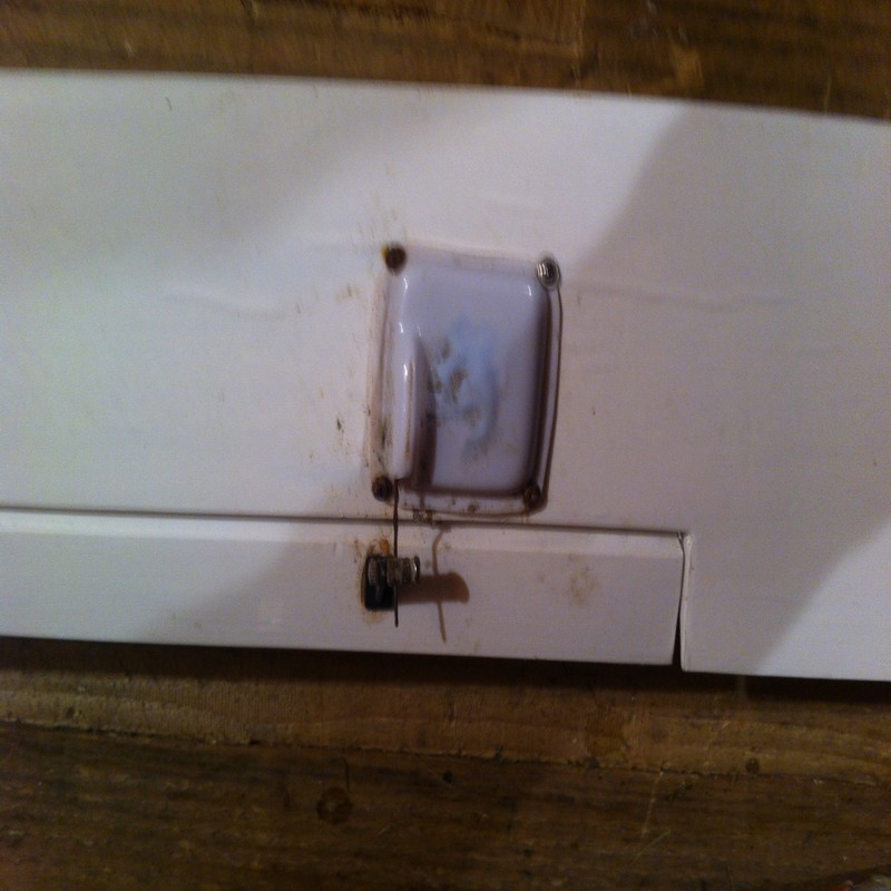

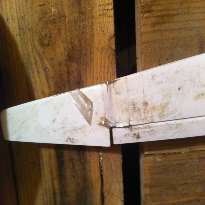

Repair of the wings
The wings are made of plywood ribs with balsa covering, the balsa is painted and covered with what I think may be oracover but I'm not sure, the plastic cover is coming away from the wings and the paint is lifting. So I want to strip the wings back and re-cover but I'm not sure how to go about this.
Any help welcome

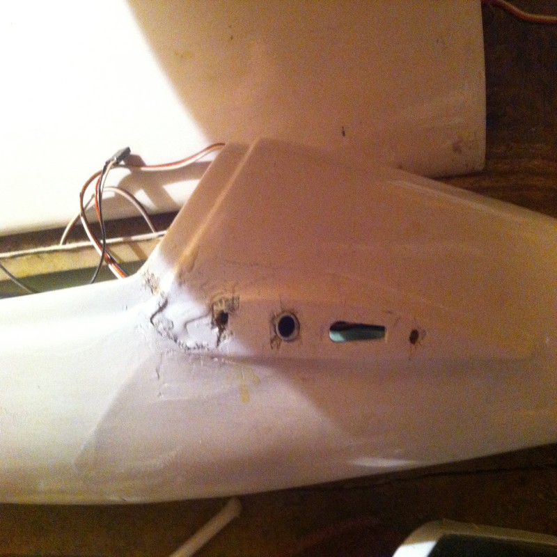

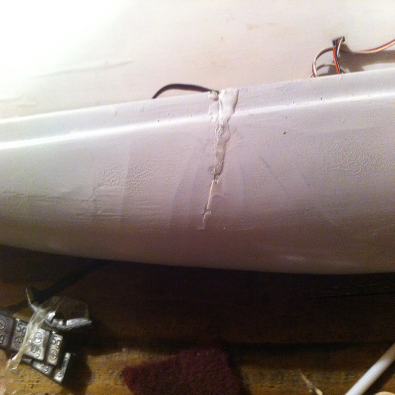

Er,........A picture paints a thousand words or so they say :wink:

« Reply #3 on: May 03, 2013, 16:27:19 PM »
Repairing dg1000
« Reply #4 on: May 03, 2013, 16:48:05 PM »
They look very much like the “repairs” on lots of my fibre glass models!  :oops:  :oops:
 I don’t really have a clue how to improve them. :(
Let’s see what some of the experts on this forum have to say. :?:
Repairing dg1000
« Reply #5 on: May 04, 2013, 15:20:09 PM »

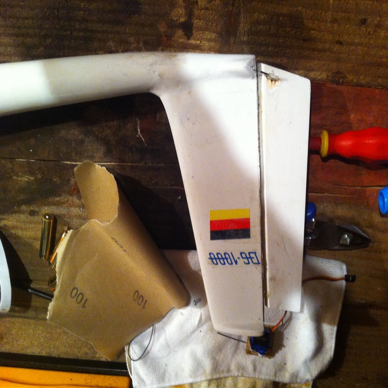

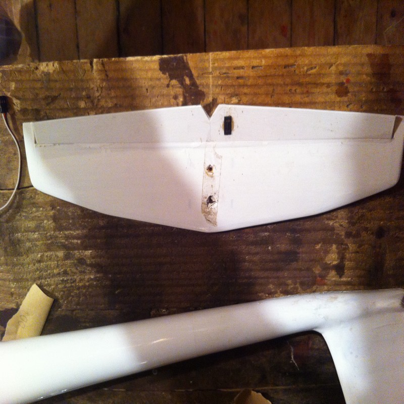

Stephen on the fuselage I normally use thin cyano where the crack is then fill it with micro balloons and it's easy sanded down to a smooth finish. If the break was big enough I would strengthen it up with some fibre glass matt or carbon tow in the inside. Strip the wings down completely and recover and if need be you can always make a new tail plane, don't use epoxy as a filler it's a b*****d to sand
Rub the fuselage with some fine wet and dry and then spray it and it'll be as good as new  :D

Isopon are now doing a new filler called "Easy Sand". To quote a different ad, it does exactly what it says on the tin!!

Thanks lads I've started cleaning it down this weekend, it's coming up well, the big question is the wings, I'm not sure weather to paint them and then use a lacquer to finish or to go with oracover? Any thoughts?
