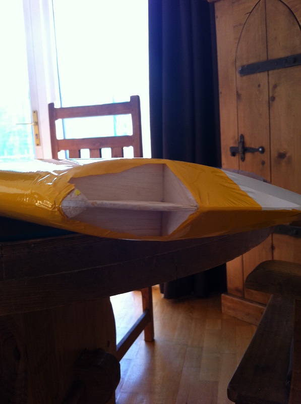

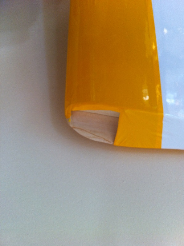

« Reply #3 on: April 25, 2014, 09:41:35 AM »
Thanks for the response on this lads. The photo's enclosed show the curve. Its very extreme really I'd imagine its just my technique.
Let me know your thoughts.

« Reply #4 on: April 25, 2014, 10:11:50 AM »
Put a nav light. Problem solved  :P  :P
Not a big compounded curve. Go slow, heat the corner of the wood first in following the curve and that should do it fine :)

good man stephen the photo really helps  :D
i would tend to do those bits first and use a separate piece of covering  and it's very hard to get perfect
i'm sitting here trying to put into words the way i'd do it
i'd cut the piece of covering over size and tack the covering to the edge of the wing and then with the heat iron on the covering pull down over the tip now if you start to get a wrinkle take the covering  back off the wing and pull it back again with the heat on the film and what ever small wrinkles thats left take out with the heat iron and then trim the excess film off
does that make since lol i could probably show you better than i can explain it  :D
