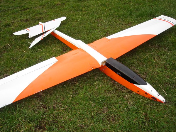

I soldered the elevator arm............she flew fine for a few days ......but today, in front of a new gliding friend I made at the west slope.......the Phase refused to pull out of a dive and went nose first  into the valley floor! :cry:  :cry:  :cry:

From here, seems relatively easy to repair  :?:
ARTF ? why ? They are no stronger than anything else ! And you can't say "I did it myself !"  :P  :D  Fly the Skua for a little while, the time to repair that one  :D

A number of servos have sheared, but they can be replaced, and the rudder/fin can be repaired.
My biggest problem, as I see it, is repairing the wing. the photo doesn't show the full extent of the damage. There is a dent and hole in the leading edge which extends back about 30mm. The wing is distorted behind  the dent where the material was pushed back by the impact. (i.e. the cross section is thicker behind the dent in the wing.) The wing is made of ply over polystyrene.
When she flys she's a really nice plane, so may be I'll leave her alone for a while and come back to her.
How should I tackle the repair of the wing? Polyfiller :shock:

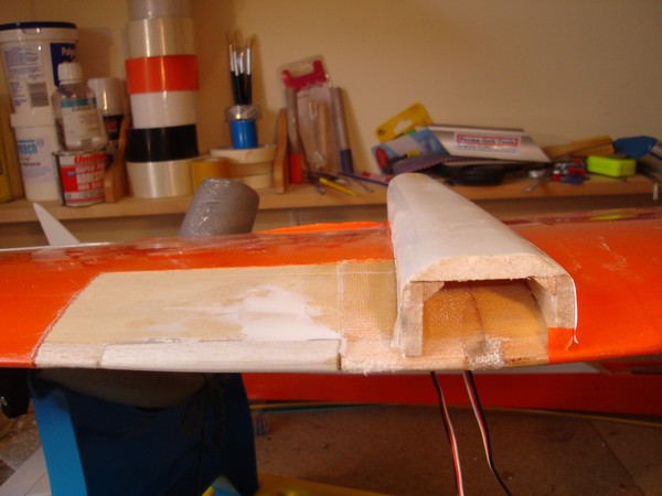

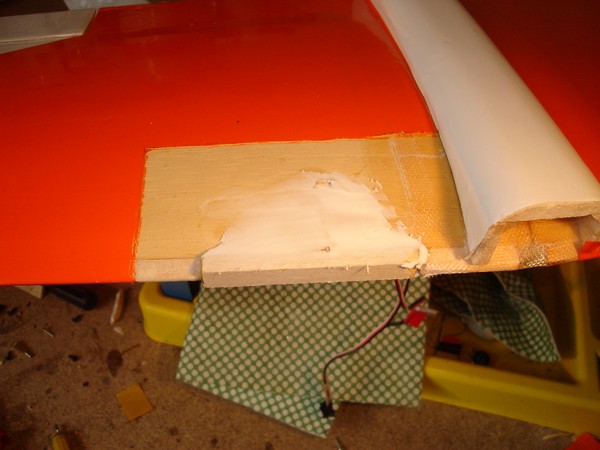

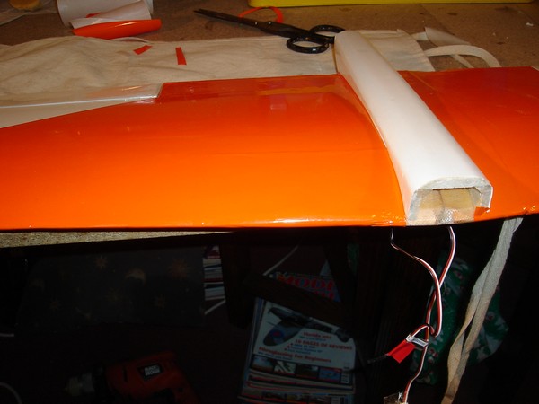

They say a week is a long time in politics, it's even longer when you're a sloper without a plane! So I've repaired/ modified the Phase 6. I've even fixed the wing! I thought, "If Brian says it's fixable, it must be!" So I did.
I pressed the wing back into shape before filling the hole and bonding it together with a paste of epoxy and micro balloons. Fixed a new piece of LE and used light filler to fill in the remaining dents.
Then sanded it down to shape
And re-covered the repair.
Good as new! (Well, almost)

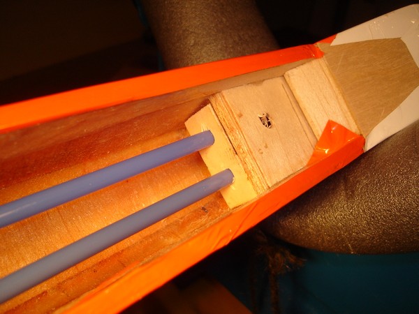

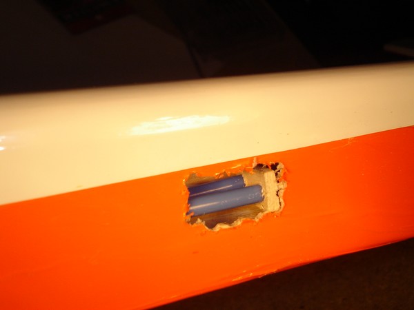

I through out the original controll rod and closed loop ruder controlls in favour of Sullivan plastic controll rods. Had to cut an access hole in the side of the fuse to fit a mid fusalarge support for the rods. (To stop them flexing during operation)
And I added another support for the rods in the wing saddle area.

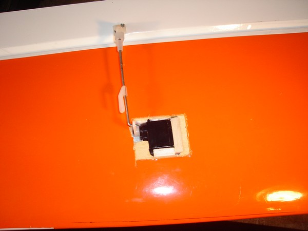

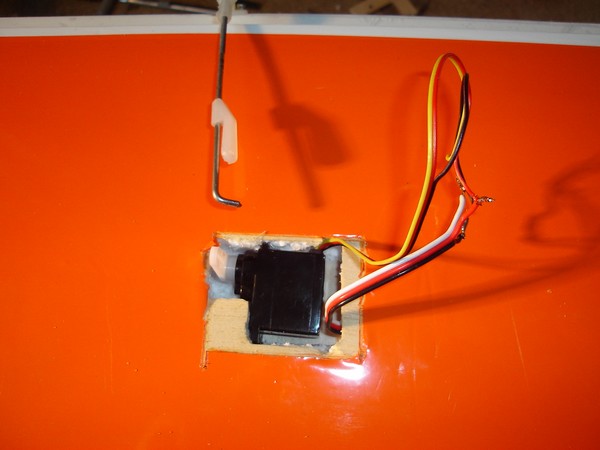

Finally I had to replace the aileron servos. I chose metal geared ones this time. They were a bit smaller than the previous ones.
So a few pieces of packing made them fit snugly into the wing, with double sided tape to hold them in place.
